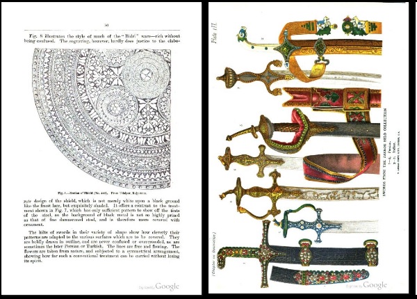

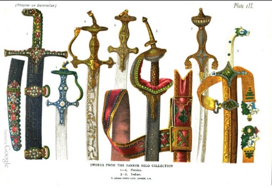

Egerton not only knew the Russian edition, which is mentioned in the book I wrote about. He used fragments of illustrations from the Russian edition as a color insert for his book, published in 1880. He himself writes that the swords are from Zarskoye Selo (this is how I found out the vicinity of St. Petersburg, Russia)
https://archive.org/details/indian-a...b?view=theater
