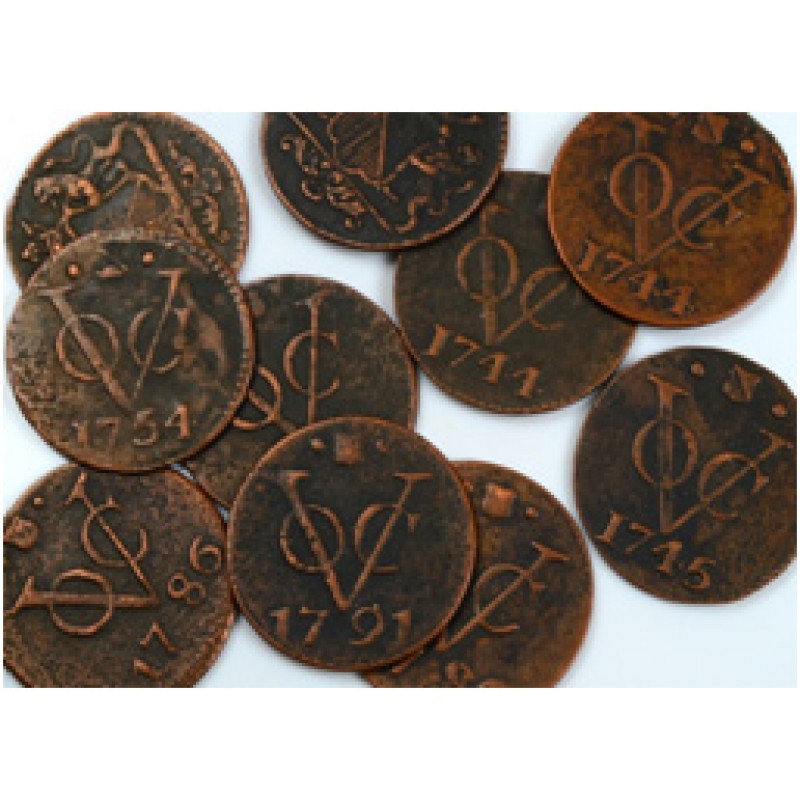

Indeed, but that doesn't mean they stopped producing blades... The decline didn't happen overnight but spun over many decades.
Moreover, while less successful than in the past, VOC survived until 1799 and even continued to mint their own coins throughout much of the 18th century.

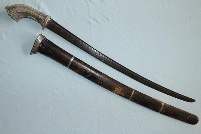

I'd welcome better images of the Kastane blade to be sure, however, from afar, it looks correct.
The right blade looks like the blade from one of my old Gobang listings.
I think I took the crop from the photo of your blade.

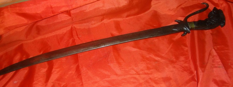

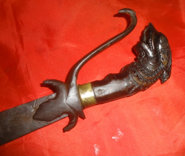

Hello Marius,
A very nice high end kastane! Congrats! Attached pictures of a much more simple one sold recently on a German site.

Hello Marius,
This kastane appears to be in the same style and of similar age, if not earlier, to mine: second half of 18th century.
Very rare find.
