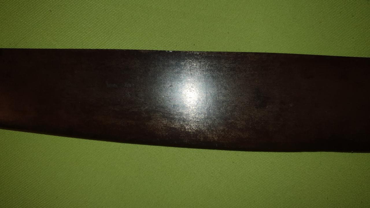

It depends on the used varnish. You can try benzine (for lighters) which works well with shellac for example, acetone works by other varnish, by others turpentine. With all three liquids you can't harm the blade. By wood or other natural materials you have to try it carefully on a not visible place.
I have done it many times, don't be afraid to harm the blade.
What you do mean by patina? Dirt and rust is not patina. But some blades get over time a black surface, strictly speaking also rust, don't be removed by a cleaning like this, it will become a little bit more shiny maybe because you have washed away dirt and loose rust but it will stay black, I guess that you mean this by patina.
Attached a close-up from a blade with such a black surface and was cleaned once from a varnish.

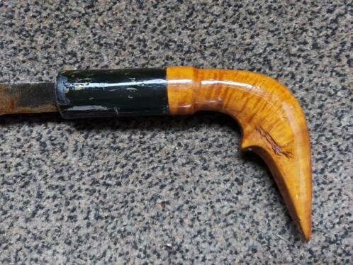

I have a kabeala that has been varnished in its entirety, including the blade and the wood(?) of the hilt and scabbard, rattan bindings and all. It wasn't expensive, but nevertheless, what can happen to the wood with this way of cleaning, worst case scenario?

Try it carefully with one of the liquids at a not visible place, I've done it before without harming the material. When you have removed the varnish, polish it with oil, I use linseed oil and polish it with a soft cloth, normally it works without any harm to the material.

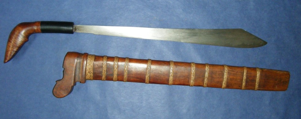

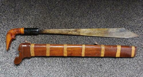

You're welcome! BTW, it's a nice Kabeala, nice grain to the wooden handle. Attached is my own, similar example.

Ah, that is almost identical! Do you have any more information on it by any chance (age, etc)?

Kabealas are still in use on Sumba so you can find quiet recent/vintage examples in nearly identical appearance. I get my one from a friend in GB, judging by the wear and patination I guess around WWII or short before.
It was shown before in this thread: http://www.vikingsword.com/vb/showth...hlight=kabeala

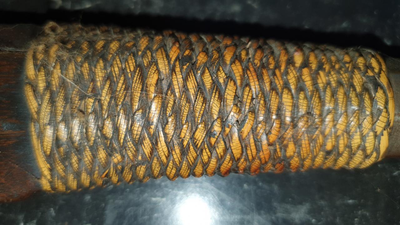

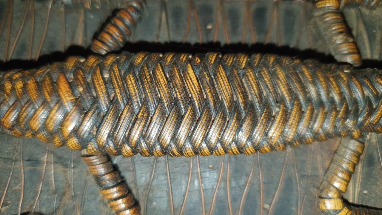

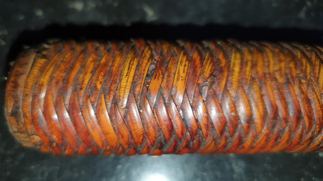

A very good indicator of good age are always the small cracks in rotan bindings,
see the attached pictures from some of my items, just use a good magnifying glass!

Interesting. Would varnish protect against such cracks, or do they still form regardless?
FWIW I don't expect my kabeala to be particularly old. Does the presence of varnish itself say anything about the likely (minimum) age range, or people still do that today?
I think that those cracks are already present when someone will coat an item. They come from age and handling.
I would place your example carefully as mid. to end 20th century, judging by the color of the wood but keep in mind that light/flash can cozen.
People coming to the most crazy ideas, I've seen shellac coated items (most of the time early collected items, to varnish with shellac was popular from end 19th to first quarter 20th century), here works benzine, this items were most of the times good preserved), chromed blades (a real horror ), many elbow grease required, items coated with clear modern varnish (every time difficult to find the good solution), the most annoying is when people "cleaned" a blade with a grinder or something else. Disgusting is a blade coated with centuries old grease.
