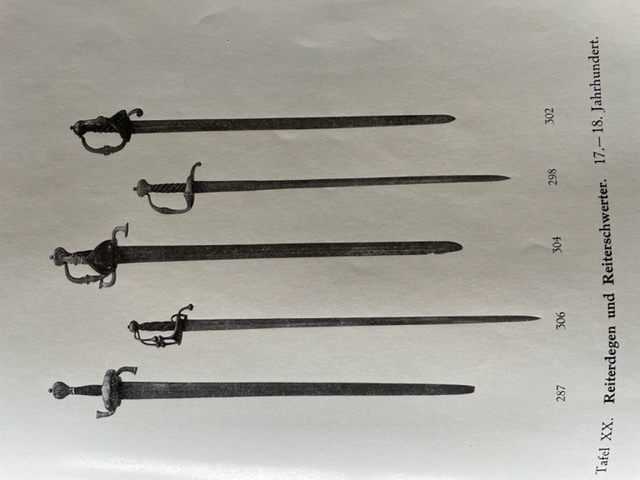

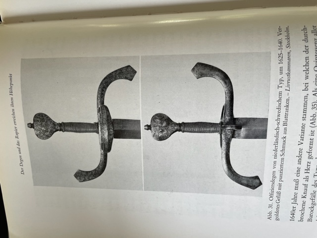

herewith my "alternative" view
it is not a sinclair sabre but a cavalry fighting sword ( reitersabel) of the Dutch-Swedish type. 1630-1660
cf the visser collection part 3 JP Puype Cat 547, schwerter und Dolche / Wegeli nr 287, SeitzII p40

While more of a superficial observation, Im inclined to agree on the cavalry sword classification simply from my personal view of so called 'sinclair saber' category being shorter with stout heavy blades. While cavalry swords of the 17th century seemed to have predominant straight blades, the evolving 'light cavalry' of course were inclined to use saber blades.
The hilt style seems a 'sinclair' saber criteria, with Oakesott adding a secondary option with open hilt and lighter blade.
It seems to be a matter of personal view, while many in discussing arms choose to use Oakshott classifications for standardization in discussion.
I think I'd call it as Jasper has, to me Sinclairs are heavier with basket hilts and more in the dusagge group.

re: visser collection
it is part 3 but not really a swords book, focused on dutch 17th and 18th century weapons such as smallswords, hunting hangers, walloon swords etc.
re: Oakeshott
I think Oakeshoot meant the same, a Dutch Swedish broadsword from around 1650 but probably by some similarity in the form of the quillons , naming the type sinclair 2.0
