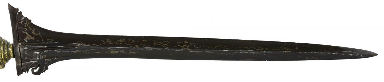

Would love your expertise in identifying this Keris..
  • Is this Balinese or Lombok ..or perhaps from somewhere else?
  • Any estimation on how old this Keris is? I can never tell if a Keris is a genuine sepuh or artificially aged.
  • Could you recognize the pamor?

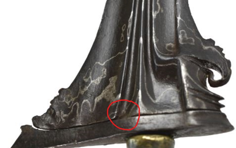

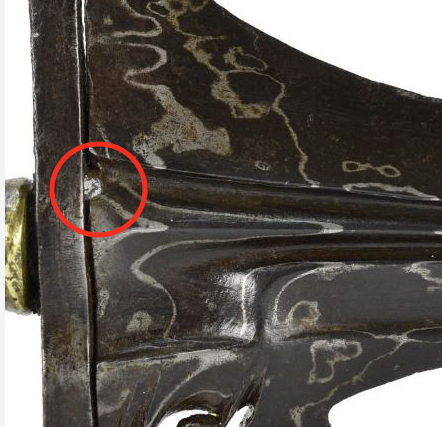

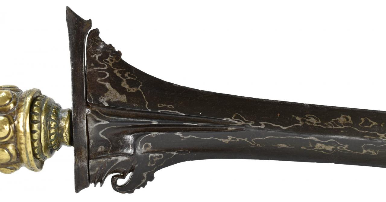

  • The ganja on the greneng side seems to be separated. Is this normal or an indication of mismatched between ganja dan wilah?
Thanks in advance!

No doubt some of the more expert forum dwellers will have a different take, but to me seems to be a Balinese kris.
I have been told by many that even very well known expert experts find them difficult to tell apart and that one expert may say one thing while another may say the opposite.
The quality appears to me to go under the better kerisses and perhaps I could venture into saying that this could be a Kulit Semangka pamor.
Several people whom “ wash” krisses with warangan ( I have met 3 until now very well known in the Dutch kris community) told me that having a loose ganja is not unusual and that, in fact, it may indicate that the kris has been washes a number of times therefore, old but that too, as everything else may be faked (although I doubt that it is in this case)
This can be restored.

Would agree, an old Bali or Lombok blade.

It is a Bali style blade, but whether from main island Bali, or from Lombok island colony, it is virtually impossible to know with any certainty.
This doubt persists even when a blade is in the hand. There are some indicators that might make one lean towards either Bali or Lombok, but we cannot ever be certain. With this keris I lean to Lombok, but I would never debate it.
No real opinion on age, but 19th century would be a safe guess.
Pamor is wos wutah (& all related variations of the same words)
The imperfect gonjo fit could have been there since the blade was made, or it might have been knocked out of its original position, the blade does not look old enough for erosion to have caused the gap.

Is this a pin? Or am I seeing things?

Looks closer to silver solder in that picture. The other pictures don't show the shiny spot.

Reflected light?

@milandro & @A. G. Maisey - Thank you for your input! The pamor looks like spots of smokes going up. It may be just me, but the pattern looks sparse compared to typical Kulit Semangka or Wos Wutah outthere.
@jagabuwana - Great eye! I didn't realize it. My suspicion was mostly on gap of the ganja. It looks like a spot weld and only on one side ..odd.

The pamor is typical Bali, it is sparse, Balinese blades that use these random patterns are seldom as dense as Jawa blades.
A spot weld would be extremely unusual, are you able to do a good close up?
I've run this image through PS but I cannot get a good enough image to determine anything.

Hello all, this is a keris of mine. I checked the ganja and the shiny part which looked like a weld was in fact a drop of oil mixed with dirt after I cleaned it, it got stuck when I took it to my photo studio,it is removed now. The blade dates from the 19th century and is original and believed to be Balinese. The hilt is a later addition, which is tight so I am unfortunately not able to show the peksi.
