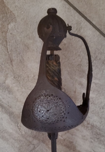

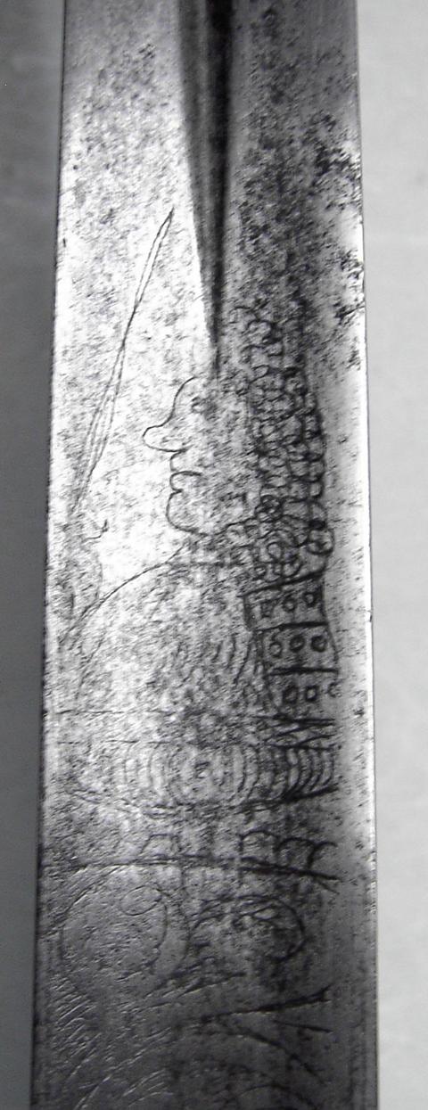

I have what I think is a "mortuary sword" in my collection with a portrait at its blade. I have no idea for which purpose this sword has been made. Length is 880 mm, blade 725 mm, width 30 mm. The former owner told me that it could have been made for the funeral of king Louis XV.
Old 8th January 2022, 08:25 PM   #6
Posts: 10,862
Udo, very interesting example of what was deemed a 'mourning sword' in the 18th c. These are discussed briefly in "The Smallsword in England" (J.Aylward, 1945, p.54-55), noting these arose probably c. 1740 and with blackened steel and grip wire. While the thought was for mourning of funerary purpose, Aylward suggests they were worn with any somber dress, and were essentially a town weapon.
I do not know much on Louis XV (d. 1774), but it seems feasible this could have been such a sword with the interesting likeness on the blade. I would also note the rebated point on the blade, which would seem to render the blade inert for thrusting as would be sharply pointed on regular small swords.
While this digresses from the figurative term for the 'mortuary' hilts, I wanted to add this to the theme. It is what is termed a 'corpse carriers' sword from East Europe, believed Austria, 19th c. and worn by pall bearers in the funerary process. Frankly this is a pretty obscure form and I would have to dig a bit to find the reference in which it is noted.
Returning to the 'mortuary' hilt, I went through " The Rapier and Smallsword 1400-1820" by the late AVB Norman (1980), where the hilt form and its variants are discussed in various entries. He suggests, based on examples and some portraiture that the form likely did not exist prior to 1630s.
Unfortunately, as often the case, no mention of the origin of the term 'mortuary' is noted, though it is used in at least 7 references in the text.
Still curious about the play mentioned in which the term 'mortuary' was used for presumably one of these type swords.

Many thanks Jim for your answer and interesting contribution. I checked the type of my sword with help of the book of A.V.B. Norman and found the pommel of my sword on page 243 as "pommel 14", dated to the third quater of the 17th century. This dating would very well fit to the portrait on the blade of a uniform bearer with allonge wig. This type of wig certainly was out of fashion at the time of the funeral of the French king Louis XV. in 1774. The equivalent hilt is shown on page 199, drawing 112 dated from the 1640s or even earlier. As Norman writes "their presence in many English country houses, armouries, and some churches as well as the similarity of their decoration to that found on what collectors call "mortuary swords" which appear to be exclusively English, suggest their country of origin".
Old 9th January 2022, 05:12 PM   #8
Posts: 10,862
Very well noted Udo. With small swords, as we are aware, while they were around through 17th c. with their use extending through the 18th, but by the time of the funeral of Louis XV their character had changed.
Note the full pas d'ane rings, by 1770s these had become more vestigial and flatter, virtually eliminating the original purpose. The blade on this seems of early form but the rebated blade tip is curious.
With blade engravings of course, they are most often commemorative with these kinds of figures such as the wigged head. I think of the hussar figures with panoplies of arms etc. are just a popular theme on many saber blades. Many of these (as well as on plug bayonets) have the 'viva pandour' phrase.
In Norman's quote (as cited) he is referring to the range of variations of the so called mortuary hilts we are discussing, which of course are unrelated to these 'mourning' small swords' , and reiterating that they were in fact used by both sides in the English Civil wars and related campaigns.
Your comparison in well placed however in noting the somber tone in the sobriquets of these swords

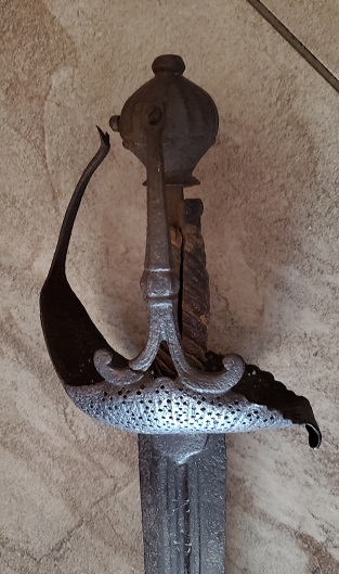

Apologies for resurrecting this after such a long gap, but is there any evidence that there were two side guards on this? I can't see a screw hole on the pommel or signs of the recurved bars sitting on the inner side of the guard. To me that one, with its very fine boat shape gives the impression of a kind of evolution from the AVB Norman Type 91 hilts.
