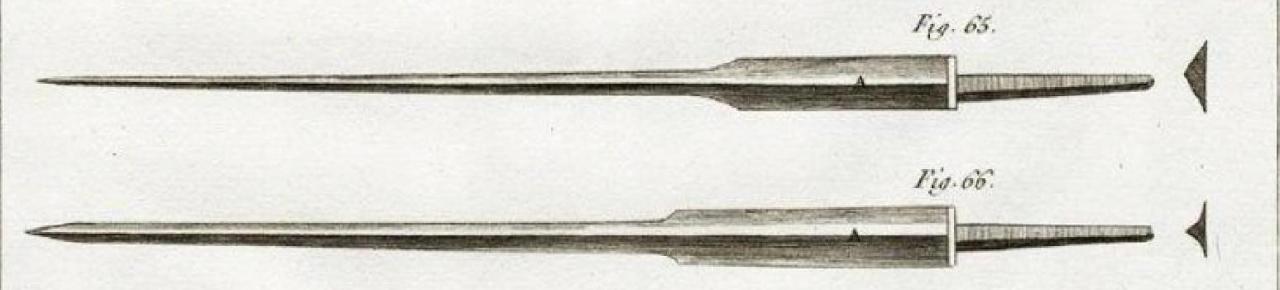

BTW: an interesting idea (and more than plausible) was that those flat blade colichemardes were simply cut down broadswords. I really do want one of those!
Old 30th December 2021, 02:23 PM   #15
urbanspaceman
Join Date: Sep 2017
Posts: 736
Default flat blade colichemardes
Following on from my last sentence regarding the possibility/probability that flat blade colichemardes are modified broadswords I have to ask if anyone has any information regarding the time of arrival of this style of blade?
If the arrival of the smallsword had encouraged the learning of a new style of fighting, with an emphasis on the thrust, but the cost of the new hollow blades was (and it certainly was) discouraging, even prohibitive, then the conversion of a broadsword blade must have seemed like a good idea on more counts than merely financial.
I know that many were unconvinced by the efficacy of the smallsword due to its apparent delicacy when opposing a heavy battlefield blade - in particular the Scots - believing it to have little blocking and parrying ability; this reason has been suggested on more than one occasion as the justification for a 'squeezed' blade.
It suggests to me that the cut-down broadsword was the beginning of what would become the traditional hollow blade colichemarde.
Has anyone seen flat bladed colichemardes retaining a smith's marking and if so could they let me see them?
Curiously, Diderot does not show this style; and equally, does not show the style with the rolled lower groove that would eventually predominate. See attached for what is shown:
