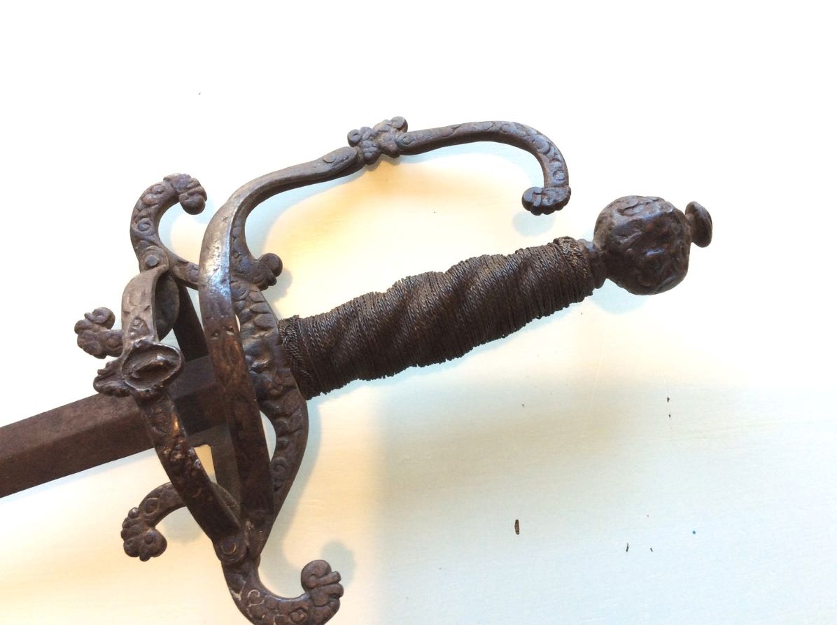

Hello. Looking for some thoughts on the age and country of origin on this rapier. Thank you.

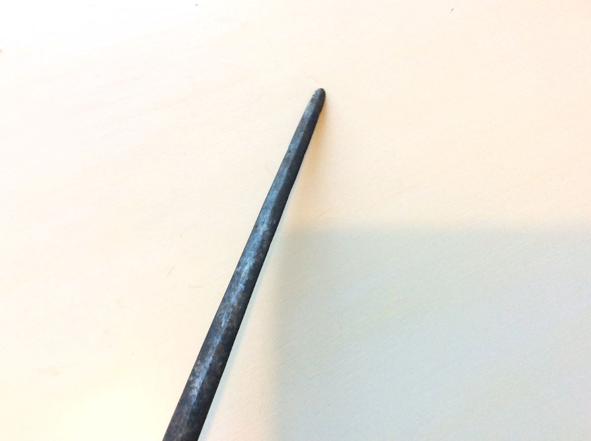

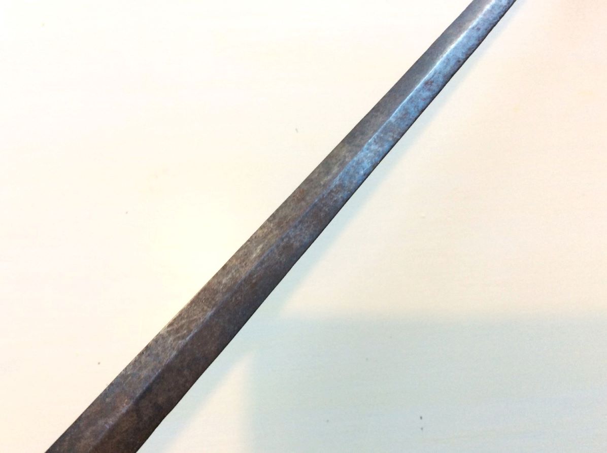

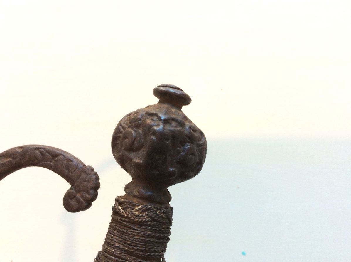

Here are some additional pictures to help form an opinion. Thanks.

thatīs a historism piece from the late 19th century or later.

Thank you AHorsa. I suspected as much but the details in the swept hilt was above average for Victorian period "historismus" example so thought it would be interesting to get some opinions. What time period is the sword based upon? 16th or 17th century?

The decor and mascarons are renaissance elements I would say which fit rather to the 16th than 17th c. But others might know more about the overall style of that piece, which is indeed a very decorative well made object.
