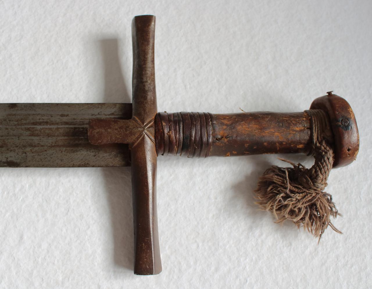

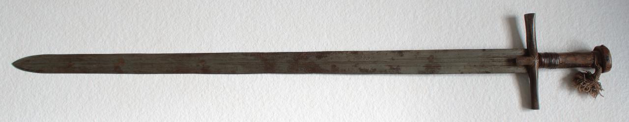

Good Afternoon All
Firstly I best introduce myself as its my first post. I am a collector of 1880's period British Military items specifically relating to the Battle of Maiwand, Afghanistan 1880 and The Battle of Tofrek, Sudan 1885. For some reason I have been drawn into Sudanese weapons and items from that period more and more and starting to collect in this area.
I have read some fantastic papers on the subject on this group and hopefully can ask those knowledgeable in this area for their wisdom and thoughts.
This kaskara is the one I'm mainly concerned about its age after reading the articles. I have attached photos but the blade is 34inch long, pretty flexible and marked with the crescent moons on both sides.
If anyone can give me any pointers to what I should look for fin 19th Century Kaskaras that be great but I have a hunch this isn't one.
Look forward to your comments
Jack

Welcome to the forum Jack,
Edster is the forum member who has done extensive research on the subject, and you can find his threads with a simple search, as well as his papers here, under Africa:
http://vikingsword.com/ethsword/
He studied the manufacturing process of kaskaras in Kassala in the 1980s and therefore has a better perspective on dating these swords than pretty much anyone else here. I am sure that he will chime in when he sees the thread.
Looking at the pictures I agree with your assessment. The blade with its three fullers follows a popular pattern of trade blades manufactured in Europe and exported to Africa in the 19th century, but European made blades from that period tend to have straight and even fullers, while these are rougher, suggesting local blacksmith work. The crossguard also looks like it is a form, associated with the 20th century as a simplified version of earlier guards that were more complex to forge out of 6 different pieces. Taking all this into account, it becomes really hard to place this sword in the late 19th century.
That being said, I would not be totally disappointed with it, because it is a good representation of the form as used during the Mahdiyya. Kaskaras with old imported blades and high quality fittings are increasingly hard to find, and this can serve as a placeholder until you source one for your collection. If it is any consolation, it helps to keep in mind that the kaskara remained in use as a male attribute in the Sudan until modern times, so even a 20th century sword would still have been carried and used within the original cultural context, even if not as a primary weapon.

Jack,
Welcome to the Forum and to the land of Kaskara fans. I can only add a little to what Teodor has said. The good part I can add is your sword was made by a smith named Awad Adam as indicated by his maker's mark, sort of like the number 40 or "Arbane" in Arabic. Adam worked in the Suq al Haddad or blacksmith's market/work shop in Kassala. According to my field notes he was said to be active when I was there in 1984 and made 3-4 blades/day. Just guessing, but he likely had a career of at least 10-15 years so I'd estimate your sword was made in 1970s at the earliest. Your sword looks well used and was certainly an item of daily dress and armament in a period of social unrest in Eastern Sudan following the construction of irrigated agricultural projects that displaced considerable populations.
Ed

Thankyou so much for your replies and the information Teodor and Ed its massively appreciated as I definitely want to learn more about these fantastic swords and the only real source of information is this forum and the articles that Ed was kindly posted on his research. Its great that you've been able to identify the maker and even though its a 1980 sword rather than 1880 it has its own history and as said is a nice gap filler.
I do have a few other kaskaras to post up aswel as a couple of other sudanese items that I will post over the coming days/weeks.
Ian that kaskara you've bought is an absolute beauty. Love the ornate decorations and even more that its an NSW contingent bring back. I have strong links to the Berkshires as it was my home country regiment 7 ancestors who served with them and a distant relative who was killed at Maiwand with the 66th foot. Tofrek for me is a fascinating engagement in the fact it could have very easily been a slaughter like maiwand but was turned around by great officers, exceptional NCO's and the bravery of the men to stand their ground and not be routed like some of the Indian troops were.
My collection is mainly British but just something about sudanese weapons of the day I love.

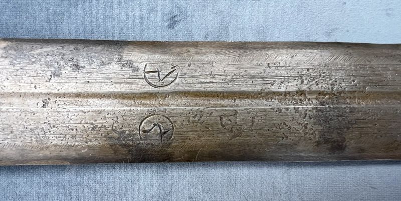

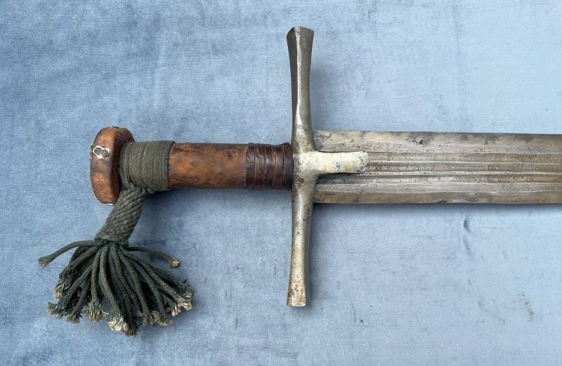

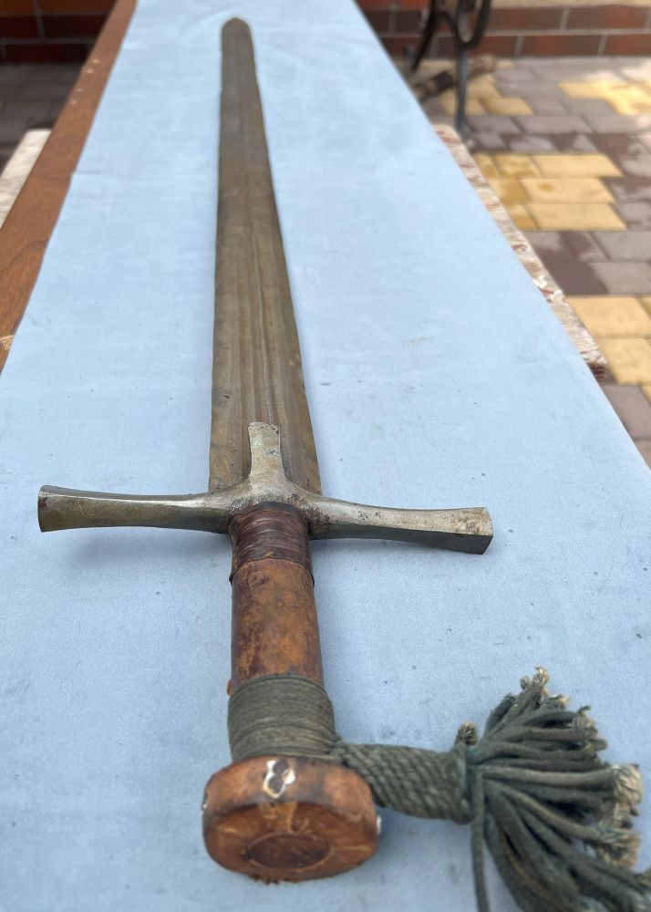

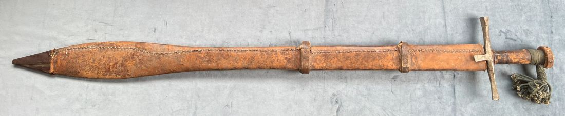

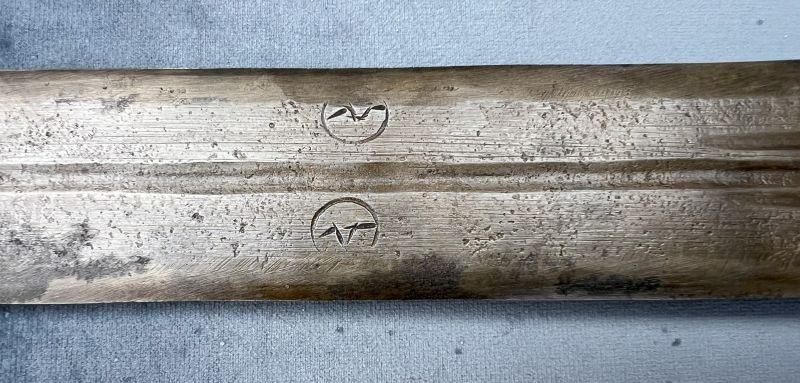

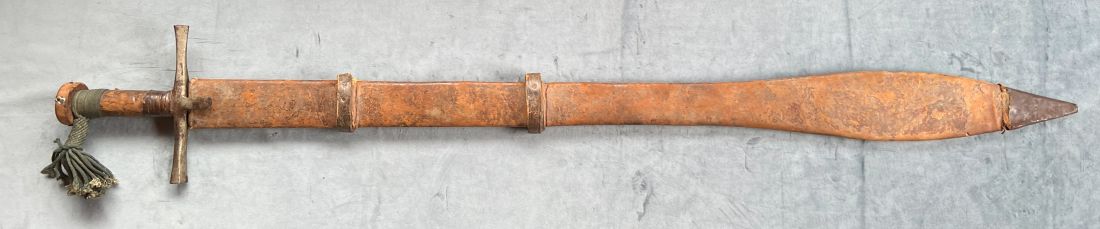

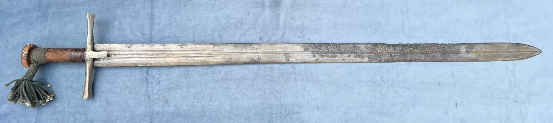

I received Kaskara, I did not create a new topic because I think it is also from Kassala. The blade is very badly corroded, I had to use chemicals to clean it. I will be glad if Edster joins in and gives more detailed information.
Overall length: 1025 mm, blade length: 900 mm, weight: 960 g
Yuri
Pertinax is offline   Reply With Quote

Yuri,
I agree with your Kassala attribution. I know nothing re the maker's mark. Note the Beja/Hadendawa tassel below the pommel.

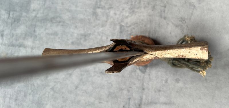

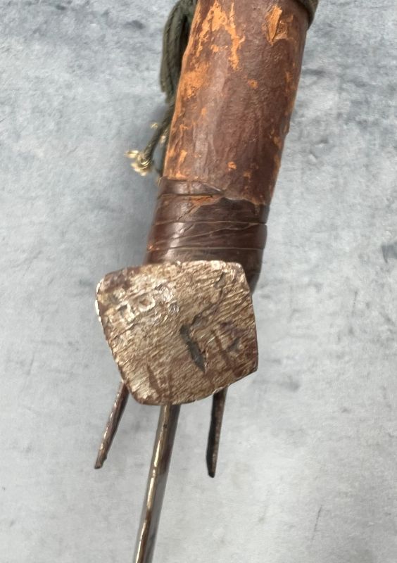

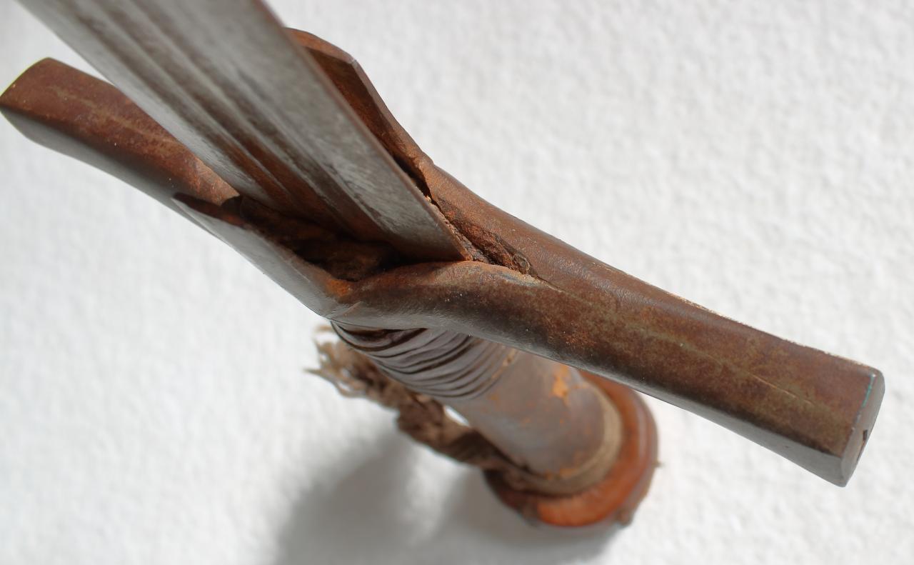

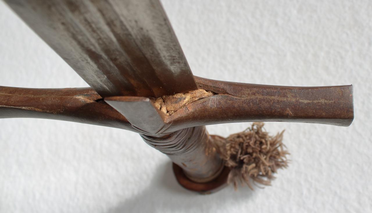

The cross guard shows what are likely incomplete forge welds on the bottom as well as the end of one of the cross pieces. Check to see if the bottom langets look to be bent to shape instead of welded in place. If the above are the case then the cross guard was bent to shape from a flat piece as I noted in the Cross Guard essay and was "invented" c. 1945 in Kassala. Thus, your kaskara took its current form post 1945. I collected one very much like it when I was there in the mid-80s. It's foto is in the essay and shows a noted incomplete cross guard forge weld.
Ed

Many thanks to Edster.
You are absolutely right, here is a photo of the crosspiece.
Respectfully,
Yuri

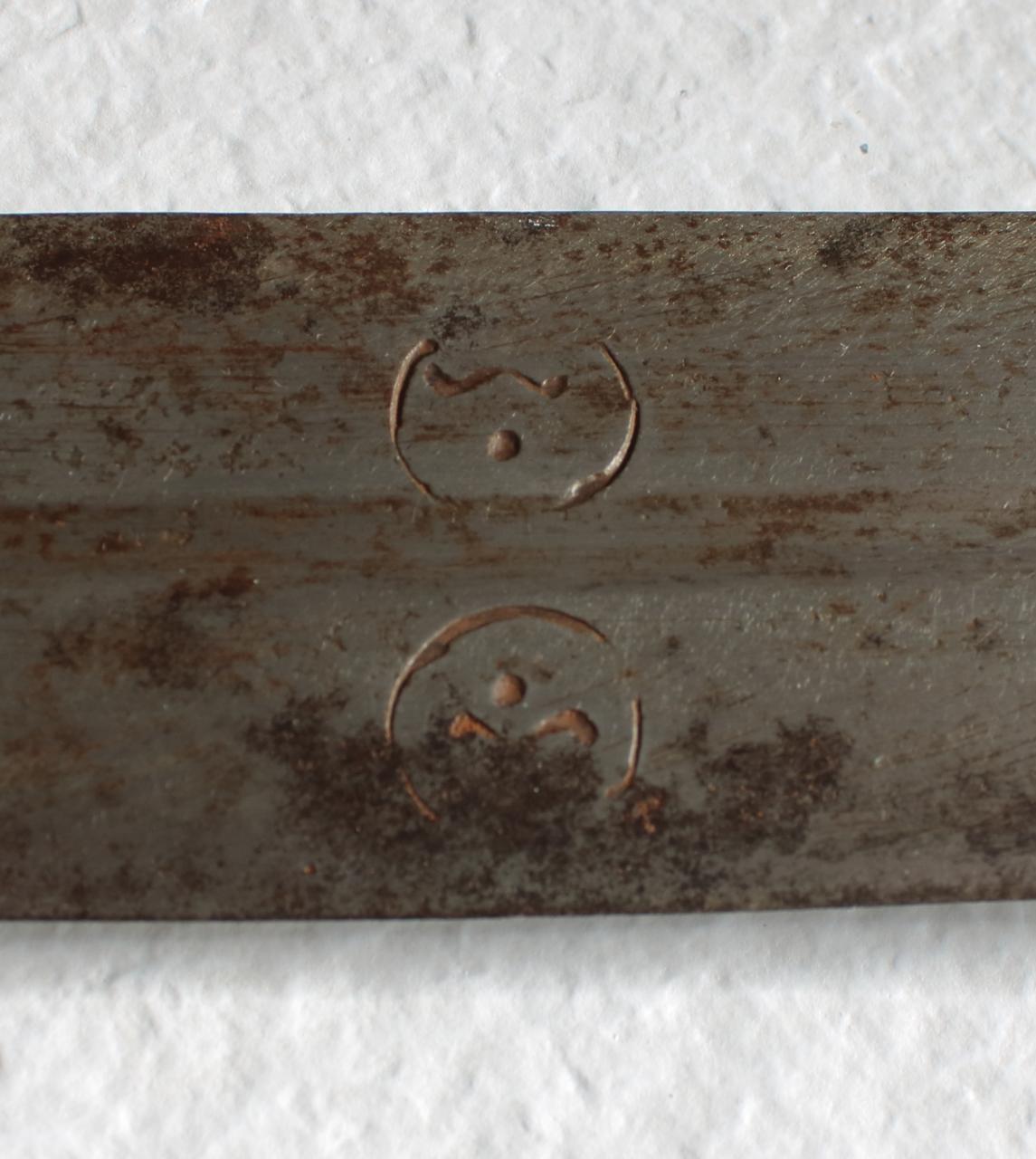

Interesting, my last kaskara, fairly standard, with a good blade, quite flexible and almost identical to the sword of the o.p. Based on the markings, it seems to me to be from the same smith and the same period. Thanks to Ed's research, the African craftsmen who often remain anonymous sometimes get a name and a face. Thanks also to Yuri, who has brought this old post back to life. I am posting this sword here for the same reason: it is not a particularly exceptional sword, but it is a silent witness, recently made in an age-old tradition, which is always fascinating.
Marc

Marc,
Thanks for posting another of Awad Adam's excellent swords. Note the tapered blade hand made entirely by eye and exact forge strikes. The quality appears as good or better than any munitions grade made in Solingen in the 19th C. This is why it's often difficult to tell between "local" and "imported" blades. I guess most Mahdiya Era swords were made with imported blades and those in the 20th C. were made with locally made blades. Also, the about 1960s or so the Kassala swords began to be exported country-wide so they were widely distributed. I'm sure that almost everyone outside of the bigger city was armed with a sword for protection and/or culture even to the 1980s when I was there.

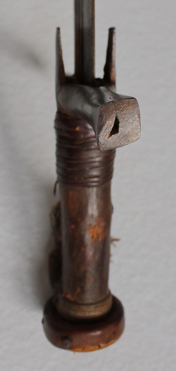

A question on the crossguards with the notable 'X' at the center junction. I had always thought these were 'Darfur' from Reed (1987). What are the particulars on this feature?
Also, was there a period post Mahdiyya (or before) when Solingen sent already forged guards to Sudanese areas?
All the best

I asked an informant in Kassala about the cross guard "X" and he just said it was preferred by some and not by others. It does add a fashion quality to the guard, but I know nothing about the origin. It could have been a stylistic addition in the Ali Dinar era.
Re imported cross guards, I found this reference:
1871. Frederic-Benoit Garnier wrote about imports through Suakin from Egypt. Andreas, in a 2014 EAA post, translates from the French that “among the goods were blades and cross guards of German manufacture. “ This is the first and only reference to imported German cross-guards. We don't know the material or design on the cross-guards, nor has any known examples emerged.
We recognize the cast brass guards on Ottoman/Mamluk sabers that were also usually seen on thaluthed blades. That type were readily casted in Egypt and could have been surplussed from captured Mamluk/Turkic weapons or cast in Omdurman during the Mahdiya. I believe that a pin was sometimes used to secure the Guard through a hole the blade's tang. I don't think that at least the Kassala smiths put a hole in their tangs; no need.
The kaskara is fitted together by wood from the grip wedged between the blade and the cross guard to. create a unitary assembly. The size of the space in the cross guard would be difficult to prescribe in a foreign made forged cross guard. So I doubt if imported would have been desired or used. Also note that imports from Egypt were halted in 1885 due to the Hicks Event, and the British controlled Suakin port throughout virtually the same period. Any smuggling would be for higher value goods rather than cross guards.
Ed
