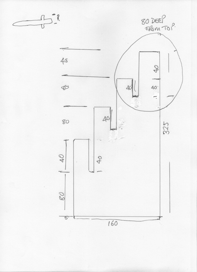

Bit of an odd question, but does anyone have a tested profile shape I can use for a custom sword rack? Many of the ones I see online are for Japanese swords and I'm concerned they would not accommodate differing shapes/widths per a broad ethnographic collection. The top photo is what I've been using, it is actually a silk spool holder used for Khmer ikat weaving. I find it works well for narrower blades but wide blades like a Kachin tool dao won't sit right, in fact the Lepcha ban in the photo just barely seats without tipping forward. I've also attached a random internet grab of a sword rack as reference. I can certainly come up with a profile by eyeball but I'm curious if someone here may have played around with different designs and have a profile they recommend.

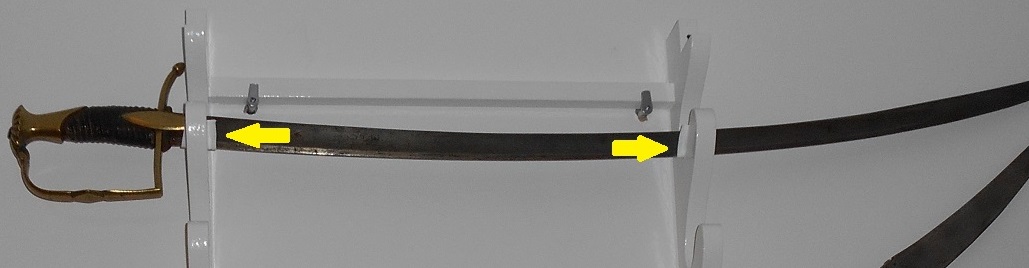

The round wooden hooks are more fit for guns, i must say; swords may turn down and not sit in the right position.
I have this problem even with standard sword stands (as I display most of my swords unsheathed, with the scabbards underneath) but I use some pieces of black isoprene to prop the swords within the hooks/cutouts of the stands.

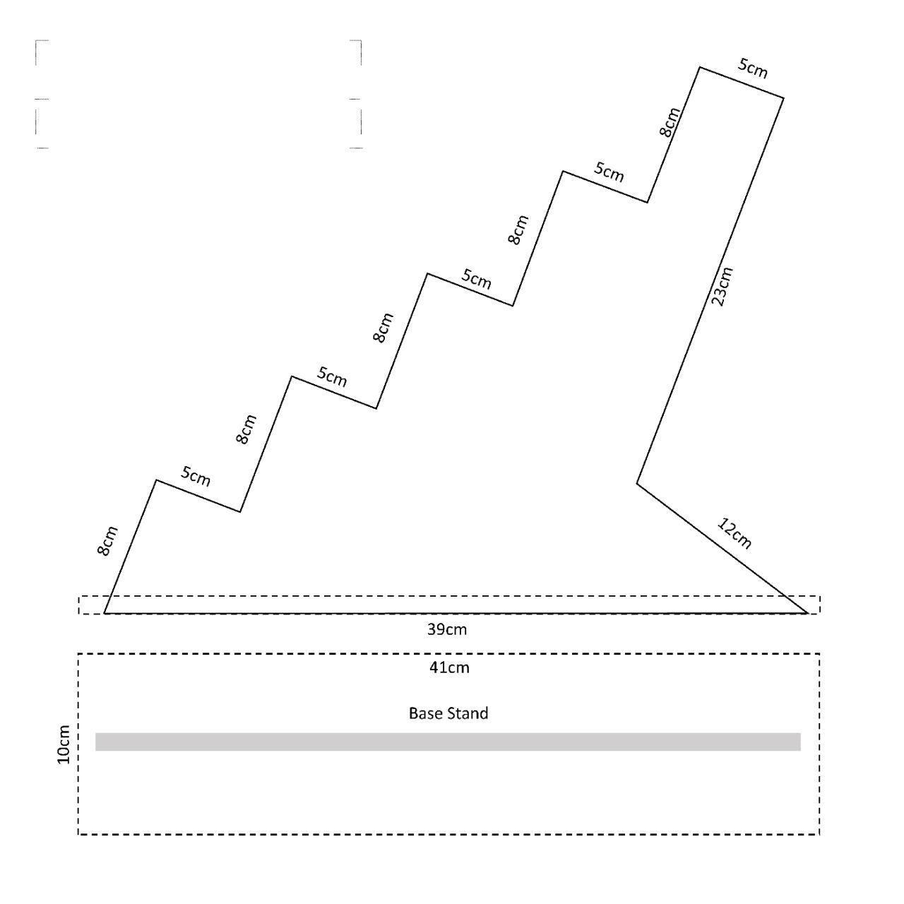

I'm a fan of clear plastic, I had these custom made a while ago. relatively narrow slots.

I agree storing in scabbards long term is not ideal. I am including a sketch with the dimensions in mm of my racks. Any shop that works with acrylic would manage it easily I think.

Good stuff, and thank you Iain for sharing the schematic.

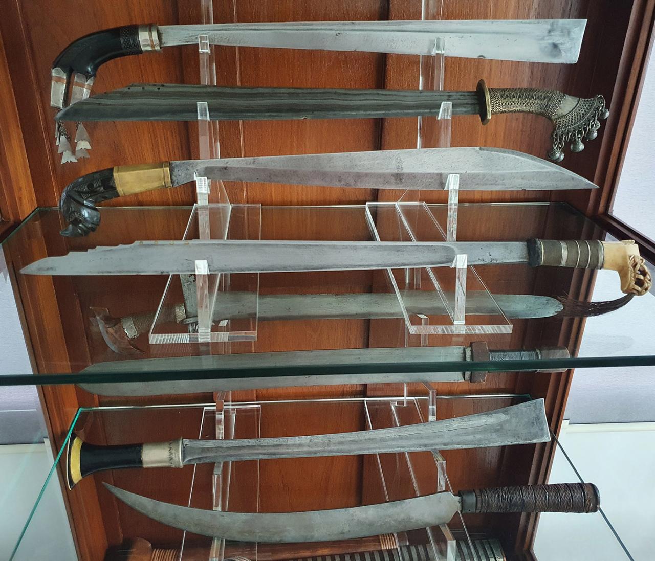

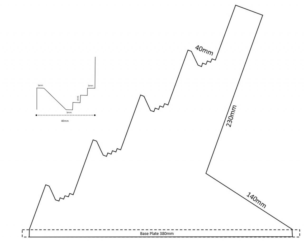

Inspired by Iain I had some racks custom made from acrylic. The first one (bottom shelf in photo) uses simple sloped levels to hold the sword/sheath. I found that blades with a strong change in width (e.g. klewang) would sit at sloped angles. The second design (top shelf) allows more adjustment using small steps so the blade can be leveled somewhat by using different steps for the different widths. This also allows you to adjust the vertical angle to better match field of view. I've included the diagrams of first and second designs. I need two more sets for my display cabinet so will play with the design a bit more.
