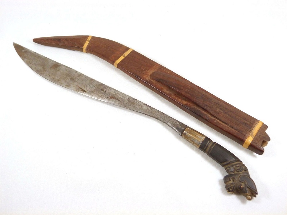

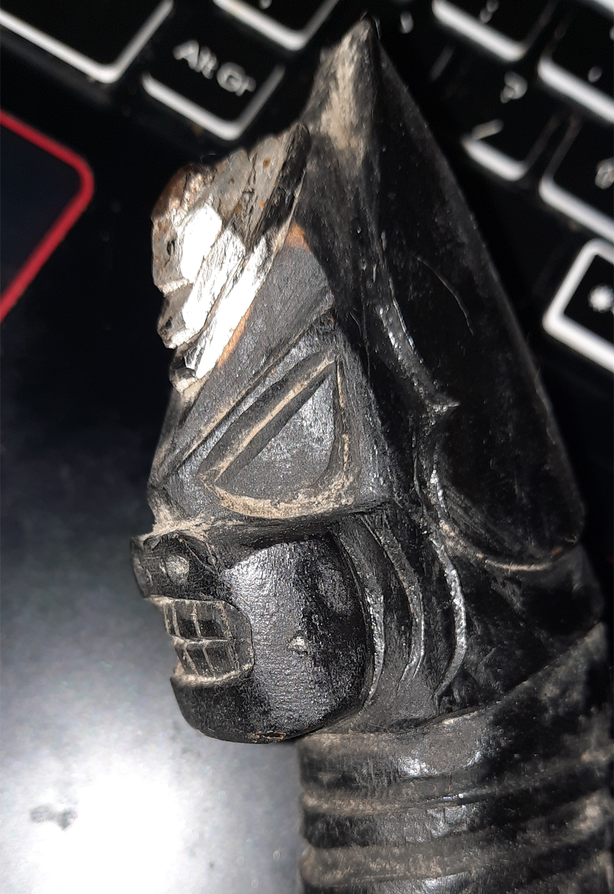

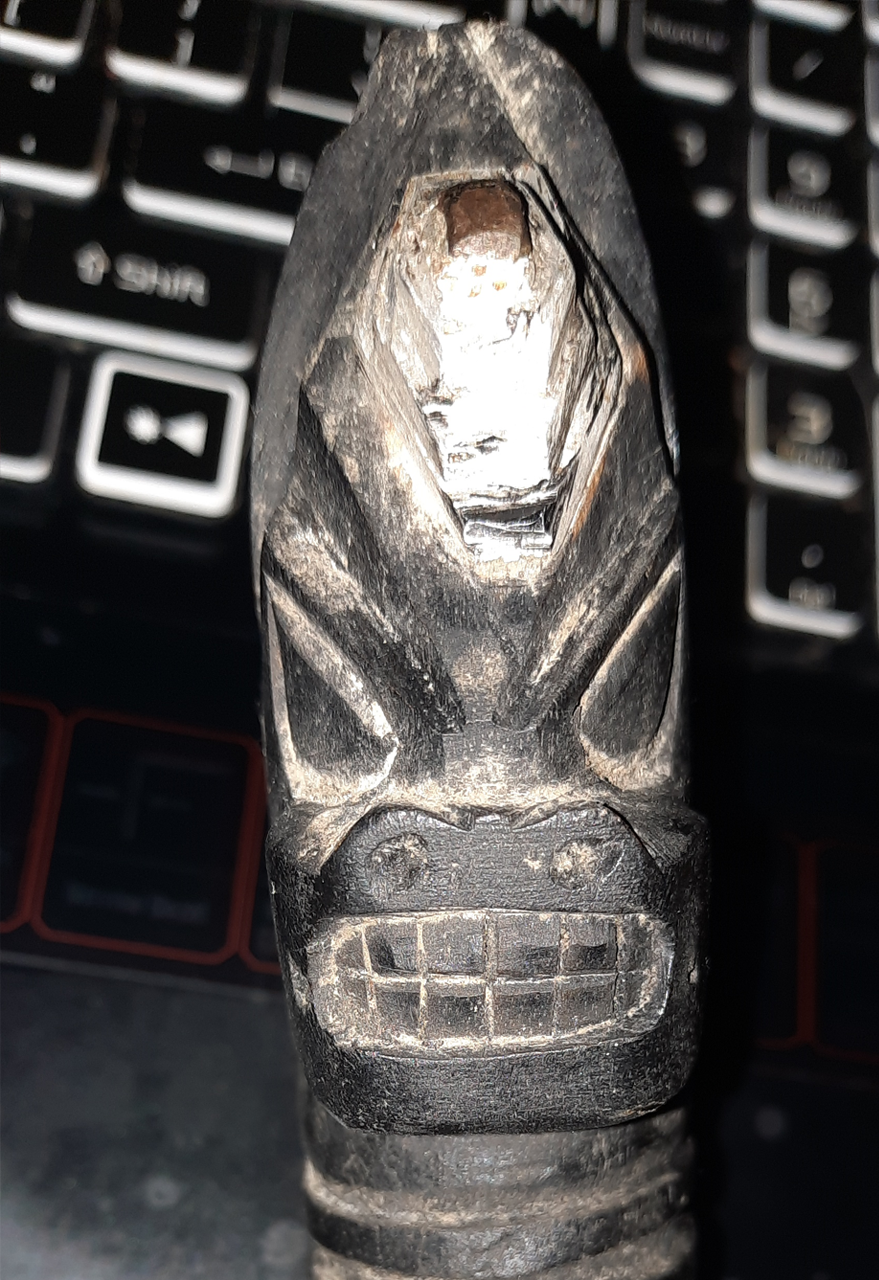

Hi all,
Our first Bicol blade, a ginunting. With an over-all length of 32 inches, with a 23-inch blade. The hilt is made from carabao horn and the scabbard, a hardwood called balayong (barayong).
But the point of interest for us is the mythical creature on the pommel. The son of the former owner informed us that according to his late father, the design on the pommel is an Onglo (hence, an Inunglo). When we started asking people who are knowledgeable on Bicol blades- they shared their opinion that the creature on the pommel might be of a 'pinaniki' design(in the semblance of a bat).
But the son of the former owner insists that it is an Onglo (Onglo is a mythical beast in semblance of an ape). And looking at the flaring nosetrils- it does look like an ape (to us), ha ha.
What do you think?
Note: this Bicol ginunting came from Matnog, Sorsogon.

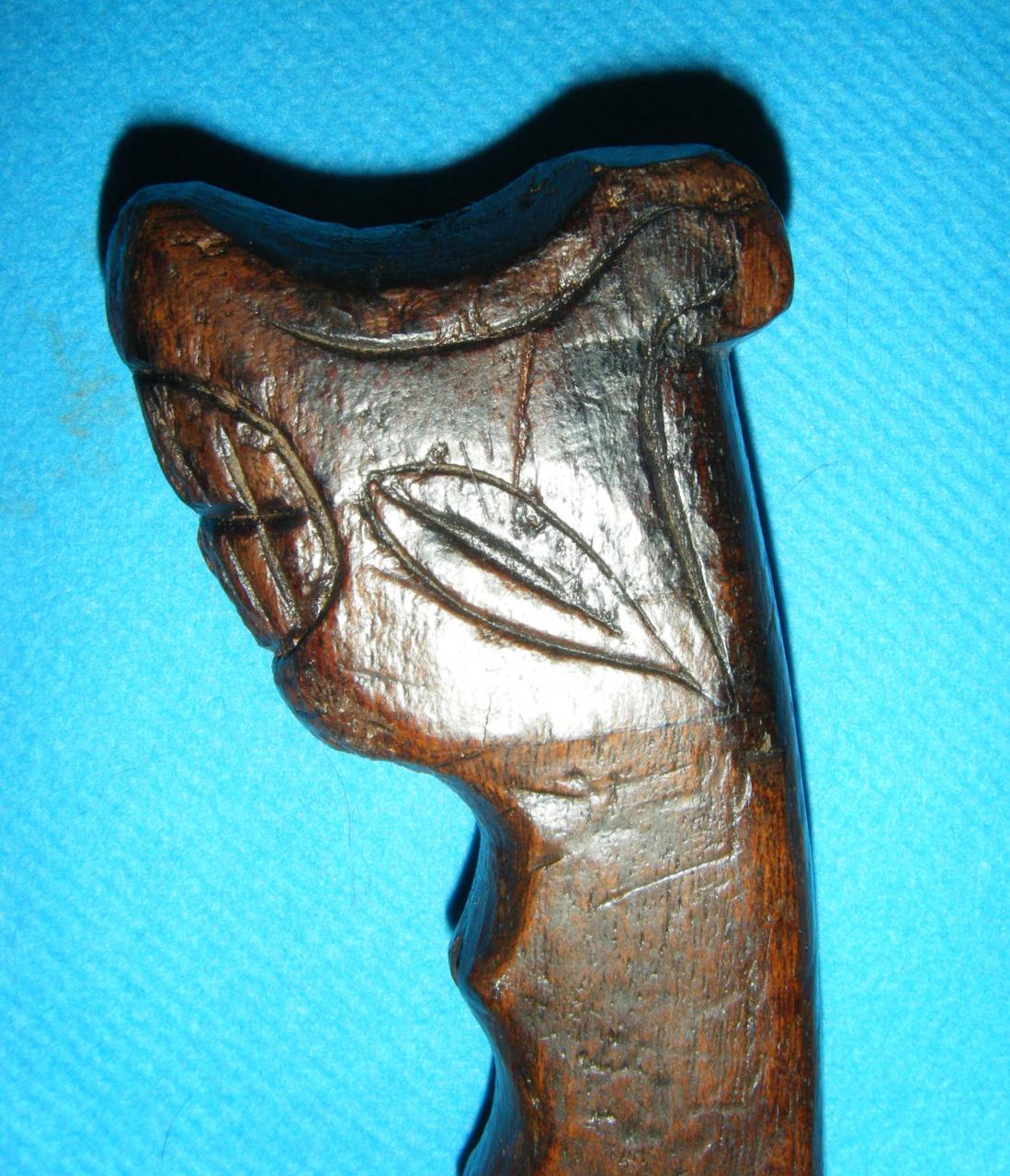

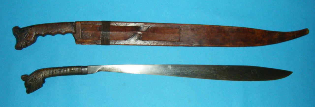

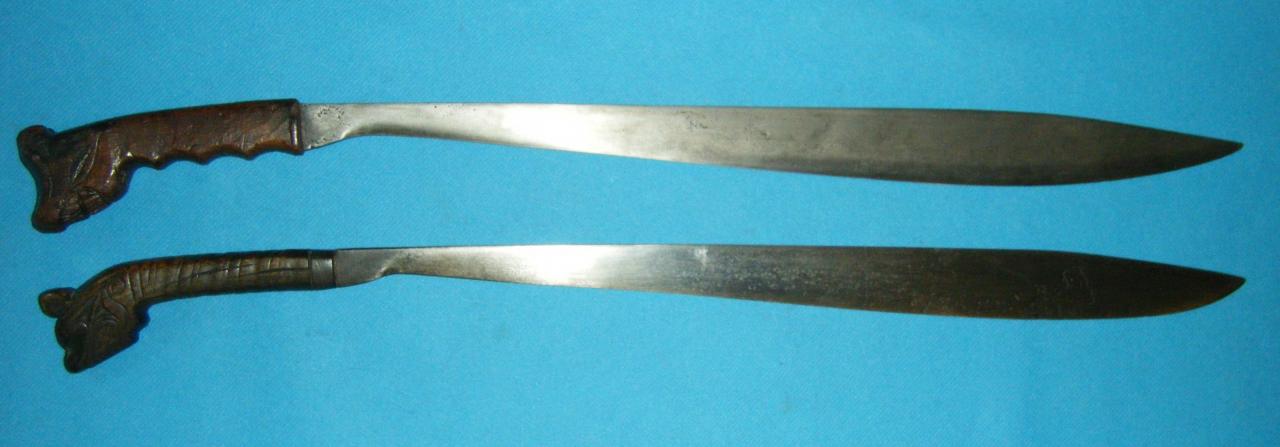

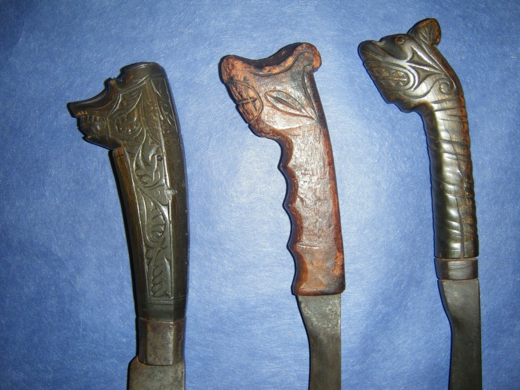

Nice and rare sword, any clue or guess how old it is?
Here are two from my collection, both are antique and very thick at spine, near the handle, 12 and 11,5 mm.

What do you see by yourself? Compare your blade with my two blades, do you see the same blade shape? Do you don't see the same pommel style? Same scabbard style?
I personally would call all three blades as binakla from the Bicol region, see this very informative thread: http://www.vikingsword.com/vb/showth...ighlight=bicol

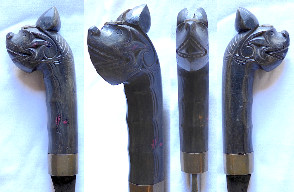

Another example of similar style. I don't have better pictures at present, but will try to post details of the hilt shortly. The hilt looks like a bat to me.

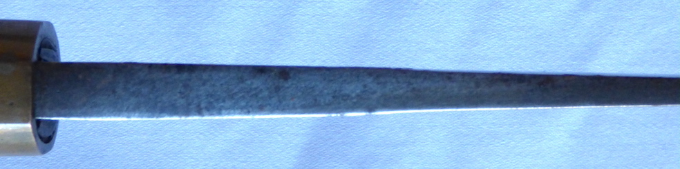

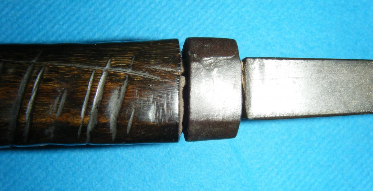

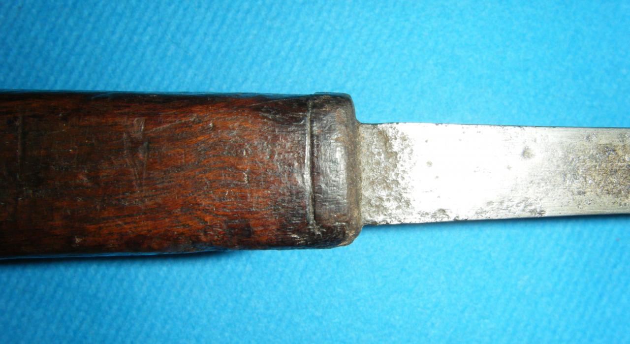

Here are the additional pictures of the blade I posted above. The thickness of the spine just in front of the hilt is 8.5 mm measured with a micrometer. The width of the blade tapers quickly moving away from the hilt, and the cutting area of the blade is about 3-4 mm wide for much of its length, tapering further to 1-2 mm wide near the tip. The clipped spine has a sharp back edge for about 20 cm. Both the regular and back edges are razor sharp and symmetrically V-ground (not chisel-ground). The regular cutting edge has been quench hardened.
The hilt has finger cut outs and what appears to be a bat's head for the pommel. The hilt is full tang.
Length of blade = 48.0 cm (18.9 in), length of hilt = 13.8 cm (5.4 in).

Hello Yves,
Hi Sir,
I've done some searching and queries. I may have a solid answer to the question on hand. But I need you to send me some pics of the 'BARAT' or the TANG RIVET. This (and some other aspects of the blade), according to a very knowledeable person on Bicol blades would determine the answer to our questions.
The 'barat' is the rivet at the tip of the hilt.
Yves

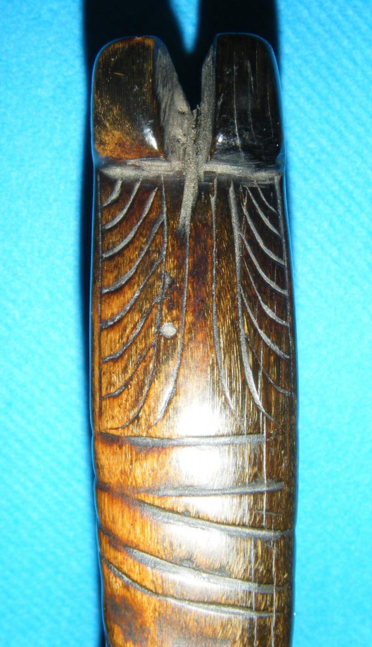

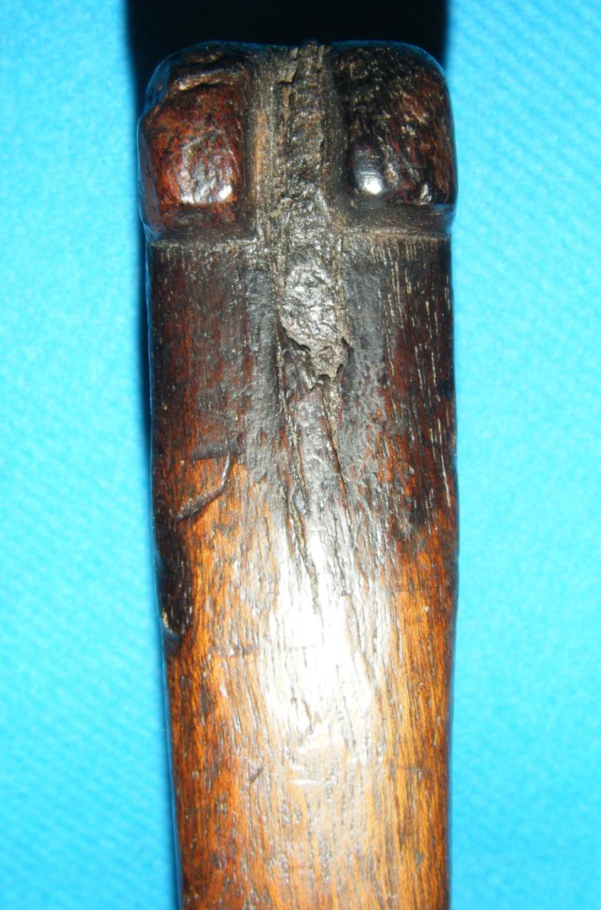

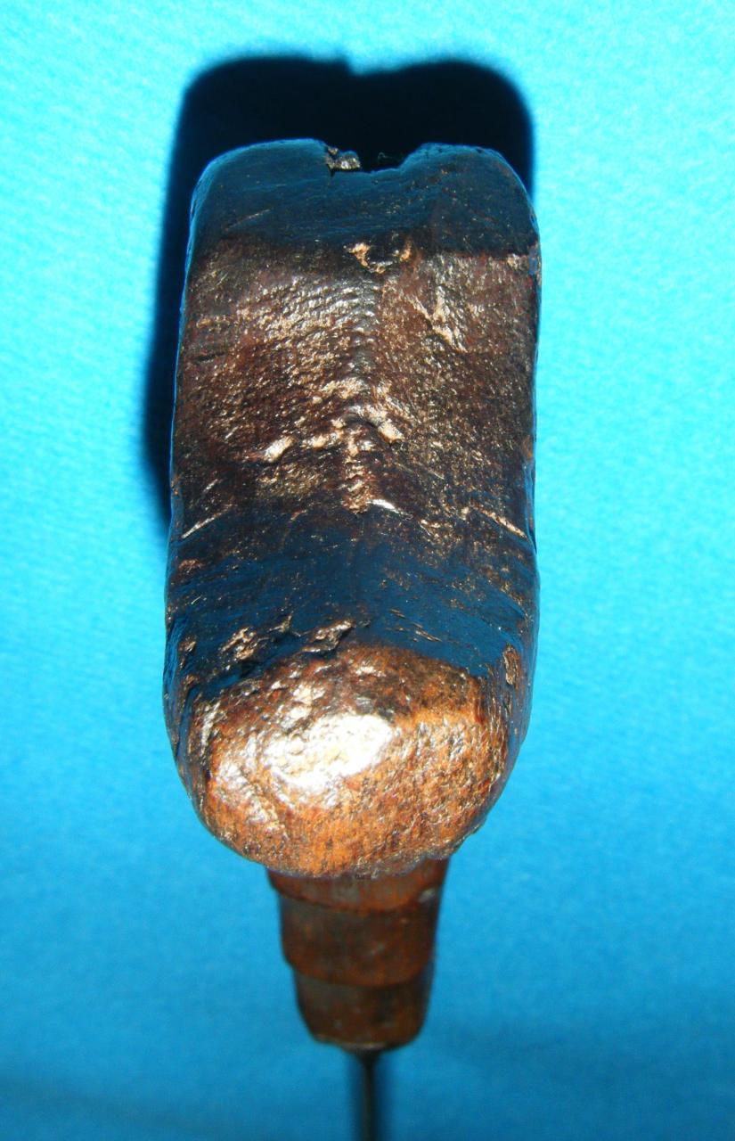

First, thank you for your response! I will post pictures from top of the hilts but I guess that they won't be of great help, both tang ends are rotted away from corrosion. Just give me some time to take pictures.
Old 30th October 2021, 11:00 AM   #17
Posts: 9,668

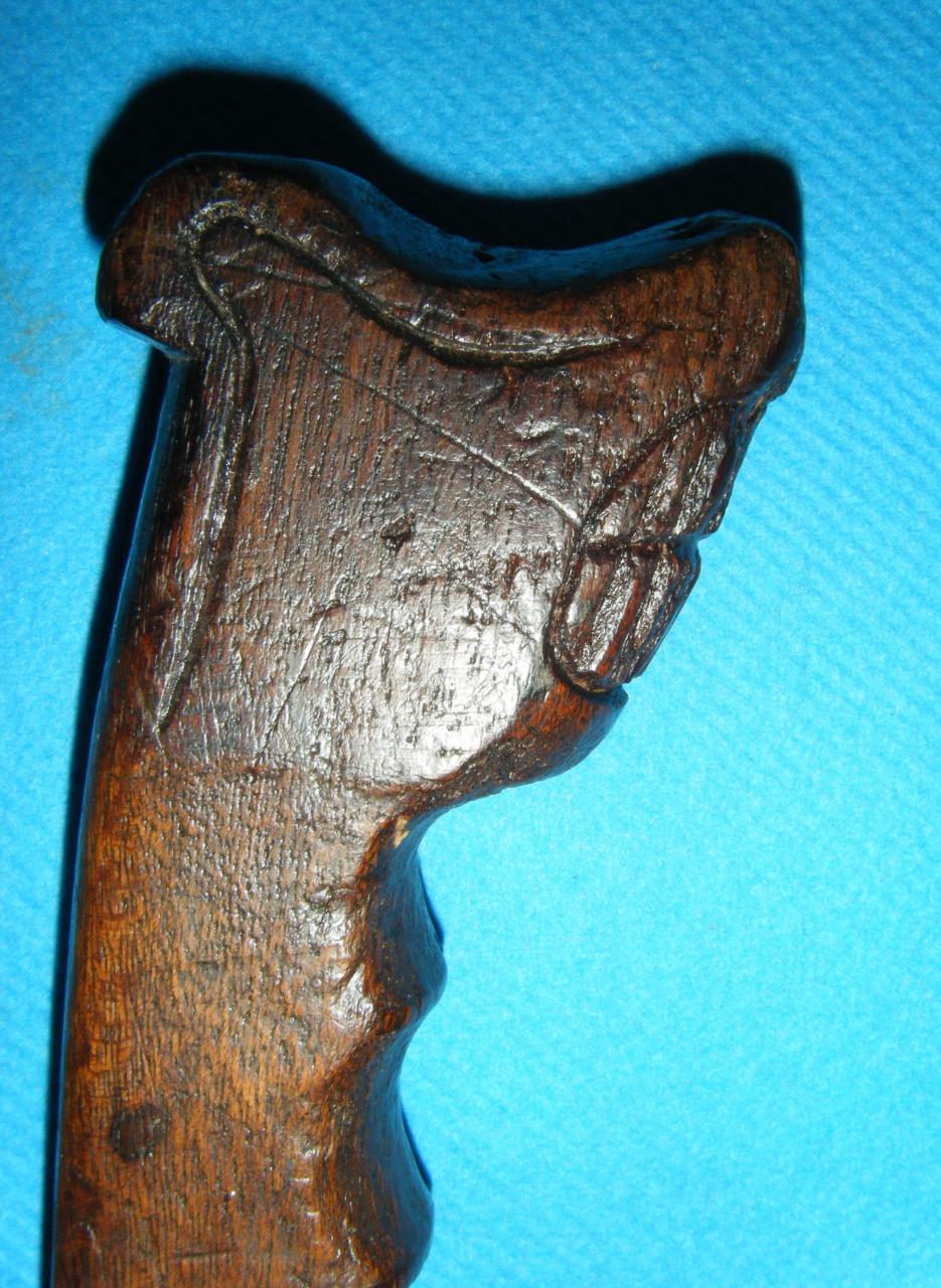

Hi Yves,
The "barat" from my third binakla you can see by the attached pictures.

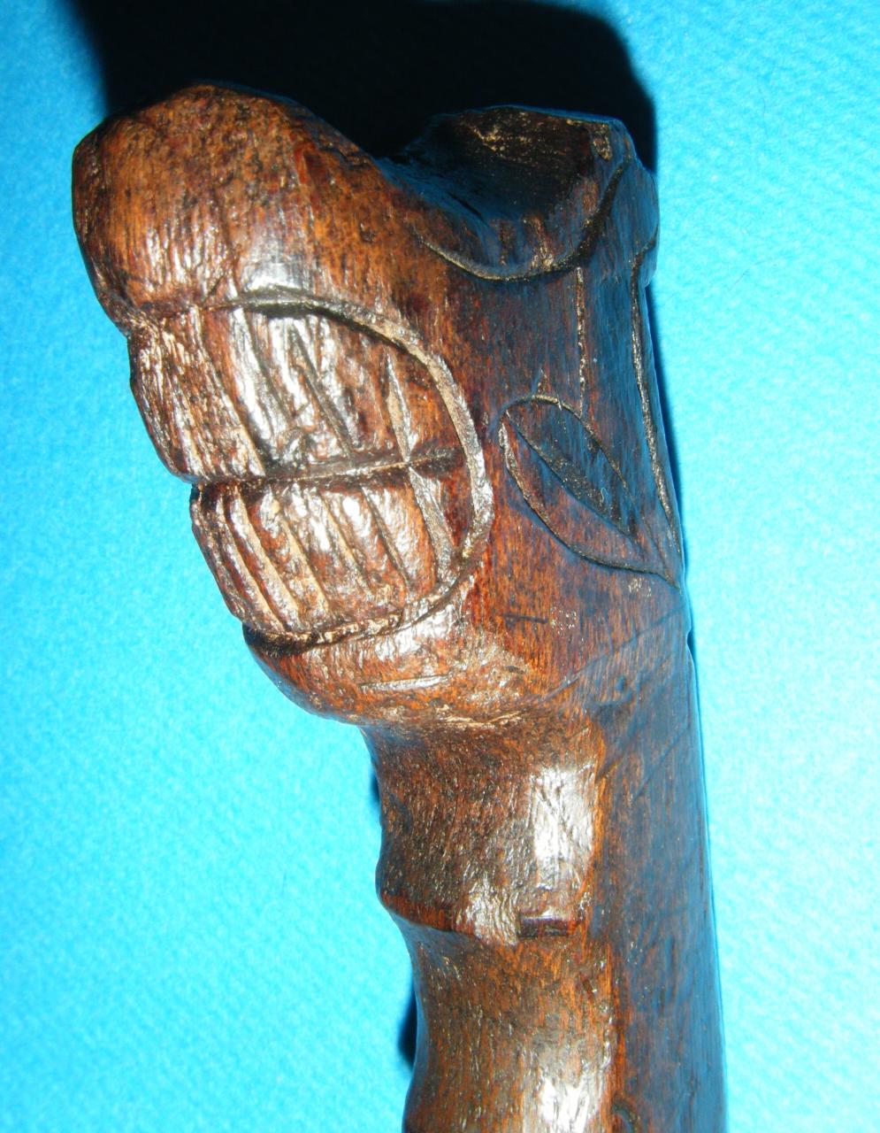

And here are the pictures from the sword in above with wooden handle, like said, the barat is rotten away, I've attached some more pictures from the handle.
Old 30th October 2021, 02:20 PM   #20
Posts: 9,668

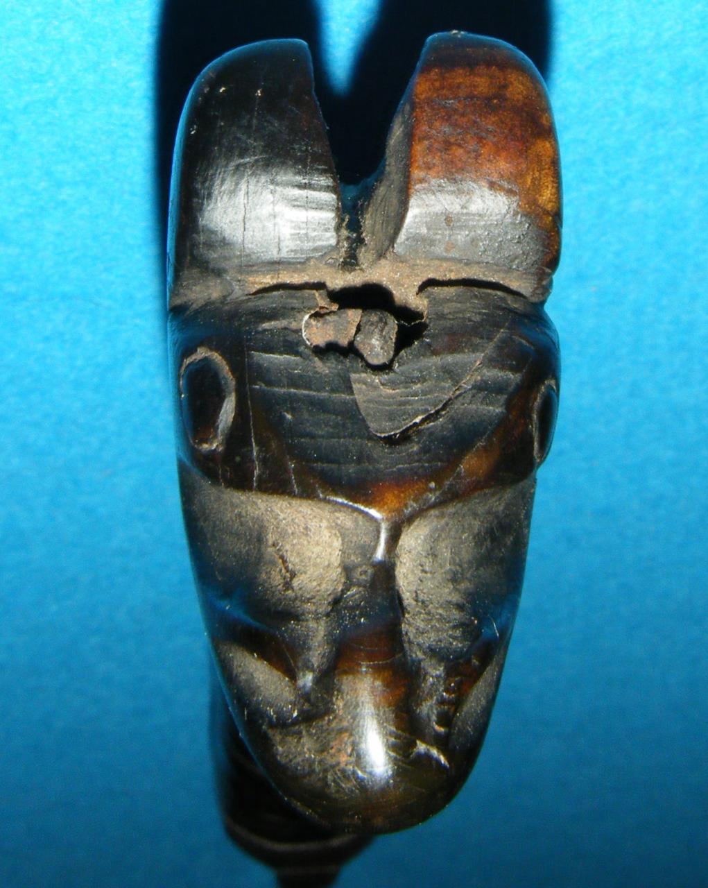

And here the handle from the sword in down with horn handle, the barat is as well gone due corrosion but with a little bit imagination you can see the form and where it was situated.

Hello Detlef,
Here are some inputs from my contact in Bicol:
1) the blade profile is indeed a 'binakla,'- even in the absence of a 'manok-manok' (serrations on the blade). A minasbad indeed;
2) It might have been forged in the Province of Sorsogon (that's in the Bicol Region). Now looking where Sorsogon is (southernmost part of Bicol)- your blade certainly have a very clear Visayan influence (your third binakla). This 3rd binakla blade has a kinabayo hilt- with, of course, a ginunting blade;
3) But the scabbard on the 3rd binakla is not Bicol. But rather of 'Visayan influence' as made mention in # 3. It would have been much nicer, he says, if the scabbard is Bicol;
Hope this clears the air a little bit. ha ha ha.
All the best,
Yves
