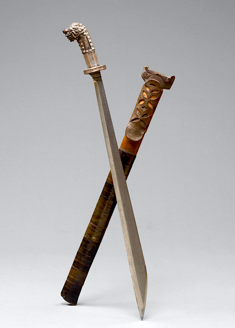

Hi everyone. Regarding the style of scabbard with that particular sheet binding, there's a provenanced tenegre picked up by Austrian explorers on an 1857-59 expedition that has a similar motif. Here's the description from the database-website "Mapping Philippine Culture," the sample itself is located in the Vienna Museum of Ethnology:
This sanduko bolo was obtained in Luzon but is typical for the island Panay. It features an elaborately carved and silver coated pommel, representing a demonic head - probably a naga or the mythical creature bakunawa. The blade has its center of gravity towards the tip, thus enabling to gain momentum for hacking and chopping cuts. (Oliver Moiseanu 2009: 63)
Here's the provenance:
The Austrian navy carried out its first major scientific mission with the frigate “Novara,” circumnavigating the globe within two years and three months (between April 30, 1857, and August 30, 1859). The crew returned with collections of botanical, geological, zoological, and cultural materials. This sanduko bolo was obtained in Luzon but is typical for the island Panay. It is among the few ethnological objects the “Novara” team collected in the Philippine Archipelago.

Indeed a great information! And the scabbard is covered in horn and has a leather throat! And it's very similar to the one in discussion. So it can be from 1850 until 1900.

I followed up on your reference and found pictures of the sword and scabbard. However, I could find no mention of the horn plates and the picture is not clear enough (at least for me) to see whether there are any plates present on the scabbard.
The information I had about dating leather throat coverings and horn plates came from Federico Malabago on the old UBB Forum, now unfortunately defunct.

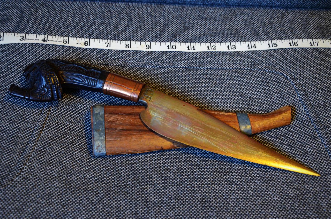

The brass insert is for aswangs. They still believe in aswangs on the island of Panay today. Usually, the whole blade is made of brass or copper, but on longer blades a piece of copper/brass is incorporated into the blades since brass/copper is too soft and will not hold an edge.

Here's an Ilonggo plamenko with an all brass/copper blade. Its sole purpose is to be used on aswang.
