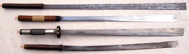

Really impressive, seems to be a pretty long piece,
more than one meter / 40 inches long ??

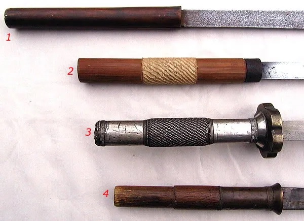

Some more examples of unusually long dha of similar manufacture.

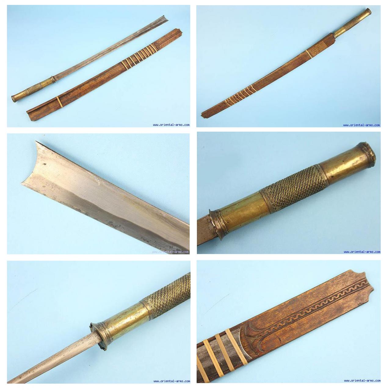

I also found another example, on the old Oriental Arms site, Oriental Arms example. This one has an old label on it, I have tried to boost the contrast but still can't decipher it but one word appears to be "Burmese".

Originally Posted by JeffS View Post
...one word appears to be "Burmese".
And the word "Dacoits" reads quite clearly.
Old 28th September 2021, 09:02 AM   #11
Ah then much of the rest falls into place "A Burmese xxxx xxx a dah used by dacoits which means highwaymen or brigands"

Uploading the images from the old Oriental Arms site, Oriental Arms example.

I think the inscription reads: "A Burmese weapon I had a dah used by Dacoits which means highwaymen or brigands"
