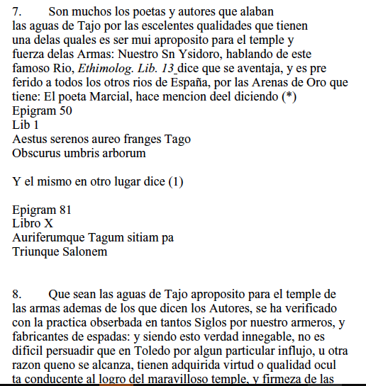

Like for whisky and textiles, you chose a place near a river where the water is pure and full of properties, to install your mill.
Toledan sword smiths and cuttlers may not have chosen the place but they have benefitted from the Tagus river waters. Apparently the Romans envied their results; those which derived from not only the Tagus but from their demanding for a reliable raw material, that from the Mondragon mines. But was is more accentuated as techiques go, is the Tagus waters ... and its sands (where gold abunded and all ?). This is where history is cocktailed between the magic properties of the river and the extremely complex skill they used to forge their blades; to a point in that they (the early ones) wouldn't know if the result was achieved by their own ability alone or the magic resided in the river waters.

A very good note Fernando, and the access to running water is key to placement of mills, of course to turn the machinery.
This is noted in references to various blade forging places, and there are numbers of thoughts and suggestions of quality achieved by the 'magical properties ' of the water and/or minerals etc. in it.

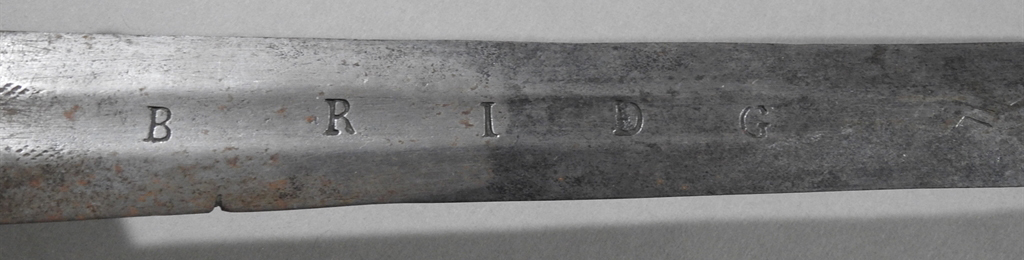

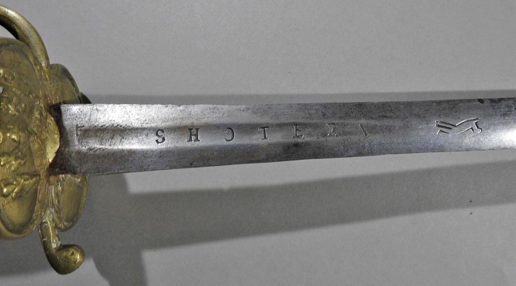

Default Shotley Bridge blade

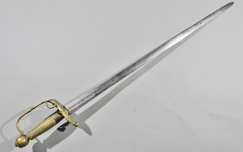

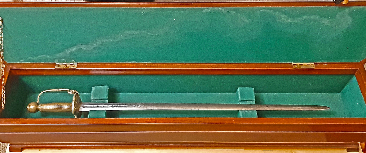

My Shotley Bridge sword (which was actually forged in Solingen and brought over with the immigrants: it has a Passau Wolf along with the script Shotley Bridg; see images) is still fantastically sharp but also very flexible. I'm too scared to subject it to excessive bending but I suspect it would survive.
So, while the Germans adopted the Damascus skills, they progressed way beyond such Middle Eastern results.
It must have seemed like magic to those 17th century soldiers. I can not agree more with you Jim regarding the superstitions culture back then. These guys lives depended on the quality of their blades. Let's face it: a bent blade is as useless as a broken blade on the battlefield. Any magical help would inevitably be seriously desired.
Incidentally: the Blacksmith was always regarded as powerful against dark and demon elements and forces - and the smithy a place of safety. If he put a symbol on your blade you were definitely well off.
Old 17th August 2021, 11:08 PM   #18
urbanspaceman
Join Date: Sep 2017
Posts: 730
Default ps
Note the very distinctive forge weld of the blade up at the forte and the gouge under the letter B in the softer metal.

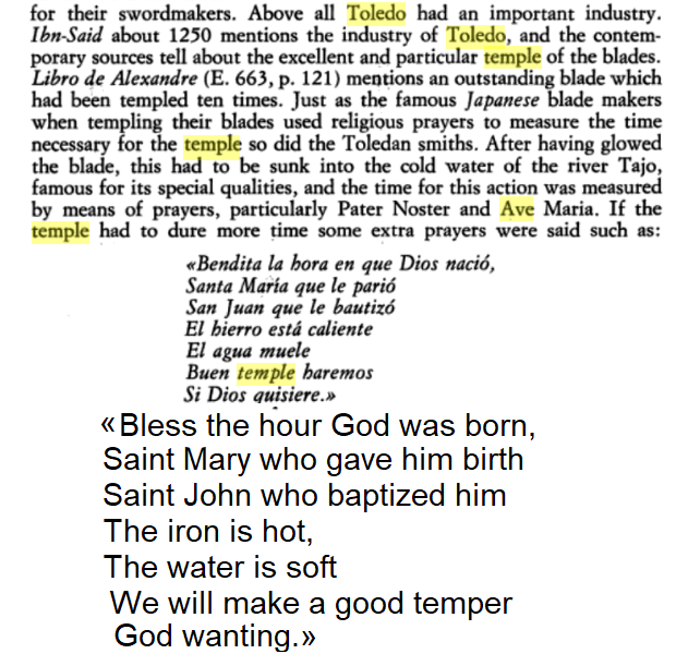

We may read in works like one of Ada Bruhn de Hoffmeyer that, time counting for blade tempering was done by saying prayers ... at least by Japanese and Toledans. Could it be that, equivalent to 'modern' clock, their available resource was the one they have achieved with then primary (unique) culture; religion.
In Libro de Alexandre it is mentioned that an outsanding blade was tempered ten times.
Old 18th August 2021, 07:38 PM   #20
Posts: 10,733
A superstitious resource ... or no clock available ?
This is absolutely fascinating Fernando! and while I had always been aware of superstition and 'dark forces' (occult not evil) at play in forging of metal and blades, I had not realized the religious aspects.
Considering the profuse representations of religious invocations and phrases in inscriptions on blades, this seems perfectly placed.
Thank you again for sharing all this valuable information.

Looks like the form of clock was both time spent speaking out prayers and verses, probably to support a skilful eye for colour checking. We may see that both 'techniques' were (also) used in Toledo, as written by various authors.
The synopsis
The fifteenth, sixteenth and seventeenth centuries marked the greatest splendor of this industry and it is when the Guild of Sword smiths began to be constituted, artisans from all over Europe and even from the East came to Toledo to learn from those artisans the “secrets” of the manufacture of the inimitable blades, that raised the name of Toledo and its Tagus to a height that no other city has been able to reach through the centuries.
The fame of the old Toledo steels lies in the mastery with which some craftsmen handled the tempering, without any technical knowledge or instrument capable of measuring, even remotely, the appropriate temperatures for said treatment. The temperature was known by the color of the red-hot steel and the time of immersion in the water, through prayers or verses alluding to the trade. The people attributed this quality of the temple to the waters of the Tagus river in which the swords were tempered.
... and the unavoidable legend.
Legend has it that the first tempered steels were developed by mere chance in Toledo, Spain, where the royal armory was concentrated in the middle ages. Swords, armor and metal parts in general were manufactured there. Through a mixture of cruelty and servility, the royal blacksmith came up with the idea of ​​skewering a prisoner of war (probably a "Moor" or sympathizer) captured in the wars against Arab domination. No need to explain that this cruelty made the blade of the sword to be heated "to red" to commit the "symbolic act" "ritual death" or "baptism of blood" and the result was overwhelming, the sword was hardened or TEMPERED using the body of a man as a refrigerant for the process, in front of the discovery, The surprise and after the surprise, all the nobles ordered their Toledo sword, so they were left without slaves to sacrifice and by dire analogy and contempt for the enemy, the slaves were replaced by pigs that died in a tempered process of swords until someone thought of that that of having to kill someone or an animal to temper the steel could be a superstition and they tried to do it with water, oil, with the same results and so it is until now on the west side of the planet.

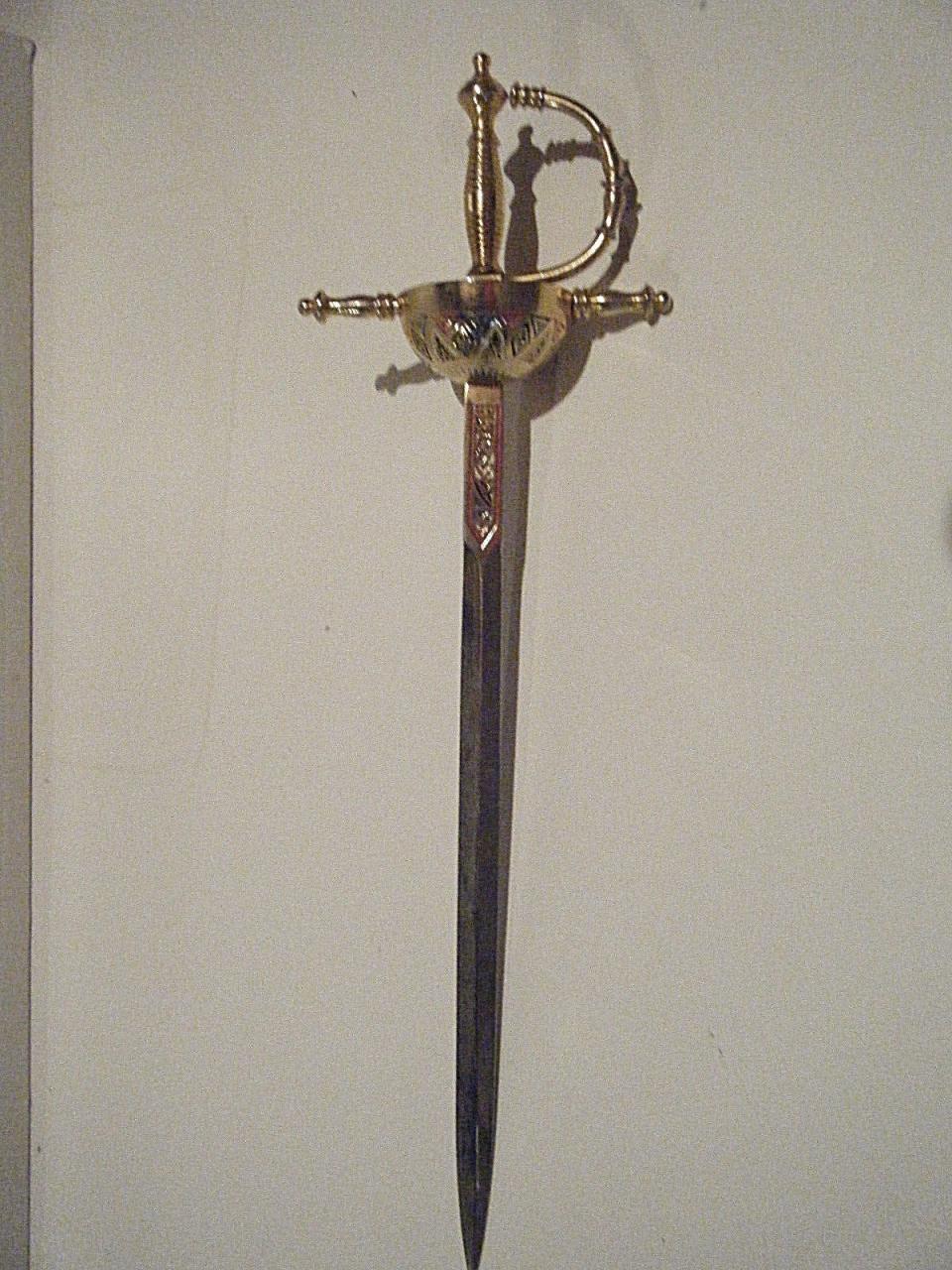

Actually, the ubiquitous cup-hilt rapier letter-opener has been apparent all of my life; and the cocktail sticks too. Spain was ultimately exotic for the early 'sixties hoi-polloi here in Blighty, and those mini rapiers were only equalled by the sombrero or maracas.
Hello Keith, I have just-re read your excellent book on the swords of Shotley Bridge and I recall a while ago you were actually in Solingen searching their archives most thoroughly ! The sword you illustrate is in my opinion extremely rare .. Regards Peter Hudson
Hello Peter. I will get a new copy of the book to you soon. It has not been officially published yet, nor proof read and edited, as it is intended as a companion piece to the BBC documentary - if it ever gets made what with this dammed virus hanging everything up.
In the meantime, I continue to amend and augment the book as more and more details surface, even after six years of research.
I have had the book privately printed for interested parties who are content to accept it in its present form - which is actually a far more luxurious product than the official publication will be.
The sword is the one from the cover of David Richardson's famous book and is in exemplary condition: they are very, very rare, for reasons explained in the book.
It belonged to Hon. Thomas Watson-Wentworth, son of Edward Watson 2nd Baron of Rockingham. It passed to his son of the same name: 1st Marquess of Rockingham who had a custom-made mahogany casket to put it on display when he built Wentworth Woodhouse (see below). Even he did not know the full story of the sword and described it as Shotley Bridge circa 1680 on the plaque.

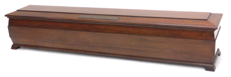

I made a mistake... my sword is not the Wentworth-Woodhouse sword.
The casket is as described, but the sword is in the possession of the Royal Armouries.
It is virtually identical to mine except the binding is missing.
As I said earlier, the information just keeps creeping in.
Now I have to find out where my sword came from.
