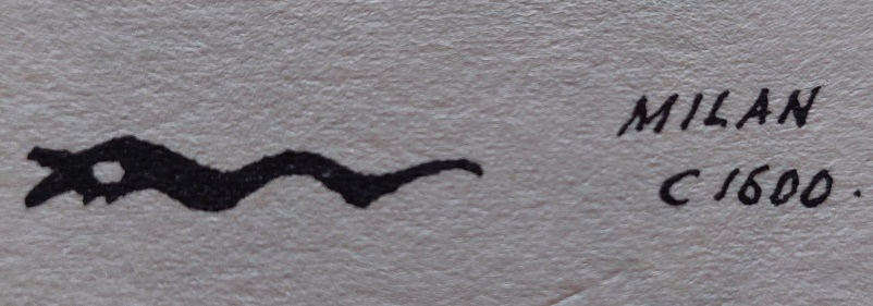

If I recall correctly I have seen a snake maker’s mark attributed to Milan.
Old 1st August 2021, 10:11 AM   #4
Exactely.
I wonder what kind of exposure this sword was submitted to; one consistent with the wood of grip looking (almost) intact .
Old 1st August 2021, 04:26 PM   #5
Posts: 10,833
Good call Victrix (and image by Fernando) of the serpent mark, which is the 'biscione' (=grass snake) of Milan , attributed to makers in that location and apparently in neighboring centers such as Ferrara. Actually the image in Kinman shows this snake as ANDREA FERRARA.

The combining of Spanish name and in this case, Italian mark, further identifies this as a German product and of probably mid 17th c.

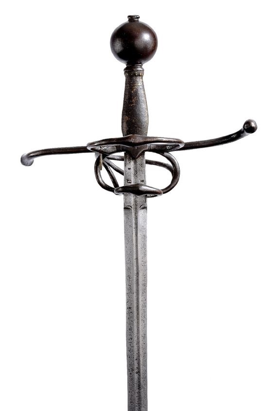

Military Rapier Dated: circa 1570-80 Culture: German Measurements: length 127cm/50 inches Provenance: The Dukes of Brunswick-Wolfenbüttel; Clarence H. Mackay; Hans von Schulthess, Schloss Au, near Zurich, Switzerland

and another one, this one with a back blade , sold at Christies in 2008 for 10.000 £
A GERMAN MILITARY RAPIER
CIRCA 1570-80
With flat blade double-edged over the upper third of its length, both sides cut with a near full-length narrow fuller, an additional fuller parallel with the unsharpened back, the inner-face struck with so-called 'eyelash' marks, and with further arrangements of 'eyelash' marks on both sides of the ricasso, iron hilt of rounded bars, comprising a pair of long horizontally recurved quillons with pointed swelling tips, upper and lower ring-guards swelling in the middle, a pair of arms, inner-guard of three diagonal bars with thumb-ring, large globular pommel, original fishskin-covered grip reinforced by four moulded iron longitudinal bars, strongly cusped iron collars at both ends, the hilt retaining traces of its original blued finish, the greater part lightly oxidised to russet, and in fine untouched condition throughout.

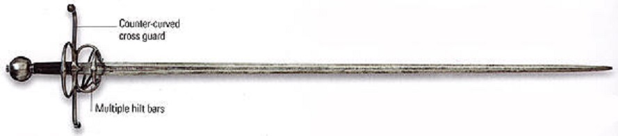

A German rapier dating from c.1560—70. It has a large spherical pommel that counterbalances the weight of the blade.

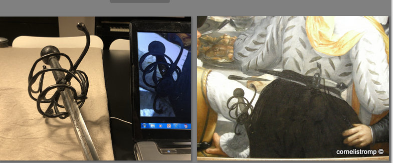

Join Date: Mar 2009
Posts: 1,069
round pommels are simple in shape but very rare on rapiers and swords. In the Netherlands they appeared frequently on civic guard paintings in the last quarter of the 17th century. According to Jp Puype, the round pommel would be characteristic of Dutch rapiers or rapier worn in the Netherlands.
I wouldn't be surprised if the rapier under discussion indeed was found in the Netherlands.

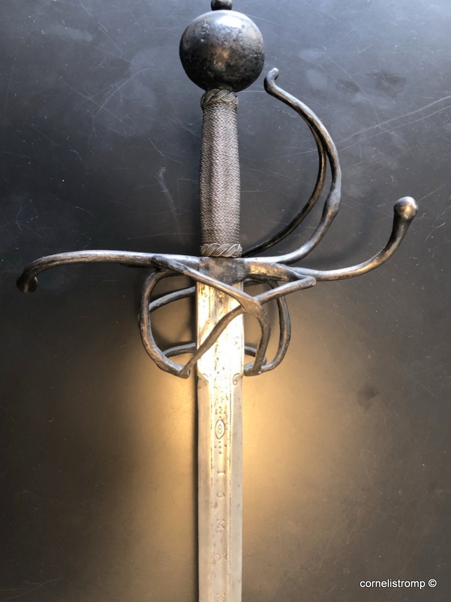

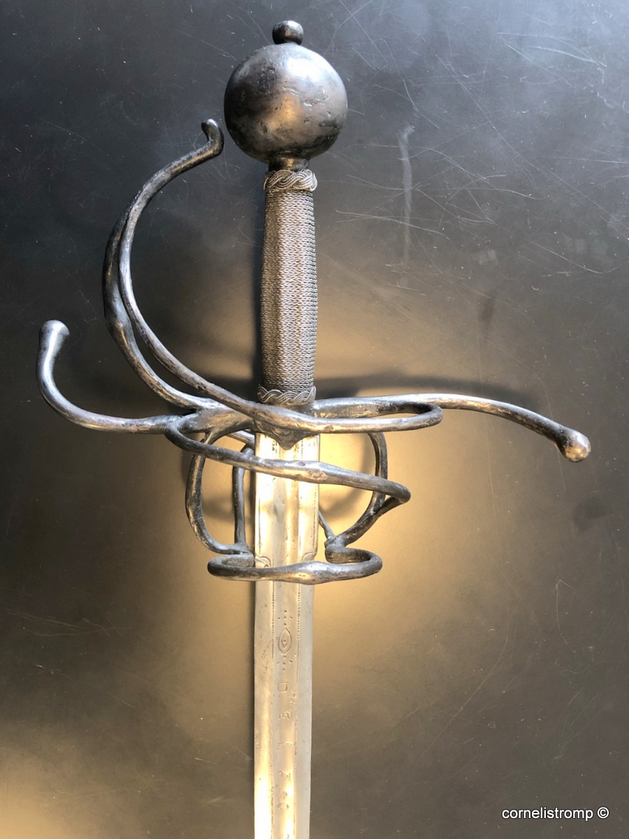

The dating of Ulfberth a 1580 is absolutely right, this is the second time I come across this type of hilt, I have one in my collection of which the blade bears the name IOHAN DE LA ORTA (made by the hand? or referring to Juanes de la Horta a blade smith working in toledo).
BTW Alonso de Sahagun was also active in Toledo between 1570-1600.
What is very interesting of this Hilt type is that it is depicted on a painting by van haarlem dated 1583. see attachement
In the upper ring guard of this hilt type there was a paring plate, probably visible from an incision on the inside of the upper guard ring.
best
Jasper
