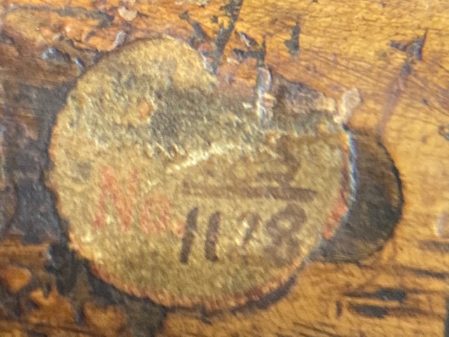

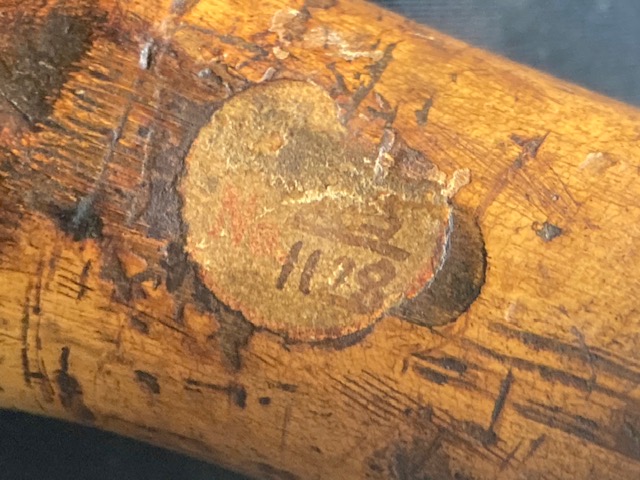

Here is a recent acquisition that I very much enjoy. It is a Lohangi Katti mace from India, circa 1800’s. It’s length is 57 inches with a unique iron/steel wrapping configuration around rattan with well fashioned ferrules.
I would love any feedback on its history. It is featured in Egertons book and I found two examples in British museums identical. The VA Museum.

That's a lovely mace. I recall seeing a similar one in Egerton's book, and his extensive personal collection mostly ended up at the Victoria and Albert Museum, so maybe it's not surprising that you found pictures of examples there. Sorry, but I don't have any specific information about these.

Glad I could add to the entries with the guys here, I excerpted all the material from Sinclair which is simply a brief article in that periodical, and I had a photocopy from the British Museum from about 20 yrs ago.
It does seem possible that the weapon in Egerton is the same as the one in V&A holdings as its provenance is noted as Satara, as noted in his reference.

Thanks Jim and Ian et all for further insight, reference and direction.
I will research these tribal groups within the Indian subcontinent. Also I will reach out to the Victoria Albert Museum to see if more insight can be attained from their provenance (Egerton?).
My eyesight is not the Eagle eye it used to be. My friend was glancing the weapon and he spied some numbers on the pole immediately bellow the iron bludgeon wrap.
Possibly museum catalogue numbers?
I’ve attached a closeup.
Ian, this is absolutely fascinating to have this kind of first hand anthropological insight into this group of people in India! I am sure that the instance being described by Sinclair, the author of the excerpt I noted, was describing an instance which reflects the disdain of which you speak toward these people in that time.

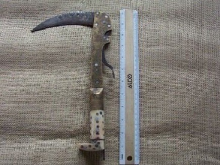

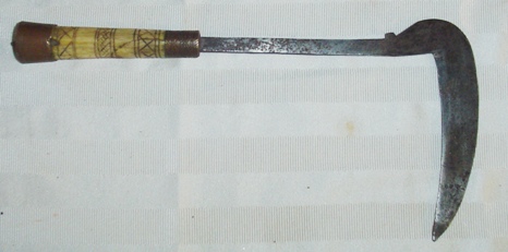

Which brings me to the question you asked David, on the axes of the 'Thuggee'. As I mentioned, an axe purported to be one of these was handled by the commander of the fort in "Gunga Din", and if I recall was a hafted type similar to the 'lohar'.
As far as generally known, there are no examples of these secretive weapons to have survived, and little is known of them. From what I recall the only reference to them (which I found passim in one source) is that they were small and of a hafted type very similar to lohar (a kind of ravens beak form).
Apparently they were crafted by the thug individual himself and followed elaborate ceremony involving concoctions of milk etc. and one note indicated decoration with seven strategically placed red dots.
It is interesting that this description of these axes being made by each man himself is remarkably mindful of the same description made by Stone (1934) toward the lohar axes of the Khyber, which each tribesman ( I believe they were Bannuchi if I recall) made himself.
We are seeing connections of these tribal groups here, and with the seeming variations of religious ascetics and mendicants which include the well known 'fakirs' it would be a fascinating study to learn how they are connected or differ. The unusual assortment of weaponry broadly ascribed to 'fakirs' such as madu madu; fakirs crutch and others seem to have an arms genre of their own, to which the lohar, Thuggee axes and for that matter these 'lohangi' may be added.
