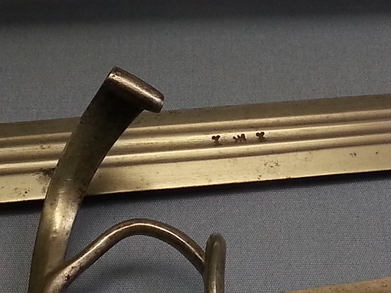

Interesting that you think it might be north Italian. I've seen these broad double edged blades with triple narrow fullers at forte on many schiavone. Also possible that the blade might be if those three marks are indeed the commonly seen "asterix" or cockleburr stamps seen on many blades from the region around Venice. I agree, detailed pics would be nice!

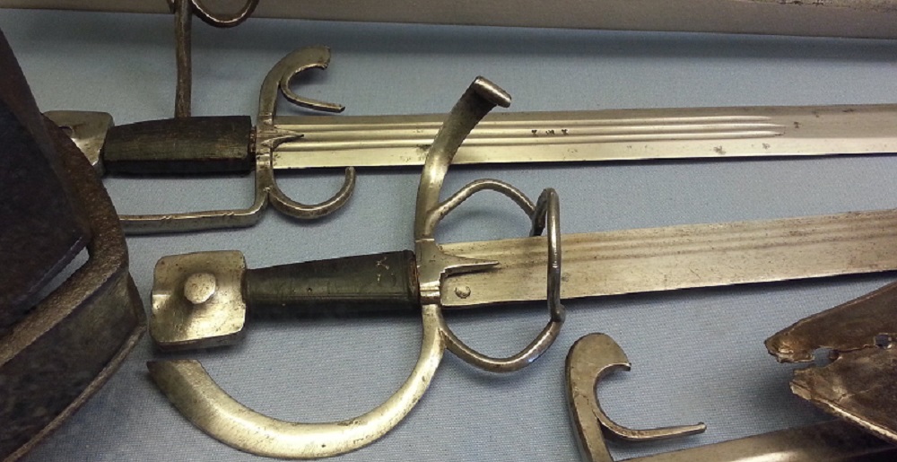

Here is similar blade with the same stamps around 1500 in the Doge palace museum in Venetia.
kind reegards
Ulfberth
