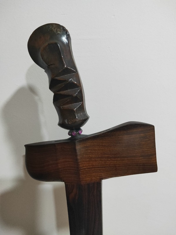

I just got it last week and thought to showcase to fellow collectors/members.
Unsure about the era of make, maybe late 19th century.
Keris Pedang Bali Lurus Ulu Kusia Tandok where hulu is made of buffalo horn, and depicts a figurine called Kusia; a locust like insect. The pamor pattern are arranged in the mlumah technique, of the kulit semangko. It is said to be used by warriors but this keris pedang is slim, not sure the purpose for it's make.

The hilt and scabbard are new made, but for the blade I don't Know.

Hi Anthony. Yes Kusia or Kocet-Kocetan hilt. I wouldn't say it is new, but i would imagine much newer than the blade. The sheath is probably the newest part of the ensemble.

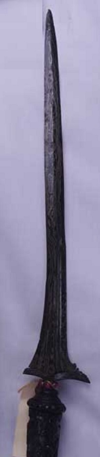

I think you are probably safe calling this blade 19th century. It would be nice to see a photo of the entire blade so that we can see the proportions.
Keris pedang may well have been used by warriors, but my understanding of kocet-kocetan hilts is that thy were most appropriate for the priestly class. I would image this is more an ensemble put together for appearances than actual societal or cultural purposes. I nice acquisition regardless.

Yes, I think the present hilt is not really suitable for this keris, but its a nice hilt and these are relatively scarce, even recent ones, so my inclination would be to mount it as a display hilt on a stand.
I think I'd like to see this keris with a bound loncengan, or a cekah solas or cekah redut.
Hi David, Hi Alan
You are right to say that this hilt is not suitable and I overlooked on that part. I will swap it according and mount this horn hulu on a stand. Thanks for highlight.

Thanks for the full view and the cekah solas hilt definitely fits this ensemble better.

Looks good.
According to Neka's Big Book of Keris, keris literate people in Bali believe it to be a keris for use in war:-
"Keris dengan bentuk semacam inilah yang diduga oleh para kalangan masyarakat perkerisan sebagai keris yang digunakan sebagai senjata perang."
It is the keris of a warrior.
The quote comes from the notes accompanying Ki Baju Rante P.218
