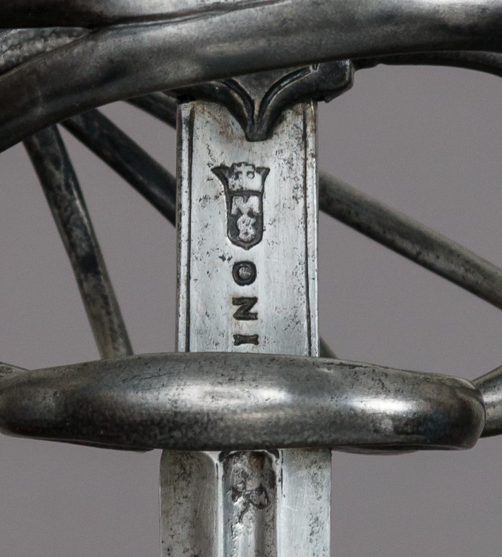

Originally Posted by fernando
My confusion, then; between famous Italian smith Pietro Caino (Milan) and swords made by masters from Caino (Brescia).
Exactly!
And this appears to be a general confusion not only yours.

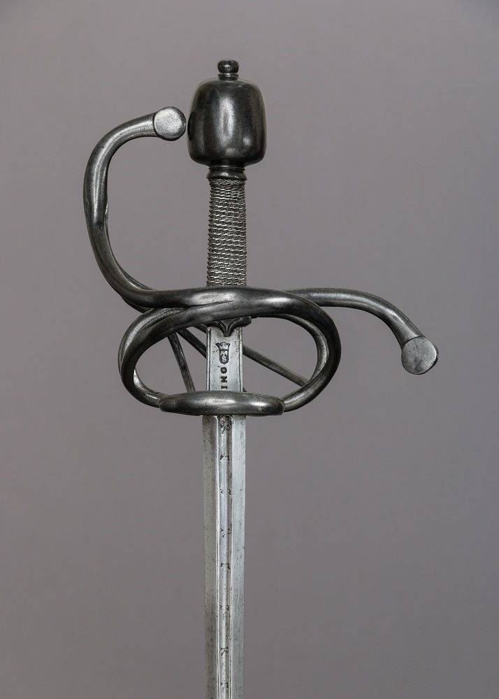

Then why would a "Pietro Caino" mark his blades with a crowned "S" or "MS" and not his initial letters?! (see the example in the Metropolitan museum)
https://www.metmuseum.org/art/collection/search/27437
Moreover, I could not find more detailed information about this Pietro Caino so I am wondering if he ever existed, or the "CAINO" marked blades are strictly referring to the city where they were produced (like the blades marked with "Toledo" or "Solingen").
To me, it appears that the CAINO marking on the blades indicates their city of origin, and the additional punched mark the initials of the swordsmith name, that unfortunately is now lost.

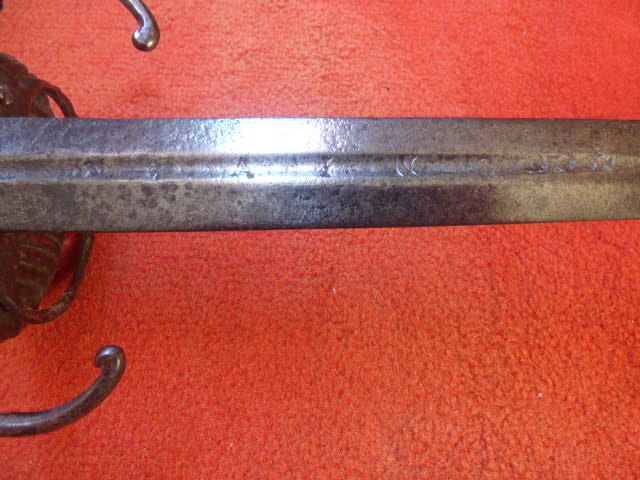

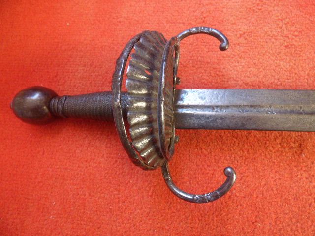

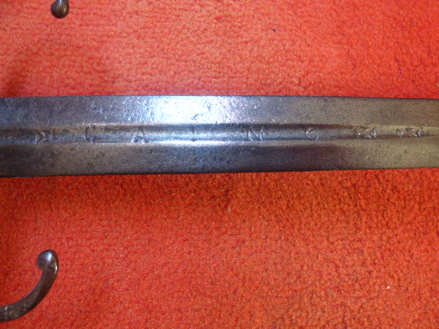

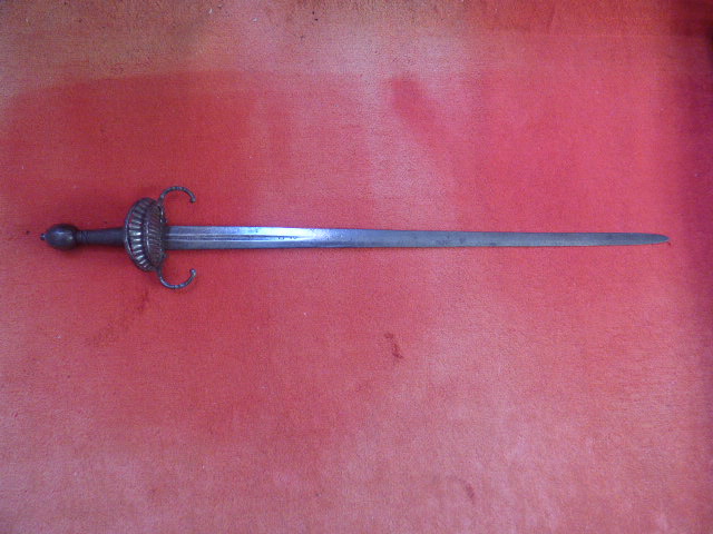

Not much help with information, I'm afraid, but here is my small contribution, another example - a 17th century crab-claw broadsword stamped CAINO in the fuller on both sides of the blade, marked with crosses before and after. I had always assumed the name to be the town of Caino near Brescia but it could well be the bladesmith. There are no other marks

As you note, the singular use of CAINO without other markings suggests more likely the place rather than individual maker.
I cannot help but wonder if perhaps Solingen used the 'CAINO' marking in the sense of 'brand' in the manner of 'SAHAGUM', ' ANDREA FERARA'.
I am not familiar with Solingen's use of Italian names(other than obviously Andrea Ferara as noted), marks on blades in this manner, as they profoundly did with Spain and Toledo, but it seems quite possible.
Would very much like to hear more on that possibility or examples of Caino blades known to be of German origin.

NeilUK
Join Date: Dec 2014
Location: Scotland
Posts: 126
Because the crab-claw hilt is definitely an Italian design I would suppose that the CAINO blade on my sword is a genuine Italian blade rather than a Solingen import. But nothing is ever 100% certain in the world of antiques!
