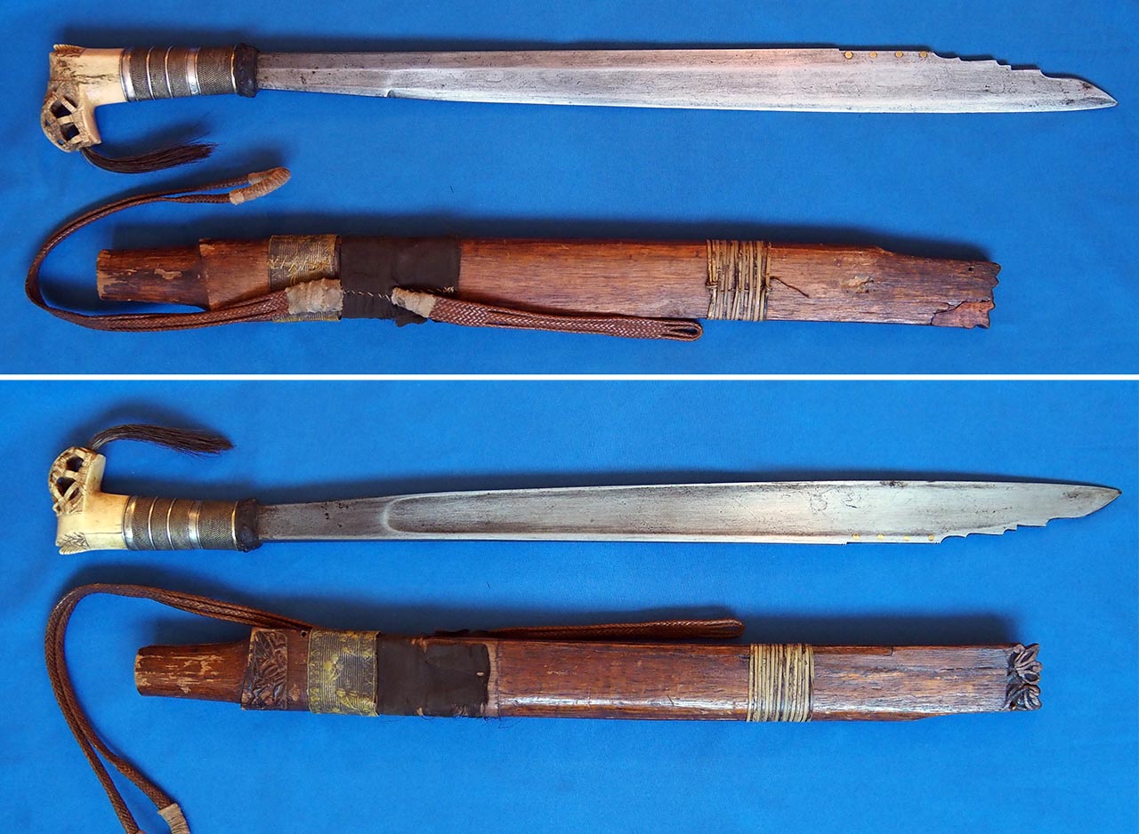

Hello. I know mandau are tricky but hoping to narrow this one down to more than "Dayak". I've seen a few photos with similar style carving but no attribution. The blade is a nice piece of work, simple for a mandau but very well executed. The silver on the hilt seems to be a bit unusual. Battara got a good look at this one when he rescued the scabbard from complete disintegration. The plug is synthetic, likely done as a repair by a collector or dealer unless anyone has heard of Dayak using synthetic materials. Photos from Oriental Arms.

Jeff, my knowledge of Dyak weaponry is slight, however using "Hornbill & Dragon" as a reference, I'd be inclined to give this mandau as Kayan.
As for Dyaks using synthetics, the old Dyak ways have been gone for a long time, even before the clearing and the palm oil plantations sent them out of the jungles, they were using modern materials to do repairs.

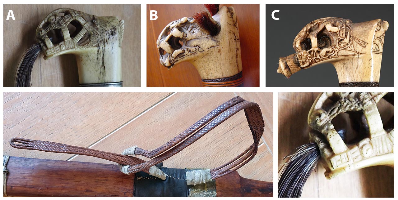

Thank you Kai and Willem for taking an interest! Yes this is my first mandau and one that I actually have with me (I've been displaced from home for the last 6 months). Happy to take more pictures of features of interest.
I've added a couple of what I consider similar carvings. To me these look like a hunched 6 limbed figure embracing the void of the bone cavity.
A. Is my mandau purchased from Artzi
B. Is from the 2006 post by Dajak
2006 post by Dajak
C. This is a random download from Google Image Search
I've also added a better shot of the belt and a zoom of the hair plug

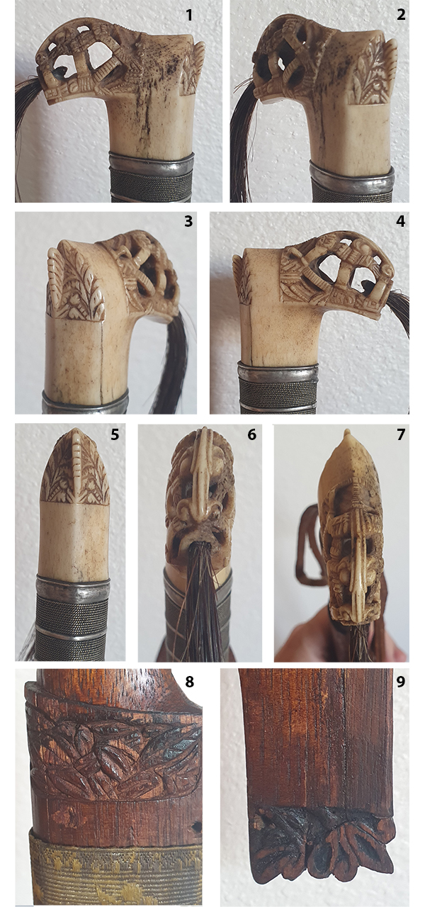

Some more pics from all sides of the hilt would be good. Also a closeup of the carving at the upper scabbard, please.
I'd like to establish if blade, hilt, scabbard, and belt were really worn together, too...

If we look at the comparative pics provided by Jeff in post #9, the outer shape might well hint at a relationship with the Modang; of course, these hilts were also very common in Kutai, another major center of commerce. While the sultans seemed to have tried to keep the "barbarian influences" at bay, Kutai mandau seem to closely follow the Modang aesthetics rather than prominently including Malay influences.
While I can't exclude this is a one-off hilt from Kutai, it might come just as well from any other Malay settlement throughout coastal Borneo - IMHO most likely Kalimantan Timur though (based on the similar hilt profile). Jeff's hilt does not seem to be recarved from such a Modang hilt though since some details are added features. Aside from replacing the typical spirals with the extensive hollowed-out open spaces, the apparent complete lack of typical Dayak motifs like open aso jaws or leaches is really striking (cp. with the traditional examples!); these have been replaced with geometric and floral design motifs.
This extends to the floral carvings on the scabbard. Obviously, the latter has lost pretty much all accoutrements which might have helped placing it...
The rattan belt is of really good craftsmanship and its style quite typical for Kenyah/Modang/Kutai. BTW, these tend to get dry and brittle, Jeff - I'd avoid bending it (it is missing a customable cord with toggle for closing).

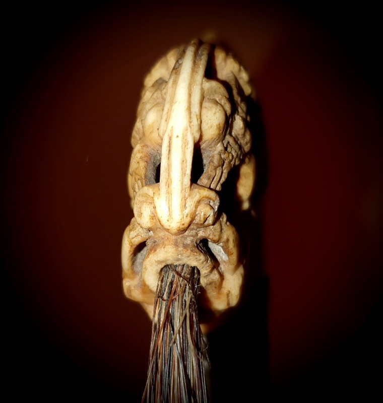

Fascinating stuff Kai. Thank you for the warning with the belt. It remains nicely pliable but that could change. Should I use some mineral oil to keep it in shape?
Mandau Dimensions
Blade: 55cm OAL: 63.5cm Width: 0.95cm at base
More detailed images:
