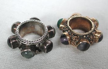

I'm inclined to lean towards Bali too, Alan, or what about Lombok? It could be my imagination but I think I can make out a ring-style mendak that you might find on keris from this area. Not sure what the correct term for these are, if not mendak.

The Balinese "keris ring" is called wewer or uwer, uwer is probably more correct.
Do you mean that "uwer", or "ooh-wer" ["ooh-wer" is how I pronounce the word Romanized as "uwer", stress on the second syllable; if this is not phonetically correct, please correct me, and quickly] is more correct with respect to proper Basa Bali usage and/or pronunciation than is "wewer"? Or do you mean that "uwer" is probably more correct with respect to how the word ought to be pronounced and/or written, in comparison to the manner it is written and/or pronounced currently? Could you post "uwer" in Aksara Bali, and in any other scripts you think might be pertinent (Kawi might be more understandable than IPA)? When I was about six years old, I gave up trying to convince Anglophones that there is a right way and a wrong way to pronounce and transcribe vowels.

As for pronunciation of uwer it is the normal, straightforward phonetic pronunciation, the thing most native English speakers fail to do, maybe cannot do, is to roll the "r". Indonesian pronunciation is a lot like Italian pronunciation.
As to usage, most people I know simply call it a keris ring --- cincin keris. But that's probably because Balinese people tend to use Indonesian with everybody who is not Balinese, as with Javanese, Balinese really needs to be learnt from the time one's feet are permitted to touch the ground, or maybe before.
My opinion on correct usage is because I've heard uwer used more often than wewer.I could be wrong.
