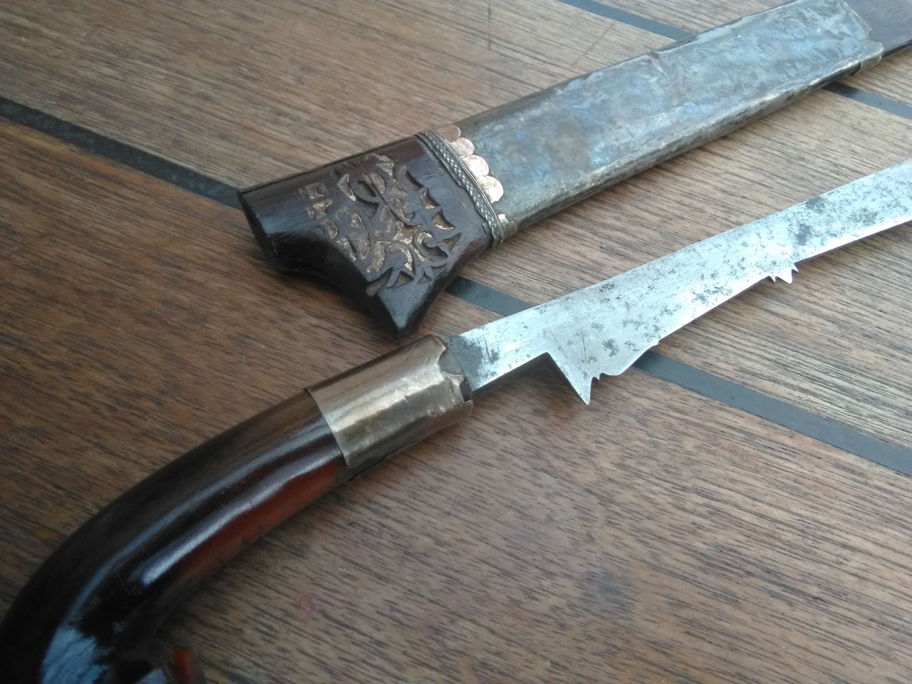

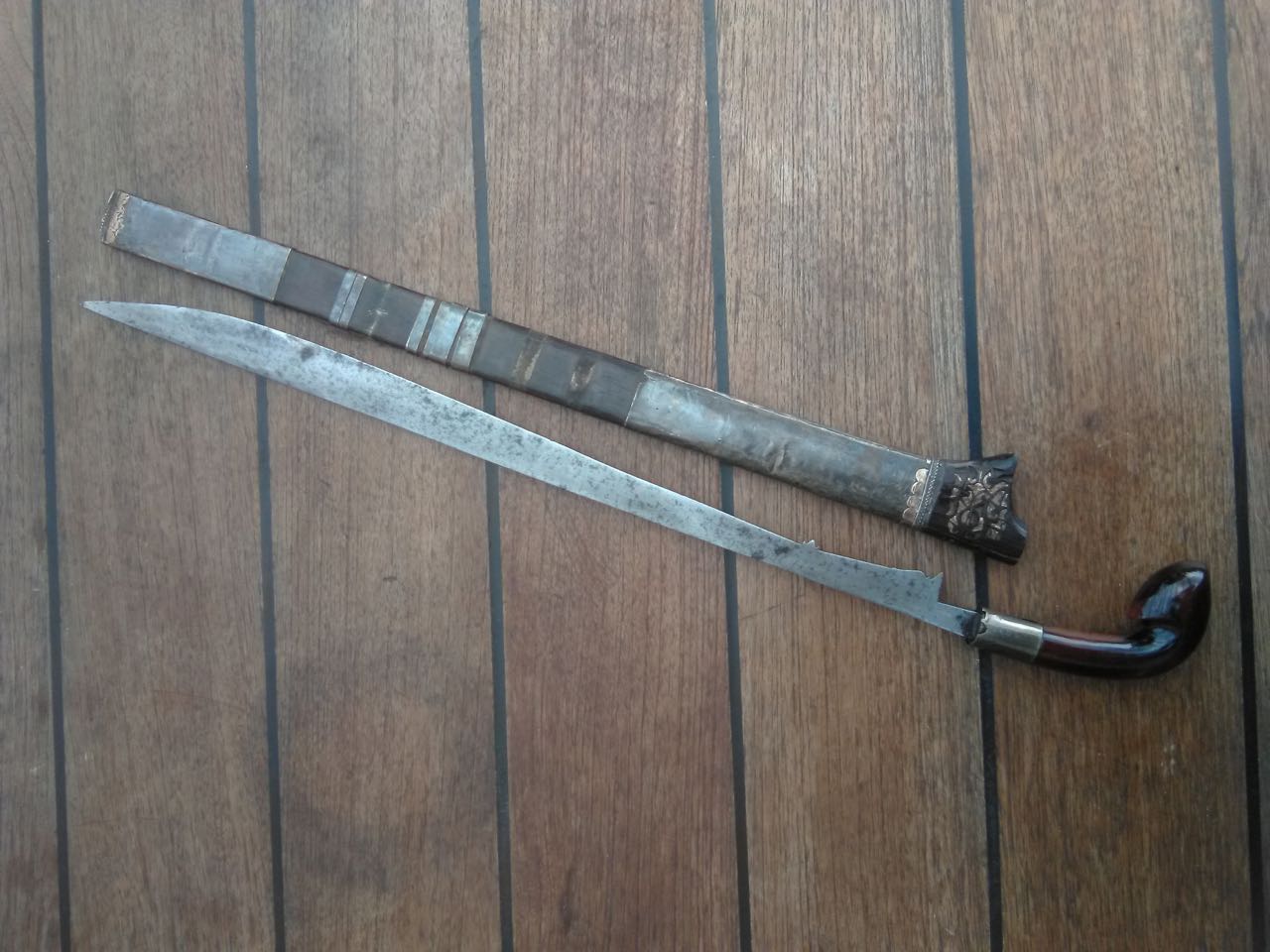

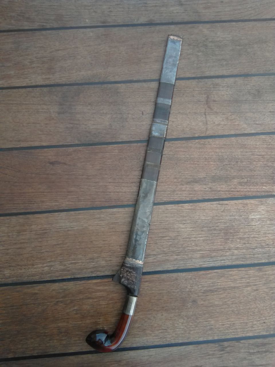

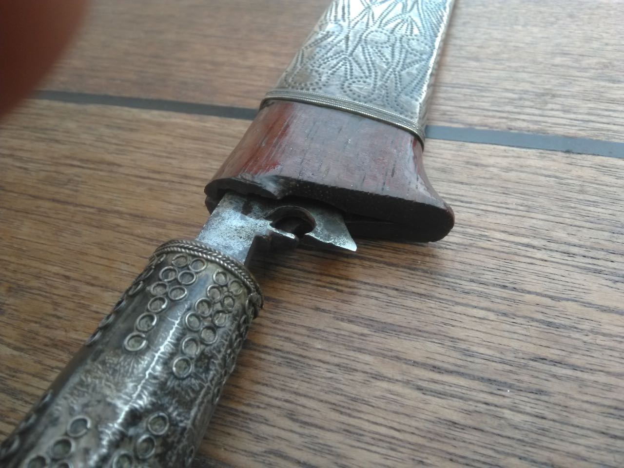

Here some pics of the scabbard-blade,
( Not fast, time to receive it + problems with my login )
I see what you mean,
sure it's not the same style but it fits pretty good in
I have a second one and if I try to put it in the second scabbard it don't fit at all
even if this blade is smaller...

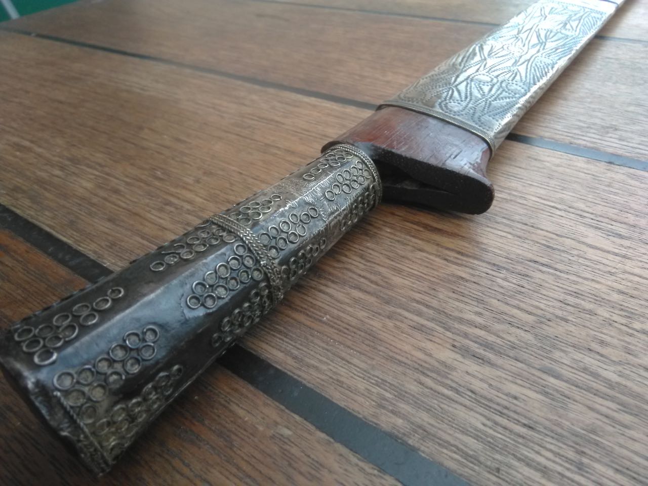

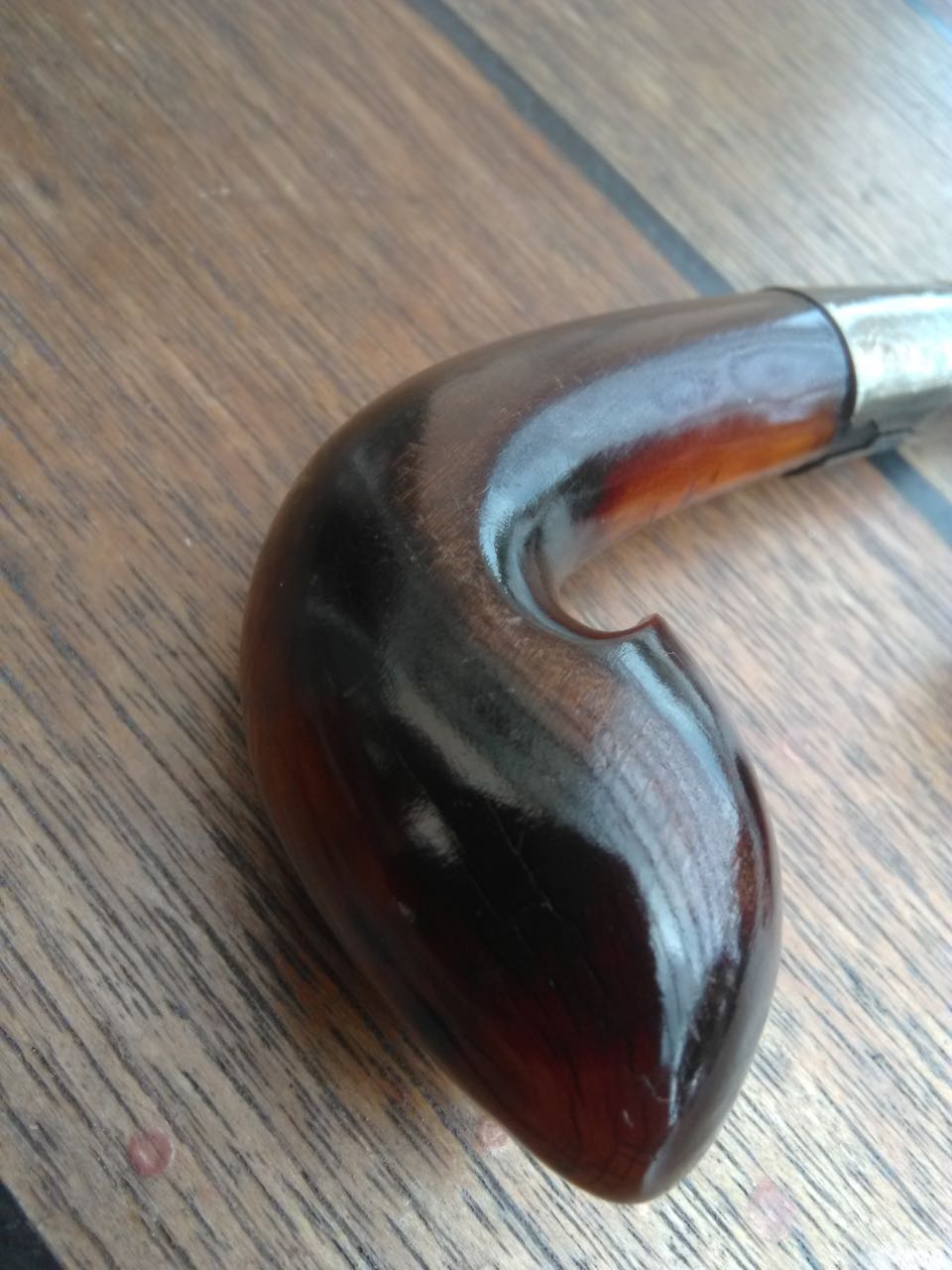

And the second kalasan ( now I know ! Still thank you Sajen !!! )
Nice hilt, sold as wood but clearly light horn.
A ( nice ) classical model ??
Kind regards

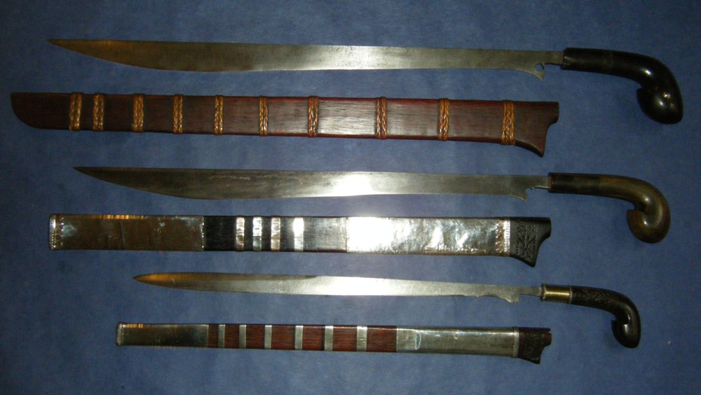

Posts: 9,736
A somewhat better example, the blade has an unusual shape and I like the very nice horn hilt!
Compare with my Batak knives.

Old 11th June 2020, 06:29 PM   #15
Posts: 9,736
Really nice items !!
Thank you!
How long is the bigger ?
( mine 60cm-23,6 inches long )
The one in up is 64 cm without scabbard.
I find my ''second one'' looks like the last on your picture.
Only the file work near the handle but the general blade shape is different and I doubt that this example from my collection can get called kalasan.
I have to clean ( not to much ) the silver parts
make it a little more shiny like yours
Batak silver seems to be very pure since it's get black again very fast.

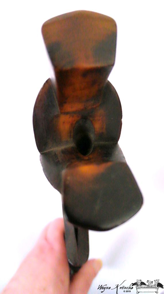

Posts: 4,285

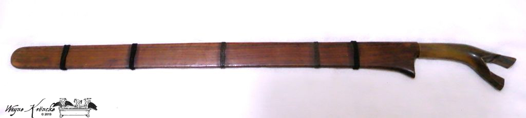

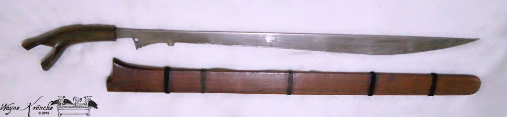

Another Kalasan, horn grip, Aceh style. tight well fitted scabbard that matches the sword. 24in. blade.
Hello Wayne,
It's Batak style, the Aceh style is similar but different in fine nuance.

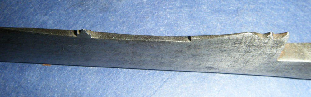

Here the file work at my andar-andar, the example in down.

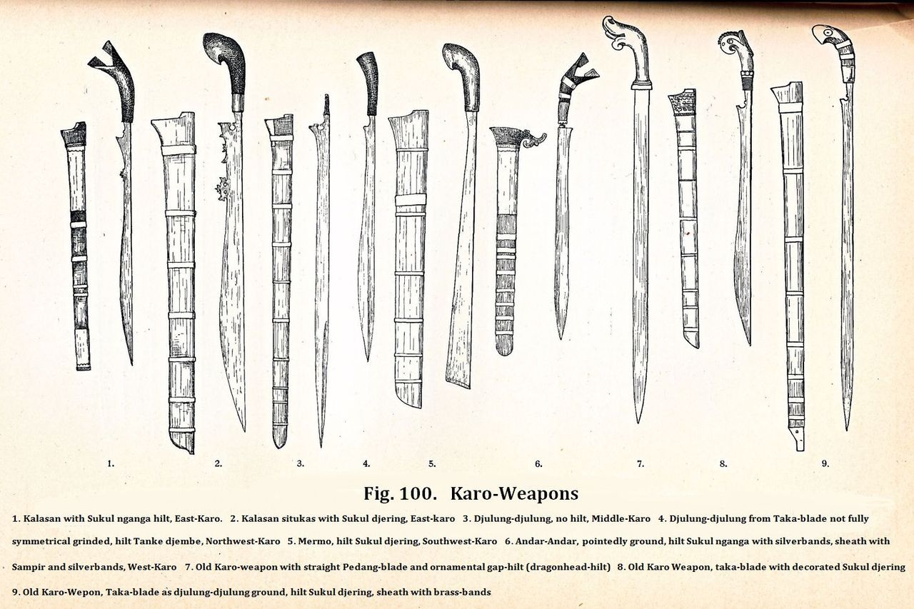

Old 11th June 2020, 07:00 PM   #20
Posts: 9,736
Thanks for the info.
Hi Wayne,
You can check it here by a drawing from Volz, tranlated from our member Roland.
Old 12th June 2020, 09:46 PM   #21
francantolin
Posts: 963
Thank you for the informative picture with the differents models,
So what do you think of my first model ?
original piece looking like the number four with Tanke djembe hilt
or a composite weapon with his all silver covered hilt and his matching scabbard with really different decorations/patterns ?

Old 13th June 2020, 10:22 AM   #22
Posts: 9,736
or a composite weapon with his all silver covered hilt and his matching scabbard with really different decorations/patterns?
Looking at the patination I would guess that it's original, maybe the hilt get renewed long time ago. I personally like it and would be glad to add it to my own collection!
