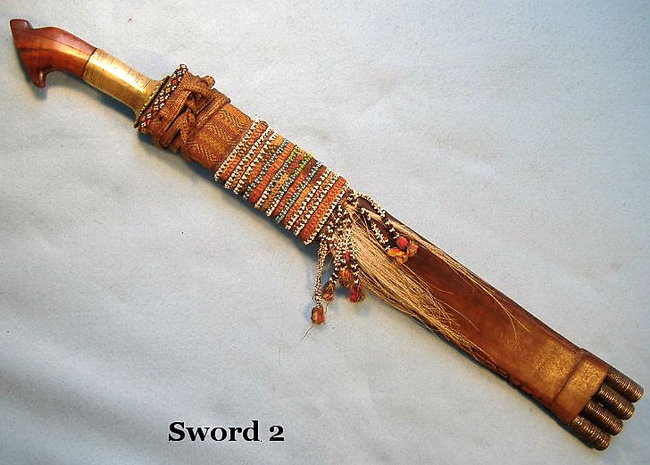

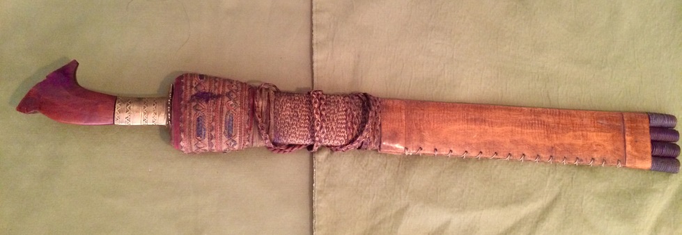

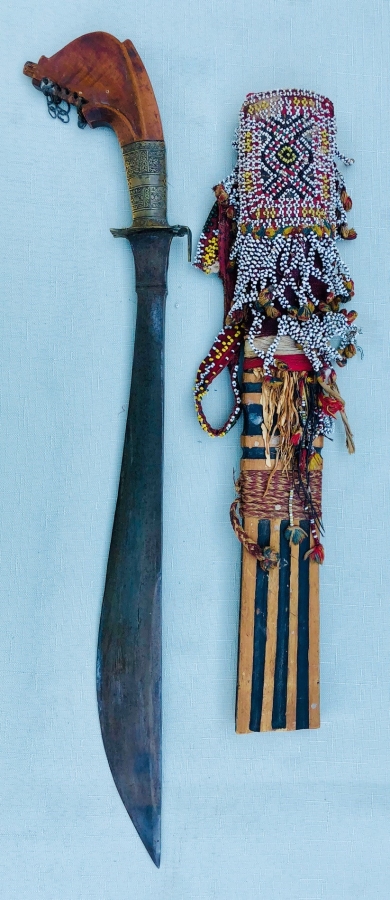

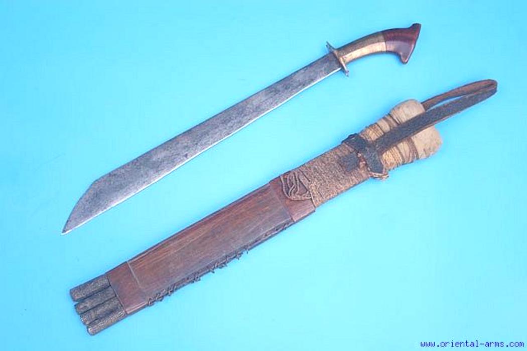

Hello Yves,
I would say yes, it's a Bagobo bolo/kampilan. See attached pictures taken from other threads, not my ones.
Originally Posted by tanaruz
2) issues: I soaked it overnight on white vinegar and in the morning, most of the rust just melted away- except for some areas on the blade (blackened areas) I was trying to distinguish if these spots are pitted areas, and yes, there's little pitting. But why is it the rust won't go away? what's best to remove this? would sanding help?
It simple need a longer soak, there you will have later pitting I guess. When you sand it you will need to sand the complete blade, a time consuming undertaking, most of the time worth the effort.
3) what handle design would fit this lovely piece have when it was pristine?
Look again to the attached pictures, there will be other examples in older threads. But most Bagobo swords I've seen with such a scabbard have had handles like the shown examples.
4) I have noticed that the tang is a bit short?
Indeed! But can't say something about this, never before I've seen a Bagobo sword without handle. Look the tang broken? A close-up?

Hello Craig,
I know that you collect Lumad blades and guess that you are better informed as I am, would you call the three above shown examples also Blaan swords?

Hello Detlef,
I would actually think of the pieces you've shown as Blaan. That being said, I think it's important to recognize that the sword itself and the scabbard are two different things and often have very different origins. One might also add the hilt as a seperate consideration as well. Due to trade, battles, repairs, inter-marriage, etc. these three elements of any piece might take on a mix-match appearance. The Tboli, Blaan and Bagobo (more knowledgable collectors may also include the Kalagan,Tagakaolo and others) all interacted and still do. The Tboli and Blaan very closely, similarly the Blaan and Bagobo. Each have very distinct and identifiable elements to their weapons and scabbards, however each often carry a blend as well. I have relatively little knowledge of the blades themselves and certainly many of these were Moro in origin. The hilts and scabbards offer more clues to me and these old photos, taken and notated in situ can offer unique insights. I think we're all relatively confident when we see a 'true' Bagobo piece with its specific hilt, scabbard and blade design. A distinct Tboli hilt and scabbard is hard to miss as well. For me, the distinctness of the Blaan is found in the scabbard and the elegant yet simple hilt.

Yves:
Your blade may well be T'boli based on the shape. Their tok, or more precisely kafilan, often have these shaped blades. If so, then you are in luck because the T'boli blades are generally very good and renowned for being well tempered, sharp and durable. The hilts on the swords shown in Detlef's post (#2) are most likely Tagakaolu/Kaolu or from a closely related group (e.g., Kalagan). Your incomplete scabbard is not typical of Bagobo work, and could well be B'laan (but hard to tell from the pictures).
The short tang is not necessarily broken. Close up pictures would help, but I think these relatively short tangs tend to be the norm. I've only disassembled a few Lumad hilts, so I really have no good idea of the length of their tangs.
