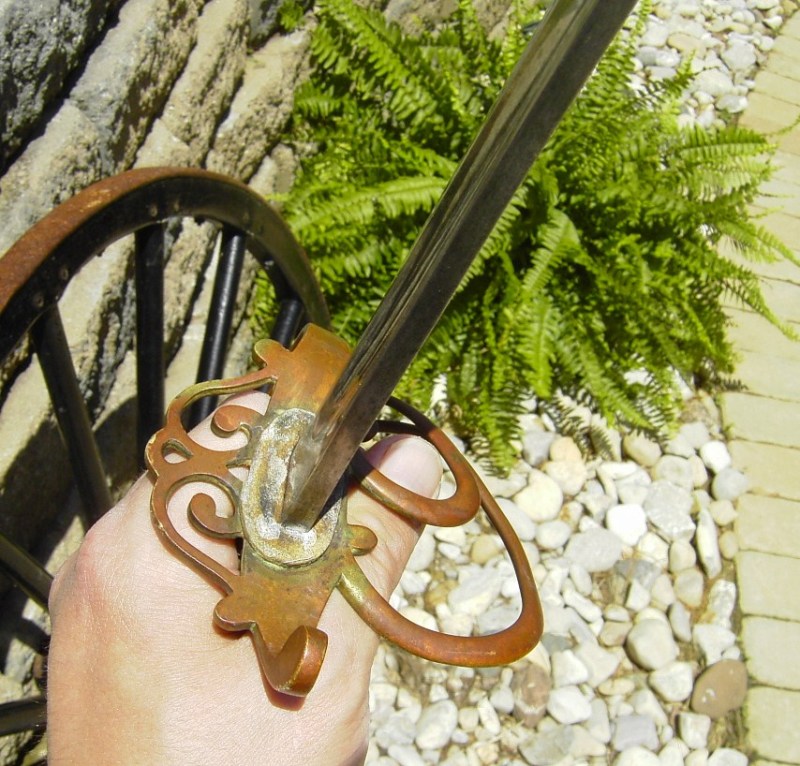

Hi. I am new to this Forum and am hoping to help my friend identify a sword that he was told was an Austrian Infantry sabre from the mid-1800s.
After trying to do my own online searches, I have been unable to figure out what this sword actually is. From what I have seen online, I get the sense that it is European (Austrian, German, French???) and is likely from the mid-to-late 1800s, possibly into the early 1900s, but I am new to the world of swords (I did recently buy an 1860 Cavalry Sabre from the American Civil War, so I guess I have finally entered into world of sword collecting).
Due to COVID, I have not been able to see my friend’s sword in person. He showed it to me via a video chat, and the pictures I am about to display are screenshots from that video. So, the quality of the pictures aren’t the greatest, but I can get better pictures later if needed.
The guard of the sword has a distinctive shape, which I hope will be enough for you to pinpoint which model of sword this is. There are no markings anywhere on the blade or the scabbard, other than a “181” stamped on the pommel and the tip of the scabbard. I don’t have a good picture of the scabbard, but it is brass and black leather (brass at the hilt, more brass about 10-15 cm further below, plus brass at the tip).
If you need any other information, please ask and I’ll get you answers. As a member of other Forums, I know how helpful everyone can be….so I will thank you in advance for all your help!
Again, apologies for the sub-standard pictures!

Very blurry photo's and too much hand, not enough sword. You might be lucky, but it would be better to have clear pic's and taken in the manner of a police ID set. Full face, left profile, right profile etc.... However, I am getting a British vibe from what I can see.

I agree the photos are blurry, but the guard is very clear to see. Wouldn't that be the biggest clue?
In the meantime, I will ask for photos. Thanks.

What I can say is that this sabre is probably not French, German or Austrian, but perhaps British.

Thanks for your opinion. We have two opinions that match (British). I started looking online at British swords from the 1800s and I can definitely see the similarities.
The information from the Forum has already proved useful! Hopefully, we can get this identified...that would be really great. My friend has had this sword for 40 years and he never really was sure of what it was or how to even find out.

The sword looks very similar to British 1821 Pattern swords. Does that help at all?

I agree with the consensus here, pretty likely British, and that brass hilt conforms to various British patterns of mid 19th c. typically infantry, and other units officers swords . It is heartening to see photography that makes my own look almost discernible .......but great post!

I would go with it being a Royal House Guards type sword as being a possible match
is the blade straight and does it have a bulbus bit at the top (google pipeback sword and you will see what i am referring to)

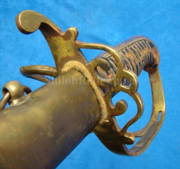

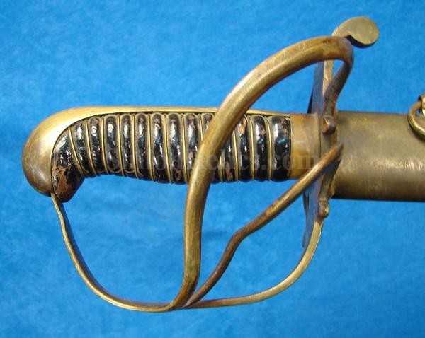

This appears to be a late 19th century Massachusetts Ancient&Honorable Artillery sword. Some were marked to Allien&Co. of New York. Others by Ames. No doubt, there were likely other groups buying these. These appear in the Ames catalog reprint.
There are multiple threads elsewhere.
A book regarding the society
https://books.google.com/books?id=q5hoNuEJPMoC
This is the Americanized offshoot going back to colonial years and borne out of the English artillery.
Cheers
GC
images with blue background courtesy of Shiloh Relics and a past sale.

Wow!! Incredible! I actually was starting to think it would be unlikely we'd ever find out what it was. As I searched online, it became obvious to me how many similar looking swords exists, so many variations on a theme.
I had hoped the guard was distinctive enough, even with the poor quality photos.
Thank you. I will let my friend know. And now, with the sword name/manufacturer in hand, I'll do a bit more research online and see what else I can find out about it (e.g. the 181 stamp...is that an inspector's marking?) I'll save any further questions until I have done my "homework" on this.
Unbelievable.....which begs the question, how is it that you know about these swords?

The 181 most likely a rack number. As to how I spotted it, that goes back to about 2006 and a somewhat different and much older sword. Once IDed, it has stuck in my mind ever since.
The US swords were indeed a nod to British fashion but even this pattern was superseded a few decades later after WWI. That might explain how these do turn up on the market and no longer "on the rack" (see b&w photo from the book).
I have been more or less retired since 2004 and have spent much of my time looking at and collecting swords.
