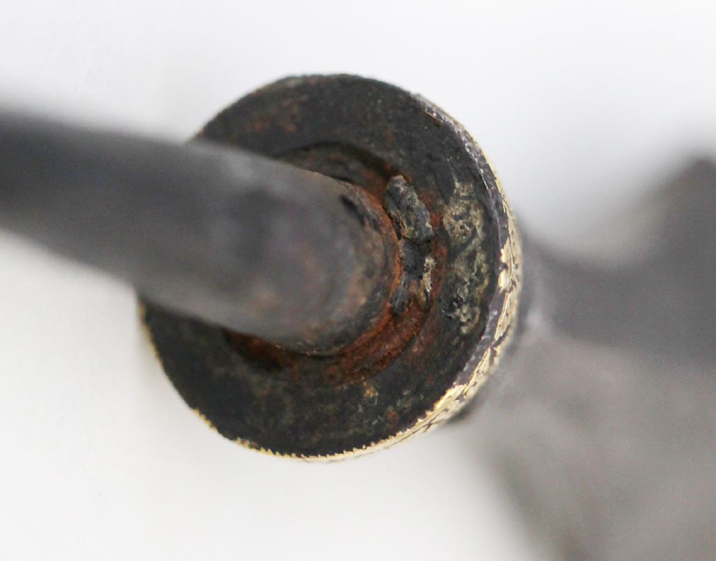

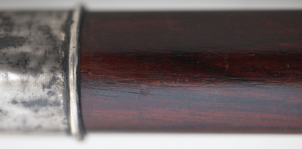

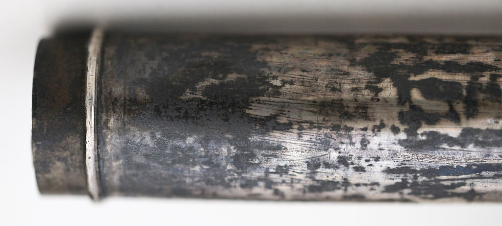

I had promised in another thread to post a picture of a spear whose thin white metal sleeve with rolled edges located over the shaft below the spearhead was similar to the sleeve on the scabbard of that keris cuntrik. (Despite the similar appearance, the sleeve on this spear tested as high grade silver with appropriate traces consistent with refining residues in 'antique' silver, while the keris cuntrik sleeve was white brass.)
The length from the tip of the spearhead to the base of the high karat gold decorated ferrule is 18 inches. (The silver sleeve on the pole measures 13 inches; otherwise, the pole is smoothly finished plain dark wood.)
I liked the aesthetic and workmanship of this spear and paid dearly when I found it at a Japanese sword show declared by the seller as Middle-Eastern, but knew that was wrong when I bought it and I have assumed it has come from one of the cultures in Indonesia. I would appreciate any help with more precise localization of it origin and thoughts about its age..

Hello Lee,
Thanks for showing this - seems we currently have a welcome flurry of spears!
This is certainly Indonesian, most probably from the Jawa/Bali nexus.
The methuk at the base of the blade seems to be separate, isn't it? I hope Alan can comment on the hemispherical shape.

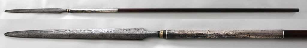

Please post more pics of the whole spear!

A very nice spear, I am with Kai, Java or Bali IMVHO. I like the good gold kofgari. Also would like to see the complete spear.

Thank you, gentlemen. The methuk is separate and also solid - this is fairly obvious looking up from the tang in the area usually hidden by the pole. It has been very carefully fitted to the spearhead with the very inconspicuous join apparently being just beyond the undecorated groove. The blade end of the pole has a ferrule appearing to be made of brass before the rolled edge of the silver sleeve.
I will provide additional images, as requested, when an opportunity with appropriate natural light presents itself.

Amongst the old school collectors of Central Jawa during the late 20th century, a major indicator for tombak classification was the metuk.
The metuk on this tombak under discussion is the form attributed to Buton province in Sulawesi.

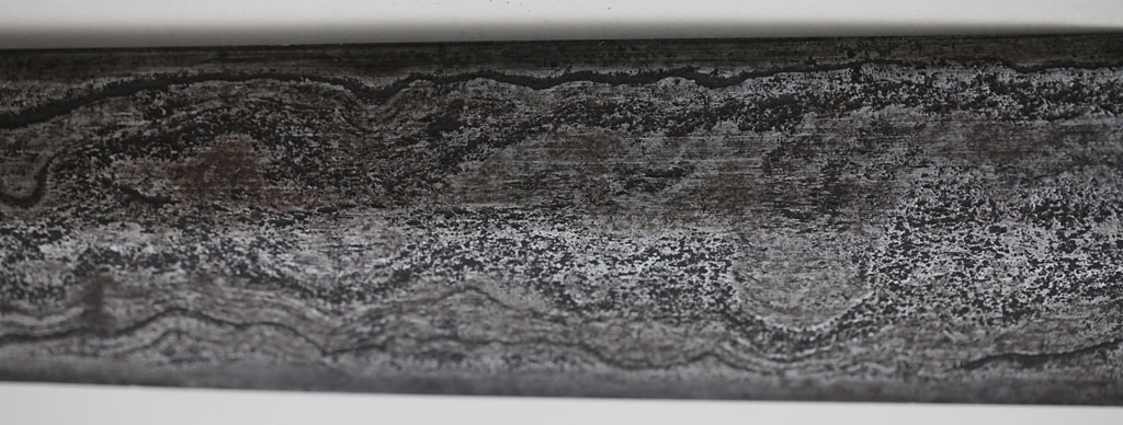

The blade itself I'd prefer to reserve comment on, it is similar in some respects to a Javanese form, but there are insufficient indicators present for me to form an opinion I could defend.

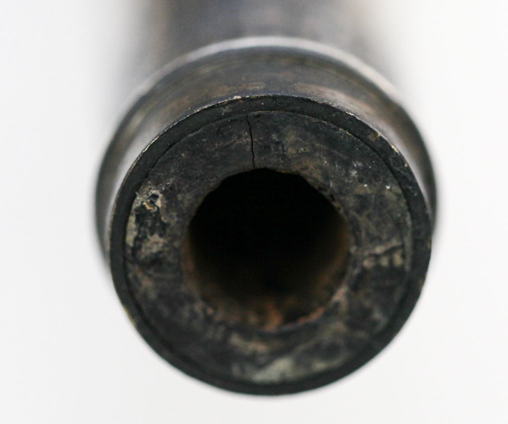

Details of the landeyan (shaft) might assist.

The overall length is 81.125 inches. There is no finial or treatment of the end of the shaft, nor evidence of one previously.
Here are some additional images:
