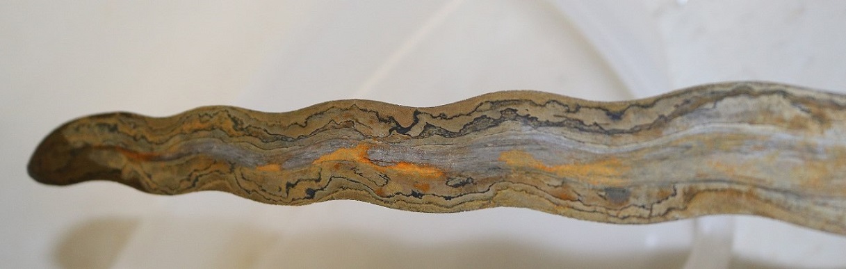

Hi, can anyone share opinions & possible origins about this moro kris based on its style and form?

There is a separating line that seems to be real rather than merely engraved. From the pic, I can't see how the angled part is designed. Larger pics would be needed for verification and estimation of age. Dimensions would be good to have, too.
The blade probably is Maguindanao; the hilt might point towards the upper Cota Bato region.

I agree with Kai. A Maguindanao example, but age is hard to tell. The blade needs a good clean. Looks as though you have some active rust in places that needs prompt attention. Etching the blade might show a nice pattern but hard to say from its present appearance. Look forward to seeing more pics after you've had a chance to work on it a bit.

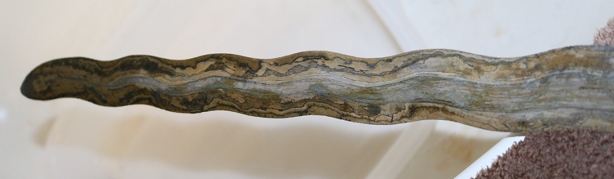

I am currently submerging blade alone in vinegar diluted to 5% acidity in a vertical tube. I am noticing black color forming along both sides of blade. The middle section still had original color intact. Is this damage or normal?
How long should I keep kris in this solution?

The dark edges are normal: The steel “slorok” will react quite strongly with the vinegar.
Make sure not to overdo the exposure: At this stage, it’s best to remove the blade repeatedly, thoroughly scrub it and search for remaining specks of rust which should be loosened manually. Soak again and repeat the process until no more rust shows up. Try to keep soaking time short and some gentle polishing in between won’t hurt IMHO.
Let’s see a pic taken with flash when you believe you’ done!

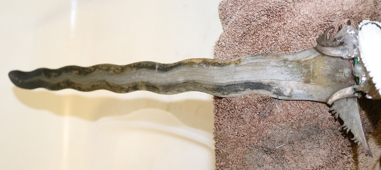

What are some signs of corrosion to the blade for leaving it in too long in 5% vinegar acidity?
I noticed the tip of blade has some split in the center. It may have already had that condition however. I did not notice til now.
But are there other signs of corrosion or over exposure has occurred?

I would remove the blade from vinegar at this point. Rinse it thoroughly in plain water. Wipe it dry and apply a light oil. From here on I would use sand paper only. Start with nothing coarser than 200 grit. Then move to 400 grit and then 600 grit. Wipe the blade regularly with a clean cloth to remove residual particles. Rubbing with abrasive paper will remove any remaining oxidation and polishes the blade to a smooth finish.
After removing the blade from the vinegar it should be apparent if you have any lamination, hardened edge, etc. Signs of these will disappear as you polish the blade. If you wish to show those features again, you will need to etch the blade again.
First, clean off all the oil on the blade (I use propyl alcohol). Then for final etching, I prefer diluted ferric chloride solution although lemon juice works well also. (If the etch looks brown you have left it too long--repolish the blade and start again). After obtaining the desired features, neutralize the acid with baking soda, rinse thoroughly with clean water, dry gently, and again apply a light coating of oil to the blade. Instead of oil you could use a silicon-based wax--I use Renaissance Wax.
I believe I can see the forging flaw already in the pic you posted originally.
Hairline cracks and pitting are not cleaned by surface grinding/polishing (unless removing heaps of metal). That's the pro side of vinegar - it helps to really clean a blade thoroughly!
If any pitting or cracks are deep, it will take time and repeated picking of stubborn areas to really clean them out. Depending on the extent of corrosion, the blade may look quite bad (not expected with this kris); however, a thorough cleaning will do much for long-term conservation (if stored properly) and remaining craters/cracks can be filled with hard wax to seal them off.
The surface will get somewhat dull from vinegar or other acids (or even porous if you over-clean). The more you invest in careful manual removal during the initial cleaning/etching, the easier is the polishing afterwards which will get the metal shiny again.

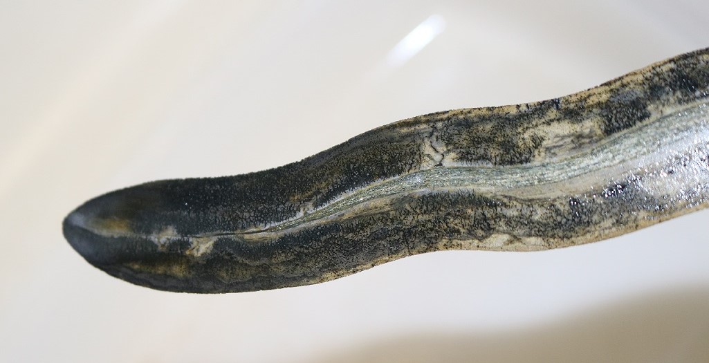

I have left the blade in a vertical bath of 5% vinegar for a couple days and tried to clean it a couple times by running water over it and scrubbing.
The dark smudge develops really fast after resubmerging in the vinegar. It develops thick again at both sides, and when I take it out of the bath to rinse it off with water and scrub it smells REALLY RANCID AND PUNGENT!!!! (Is it a toxin or hazardous to inhale)? My mind may be going overboard, but I wonder if it's arsneic or something? Any way, I was scrubbing it with a plastic brush very hard with citric dish soap thinking it will scrub the black smudge away, but it didnt seem to do much.
Then I realised that the black smudge actually fades away when the blade dries. The last photo shows what it looks like when it is almost completely dry. Is the rust not being removed or am I making some progress?

Uh..........maybe a little over etched. You may want to repolish and etch with a little distilled water, or don't leave the blade in that long.

I think that we don't see an intended etch, it will be the result of the bath in 5% vinegar solution to loosen the rust.
That's what I said before, the blade need to get polished anyway after the bath. The blade wasn't corroded so much that the bath was required.

I agree Detlef. This blade needs some sand papering and polishing, then a final etch. The red area in the bottom picture is active oxidation that needs rubbing off also.
