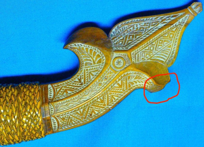

The repair looks great Battara. Will you repair the broken part of the top of the pommel?
Looks like this was very difficult.

Yes this was very difficult and time consuming. By bottom part of the hilt I assume you mean this:
