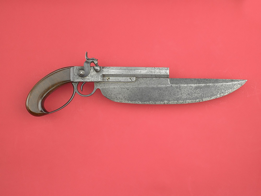

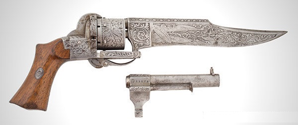

This is of course VERY unusual, and the first thing I think of is the notably unusual Elgin cutlass pistol of 1838.
The Bowie knife had of course become enormously popular after the Alamo (actually before that with Bowie's notoriety) and in 1837 G. Elgin filed a patent for the Bowie knife. Right after that he decided to create the cutlass pistol..which had a .54 cal. boxlock pistol with a Bowie blade attached.
Apparently there were only 150 of these made and a number issued to the US Navy. C.B. Allen of Springfield, Mass. was the primary producer but Morrill, Mossman and Blair were other contractors as well.
These as far as known were never really used but some were taken on a naval expedition.

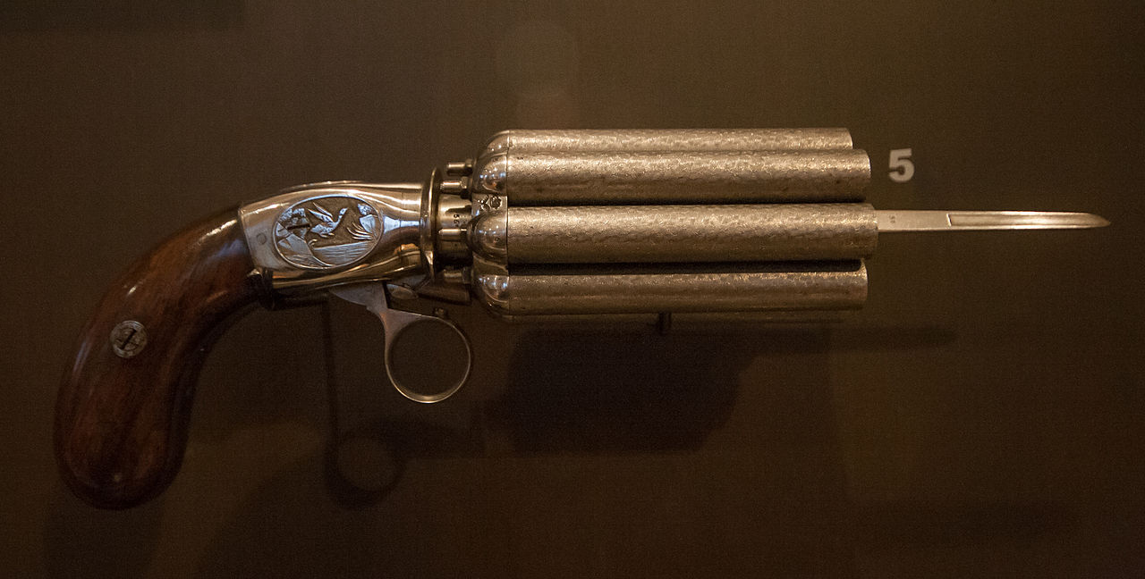

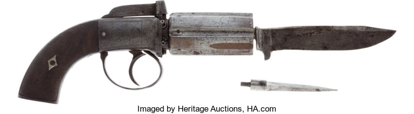

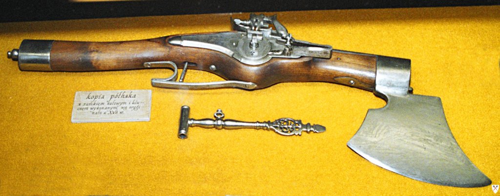

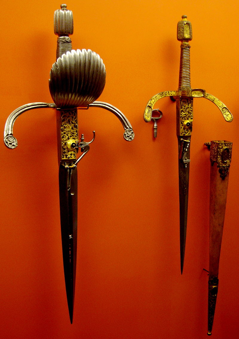

A great subject ~ I looked up a few blade and gun combinations as below and at https://en.wikipedia.org/wiki/Pistol_sword
The weapon with the axe is Polish.
The stiletto dagger combination is German
The One with the duck motif is Belgian.
There are some interesting references and one book looked especially inviting I thought..

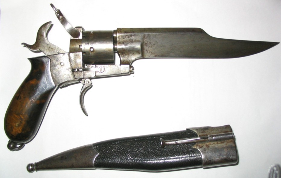

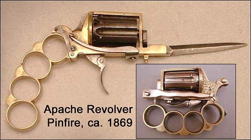

With combination weapons, as mentioned, Elgin contrived his combination gun and cutlass in 1838, but later, in 1869, Louis Dolne of Liege came up with a combination knuckle duster, and 7mm pinfire revolver which was also mounted with a small knife/bayonet.
This odd combination was not particularly lethal, however it was 'impressive' and later popularized in turn of the century Paris by gangs of street toughs known as 'the Apaches'.
The combination of gun and edged weapon was hardly new, as well noted by Ibrahiim in his entry, and for example many 'hunting swords' (hirshfangers) were mounted with pistol actions in earlier centuries. In India, armourers were always coming up with imaginative weapons to impress prospective clients and the patronage of princely figures.
That is what I suspect this intriguing example you have posted may be, and the arms of Liege often became available in India through British forces and diplomatic exchanges along with the volume of other arms.

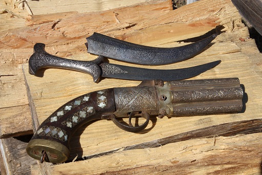

Thinking of Jim's suggestion for this possibly been a setup made in Afghanistan, due to their duplication ability, i notice technical details that would never cross my mind would be object of their 'skilled' smiths attention, namely the Liege type engraving on the cylinder, the way screws are inset on the stock and the preoccupation to stamp an assembly number (#4) in all parts.
Also interesting that we can see out there (in a blog) a rusted example similar (equal) to the one posted, said to be found in a remote land, under the skeleton of a pirate. Go figure !

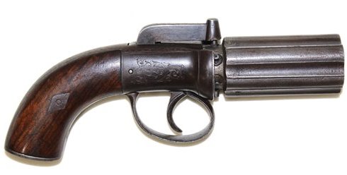

To my suggestion that pepperbox revolvers were known in Afghanistan and thus duplicated is seen in this Afghan made interpretation, with the usual added decoration typically on jezails.
As noted Phil's example does seem to be a Belgian made pepperbox .

... To my suggestion that pepperbox revolvers were known in Afghanistan and thus duplicated is seen in this Afghan made interpretation, with the usual added decoration typically on jezails...
Notwithstanding those decorations have no European touch, like Phil's example; still i agree this as obviously being a pertinent approach.
...As noted Phil's example does seem to be a Belgian made pepperbox .
Jim, the way i have read you, you were inclined towards both Belgium and Afghan possibilities.
And while i still consider this to be an European (Belgian) born pistol, i will also have to admit that the blade has undeniable Asian traces.

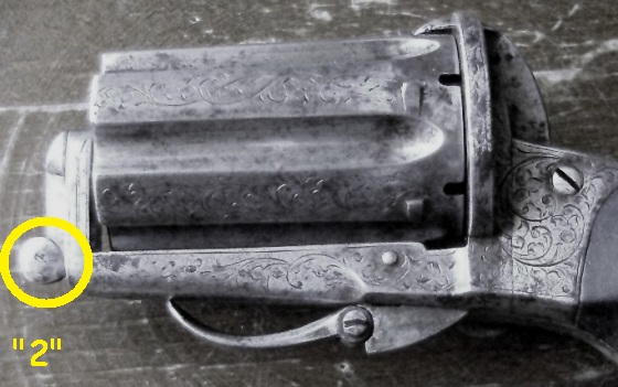

Would be a far too long shot thinking that this pistol had its disassembly screw lever modified to support a cut down talwar blade ... either before departure from origin workshop or afterwards, as per owner's design ?
On the other hand, it would be interesting to know from Phil which particular parts are marked with the "4"; if not for something else, still good for perusal.

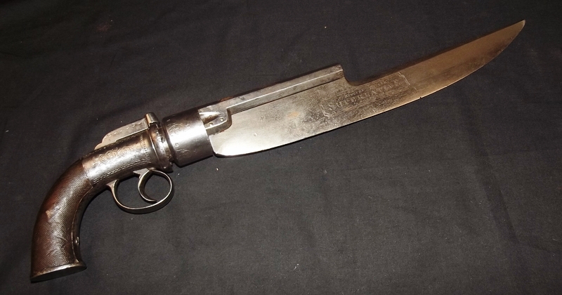

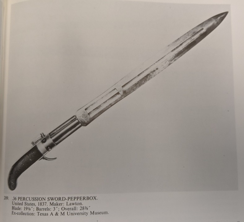

FWIW, I reviewed my copy of Blades and Barrels, and there is only one pepperbox sword in the book. It was made by Robert Lawton under US Patent number 481, and it does not resemble your sword.
There are several other revolver swords in the book, but not similar to yours.

Goodness , artillery 1832 sword blade on that example .
ill check on the '4' stamps when i get home tonight and post
cheers
Phil

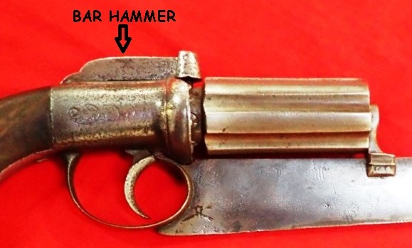

If we look at Phil's gun, the ignition system is the one perpetuated by Allen Thurber, known as 'bar hammer'.
With this acknowledged, you browse the net for Liege pepper boxes with this system and, what we find is that, the Liegeois were not (at all) fond of such percussion system for their 'poivrieres', and what pops up is a massive number of bar hammer pepper boxes made by ... British; and still a recurrent number of versions consistent with the possibility to support a blade ... even one inspired by the same muse.
Old 9th August 2019, 05:22 PM   #14
Posts: 10,864

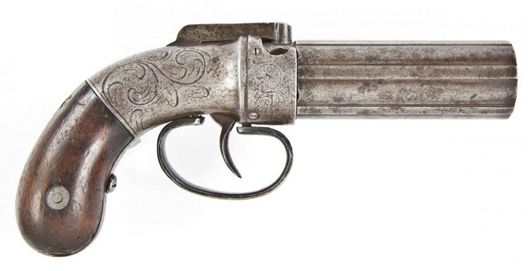

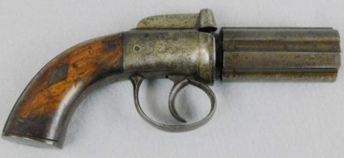

While unsure if I am among the blind, I am unclear of what is being illustrated here, and admit I am entirely trying to learn in these discussions so trying to see.
It seems that 'pepperbox' revolvers had been produced in England in the 1830s evolved from of course many years of multi barrel innovations. For some reason, in my limited experience, the British examples I have seen were not marked by the makers.
I am wondering if this may have had anything to do with the propensity of the exposed percussion cap nipples causing multiple discharge and gun failure if not injury or worse to user.
Actually the American versions were indeed often called 'Allen' pepperboxes as the patent holder was Ethan Allen (1837) however his partner Charles Thurber was included in the name Allen & Thurber on the revolvers.
I am quite unclear on the 'bar hammer' term which is suggested different from other pepperbox revolvers? I had thought this notable bar type hammer was present on these overall. That is the case with the British and American examples I have seen personally and in research. Clearly the type of gun has been produced in Russia, Sweden and other countries.
I was not aware that Belgium (Liege) did not care for the ignition system on these (though with the misfire and multiple ignition cases understandable), but it seems they produced 'knock off's of virtually most guns regardless.
The Allen & Thurber pepperbox (illustrated) is the same revolver used by Joseph Smith in Carthage, Illinois in 1844 as he was attacked and assassinated. Apparently he fired with three chambers igniting and three misfires. The gun itself is in the Mormon tabernacle in Salt Lake City, Utah.
I am curious if the 'bar hammer' used on Allen& Thurber and various British pepperboxes is somehow different than on some other pepperboxes.

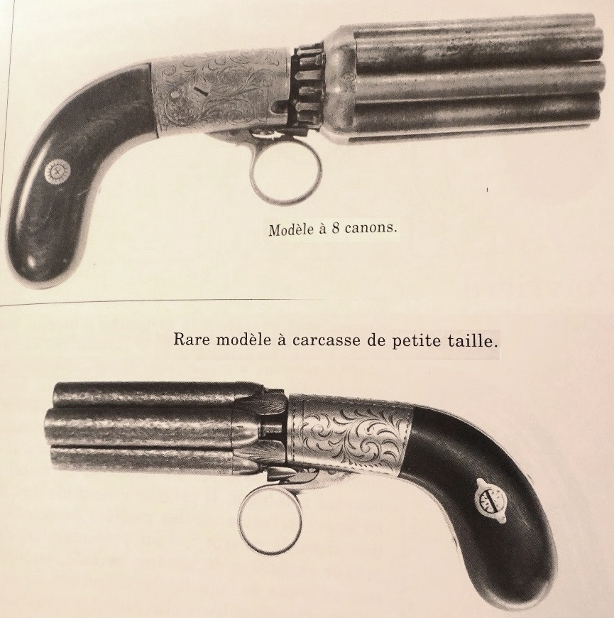

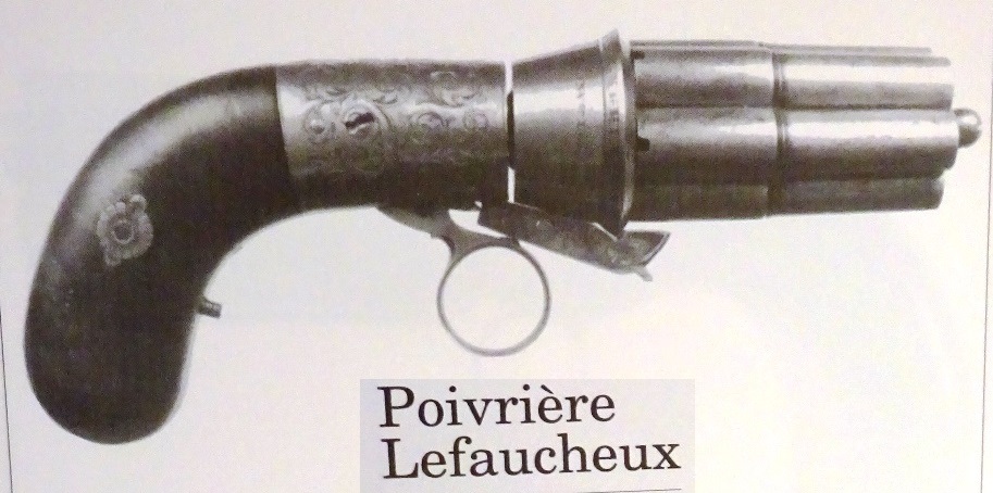

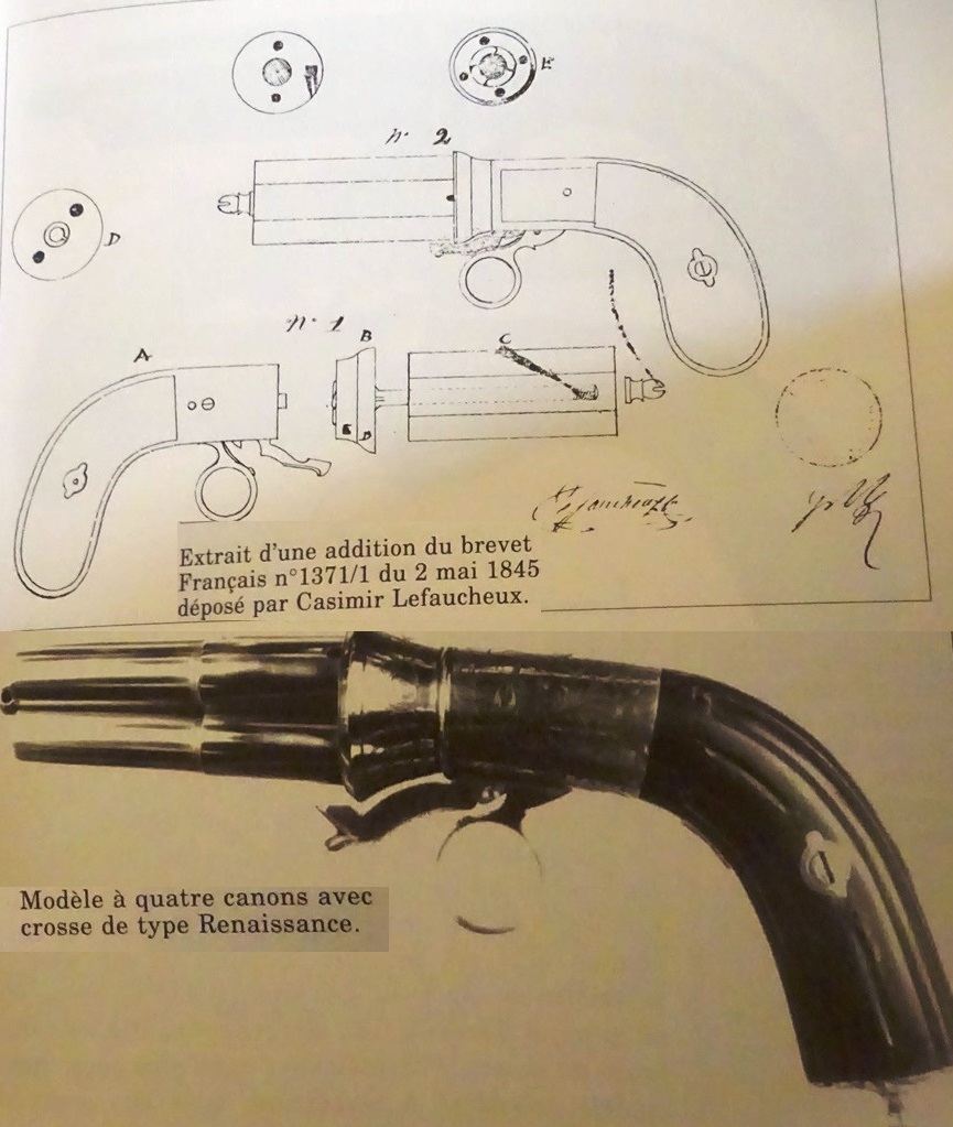

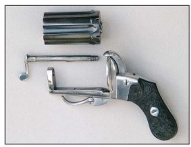

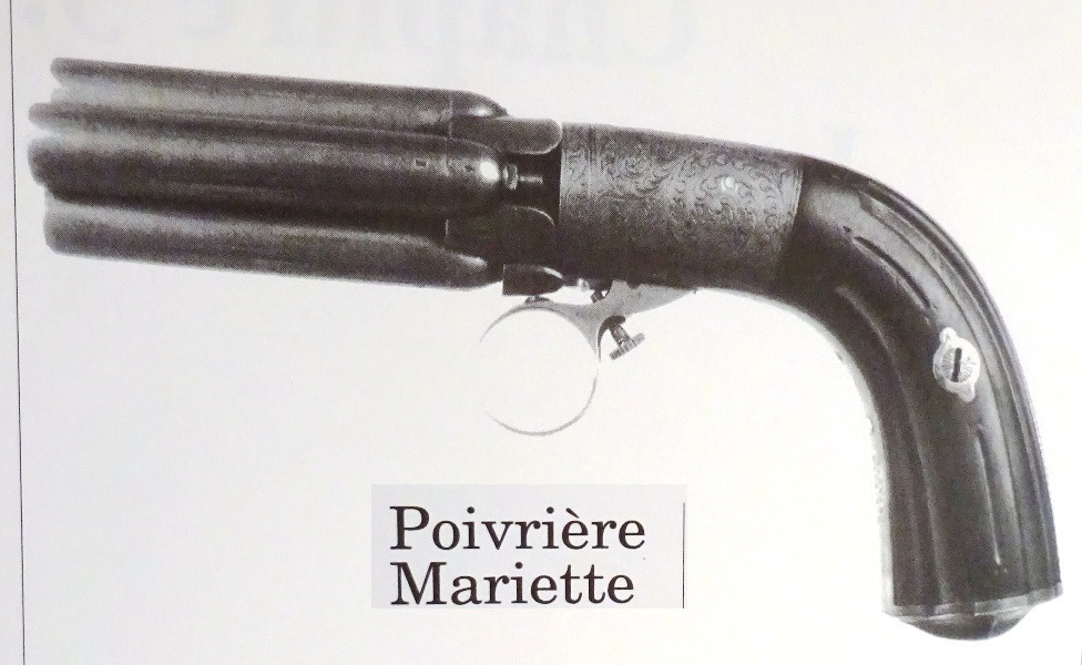

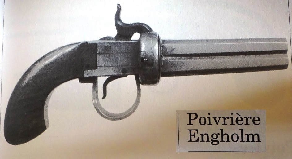

Jim, i was referring to my self inflicted frustration for not noticing what looked obvious (to me) in the first place; not expecting such zealous assumption to be hijacked .
As i started by mentioning the Allen & Thurber in my previous post, of which i didn't include a picture because their typical stocks are not the type of Phil's or British examples. For the matter, it is only the firing system that counts.
For perusal, here is a number, among many, of Liege pepper boxes from my little book "Pistolets et Revolvers de poche au XIXème siècle".
Old 10th August 2019, 12:48 AM   #16
Posts: 10,864
Thanks Fernando, I would have never have thought that's what you meant. With these pictures I now realize I have never seen a Belgian example, and I had thought that they basically copied the forms and patterns of other countries. I do appreciate the explanation and illustration, and helps to learn the differences here.
