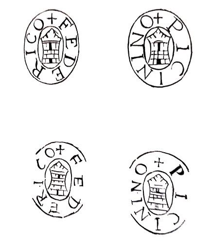

The blade on this appears to me to be most certainly North Italian by the oval cartouche at the ricasso, which seems in degree an Italian convention with a number of makers including Picinino, and in the late 16th early 17thc period.

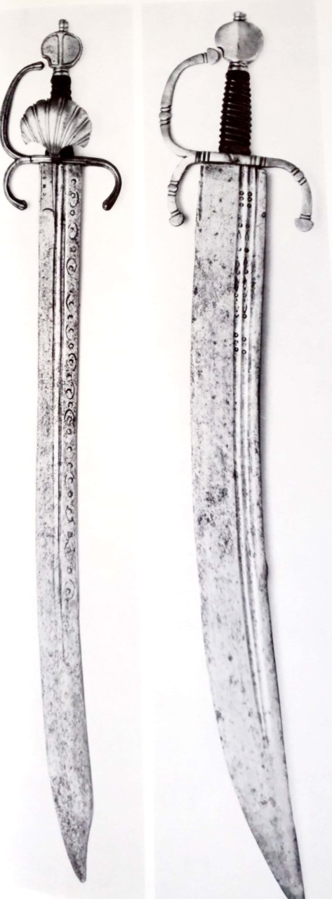

The blade is of the Storta (Boccia & Coelho, 1975) type and of that period (op. cit. #544, 545).

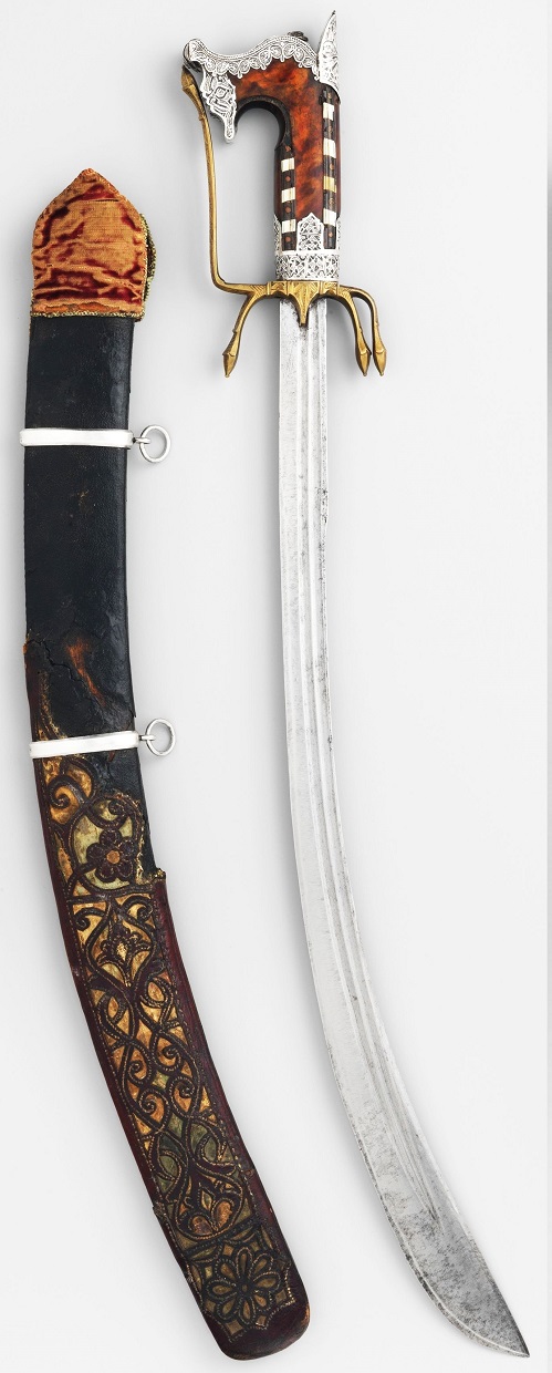

The hilt is clearly remaining from a Maghrebi nimcha as noted 19th c. likely Moroccan.

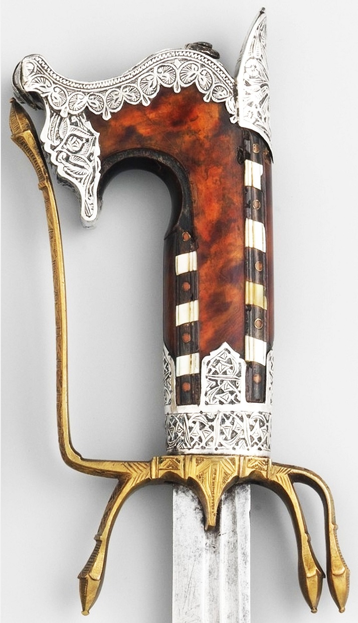

According to the main theory on the origin of the nimcha, it was derived from the storta, so it is nice to see one with a storta blade. In my opinion the hilt is older than the 19th century, based on the shape - the pommel on 19th century Moroccan nimchas tends to be quite flat, whereas this one has distinctive "horns" protruding and those are usually found on earlier examples, at least when it comes to Maghrebi nimchas. The band at the end of the grip is also more detailed and complex than typical 19th century examples.
Even though the guard is missing, this is an outstanding find, congratulations.

I am wondering whether it had ever had a crossguard.

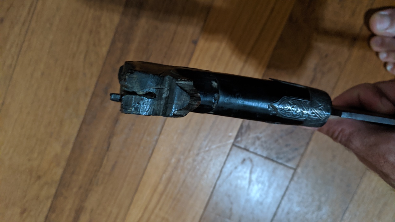

Thank you all. I think the observations that the sword originally had a guard are correct. The photo below makes it look as if something was originally attached to the top of the hill. And the corrosion patterns in the ricasso are slightly different than the rest of the blade suggesting that something may have originally been there..
