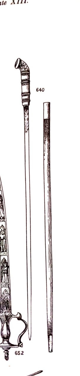

After some review of old notes and other references, I am inclined this weapon goes more in line with the GUPTI or 'sword stick' of India. These are described in Pant (1880) p.44 (from G.C.Stone, p.270) along with the 'fakir crutch' type weapons.
In Egerton (1880,1896,1968,2002) #640 (attached) one of these 'gupti' is shown and another mentoned, both from Lahore.
While the origin of the blade is unclear, its needle like point seems remarkably like those seen on some Tatar sabres known in the Caucusus and environs.
The character of the figures and designs inscribed on the blade remind me of 'similarly' styled ones which seem to come up in material culture among the Kalash people of Chitral regions in Pakistan. These people are primarily practicing an animist faith which resembles ancient Hinduism but having numbers of pagan elements. They are closely aligned with the peoples of Nuristan (formerly Kafiristan) which is now Luristan.
Though it is hard to directly say these are inscribed designs of these regions, it is tempting to note the similarity and character of them, along with the fact that the 'gupti' was well known in Northwest Indian regions. It would not be unusual for Central Asian blades to be found in these areas, nor to see one repurposed into this sort of weapon.
