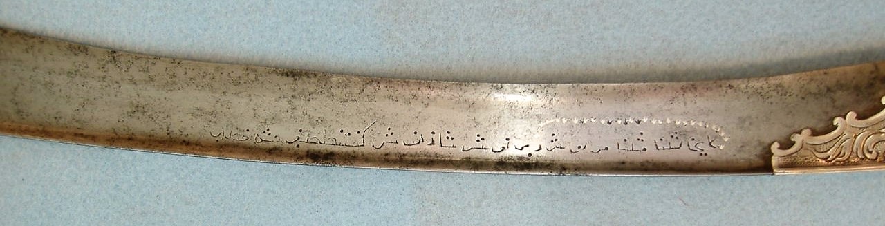

With that in mind, it is important to confirm as far as in possible that there are no other known...for sure...examples of other yats mounted this way from WITHIN the Ottoman empire. I am grateful for any help here from our forum members. I am also curious if the inscription on the blade can be translated, and if, by chance, it may be Jawi?

If you turn your photo, you will see Arabic script on your blade.

I am not familiar with the mounts - the decorative motives are Ottoman, but a wooden scabbard with no leather, multiple bands holding the scabbard together and no dragon at the chape is a bit unusual, so it is possible that it was mounted in SE Asia. The blade looks like an older blade (18th century) most probably from Asia Minor and the writing looks like the seven sleepers formula. There is a very high probability that the blade has a few rows of Turkish ribbon - have you tried etching it?

The blade has been etched. There was a distinct temper line, but no Turkish ribbon.

The blade reversed for easier Arabic script translation.

As Teodor pointed out, these are the names of seven sleepers and their dog:
"Yemliha, Mekselina, Mislina, Mernuş, Debernuş, Şazenuş, Kefeştatayuş, and Kıtmir."
They inscribed them on yatağans, believing to have talismanic powers, protecting owners from harm.
There is a chapter (Surat al-Kahf) in the Qur'an, on the miracle of seven sleepers and their dog: seven Christian men and their dog escaping from the persecution of the Romans, seeking shelter in a cave and sleeping several hundred years and waking up. References to strength of faith, divine protection of the believers, life after death and resurrection.
