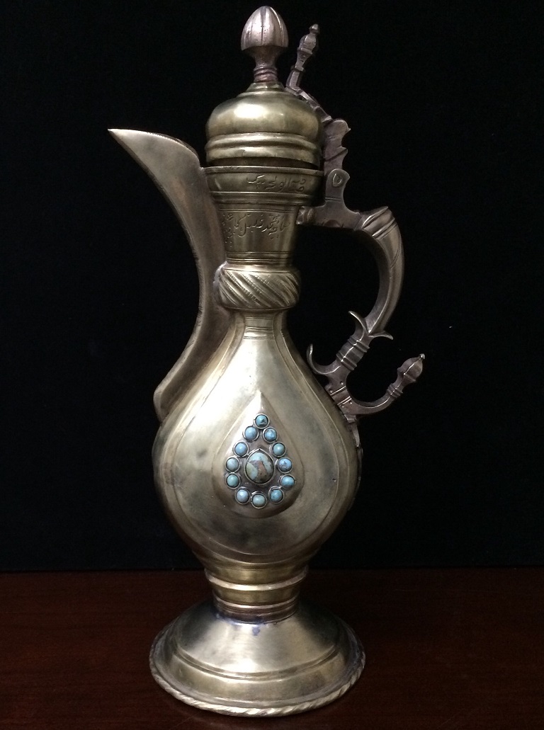

Here is Central Asian ewer with inscribed handle. I can read the year 1332/1913. Hope our Arabic speaking colleagues will be able to translate the rest.
Thanks in advance.

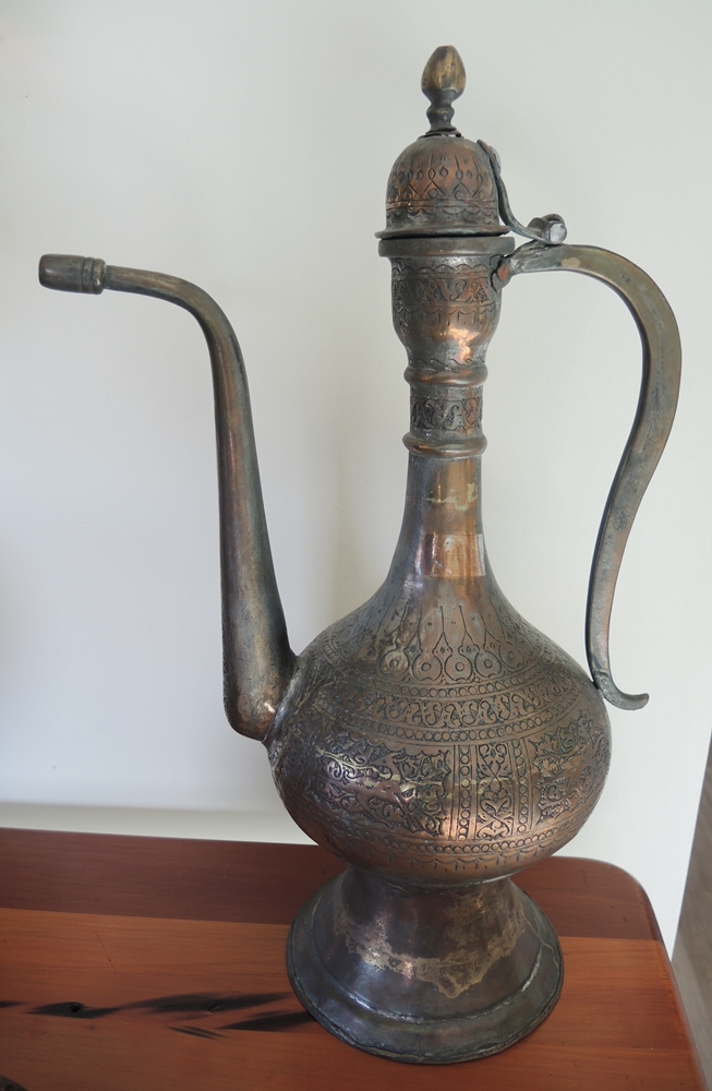

Here is a Persian?? ewer I have in my collection. Probably not as old as yours......
Stu

Is it Persian? it seems to say ''sirdah adeen kuljeen '' is that the name of the maker ?

It’s dated 1332 (1913-14) and has the owner’s name
صدر(؟) الدين خواجه نيا
“Sadr(?) al-Din Khwaja Niya”

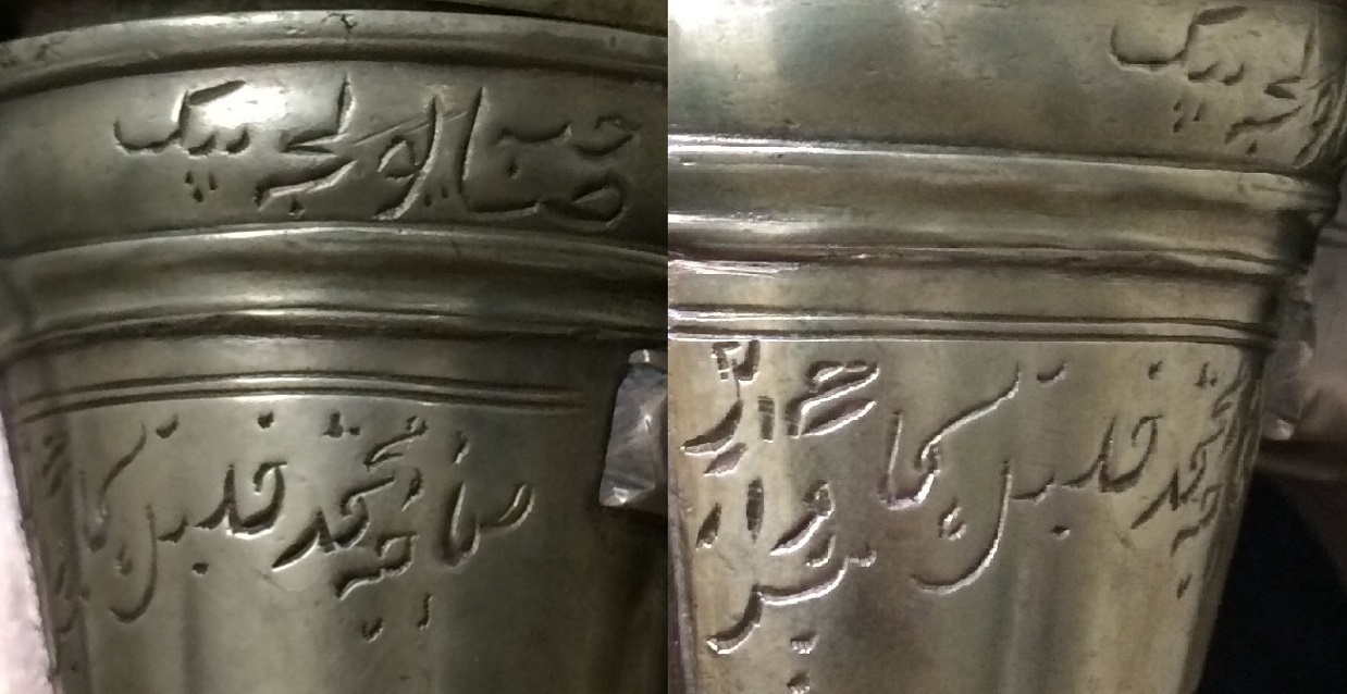

May I ask for another favor to translate the below inscription on another ewer below? They're usually dated but I do not see any numbers.

Well, it's definitely Central Asian
The top inscription which looks older is
صاحبه یولجه بیگ
"It's owner, Yulja Beg."
The next inscription, which looks later, starts ok, but the ending is odd. I can't even really see if what is at the very end is meant to be numbers of letters.
... (صاحبه محمد خد بک (؟
"It's owner, Muhammad Khad(?) Bak (i.e. Beg?) ..."

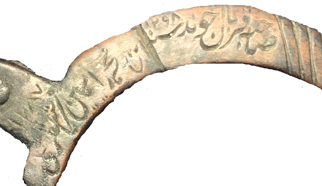

Many thanks once again for translation. Its interesting to see one inscription looks older, most likely indicating several different owners during its lifetime. Below is another example from another ewer's handle. It shows 2 inscriptions with different dates. Can you read them?
Ibrahiim,
Thanks for the reference. These ewers are distinctively Central Asian with typical design and elements. Still, each with some differences and unique character.. just like arms)
Old 29th November 2019, 11:14 PM   #10
kwiatek
Join Date: May 2019
Posts: 156
This one‘s from Kashgar. I would read it as one long inscription
صاحبه قربان اخوند ابن محمد امین (؟) کاشقری سنه ۱۲۹۸
“Its owner Qurban Akhund ibn Muhammad Amin(?) Kashghari, year 1298 (1881-2).”
I’m not sure if the name “Amin” is correct.
There is another number at the end that’s looks like ۱۷۸۷ (1787). I don’t know what that refers to though it could just conceivably be ۱۲۸۷ (1287) in which case it could be read as 2 inscriptions
1.
صاحبه قربان اخوند سنه ۱۲۹۸
“Its owner Qurban Akhund, year 1298 (1881-2)”
2.
ابن محمد امین (؟) کاشقری ۱۲۸۷
“Ibn Muhammad Amin (?) Kashghari 1287 (1870-1)”
Just to confuse you, another possibility is that Muhammad Amin wrote the inscription on the left in 1287 and then eleven years later in 1298 his son Qurban Akhund wrote the second inscription on the right, adding the word “ibn (son of)” in between.
In any case, good night!
