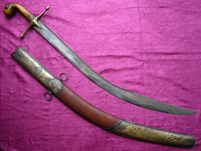

Dear forum members,
Can you help me with translation of the pala blade descriptions?
XIX century ?

Anyone can help with translation?
Appriciate your help.
Any suggestion about origin? Balkan, Turkish?
qusko is online now   Reply With Quote

My guess is Syria.

To me it looks Balkan, based on the brass scabbard furniture and the style of the inscriptions on the blade, which is very similar to what you find on Bosnian yataghans. But styles and decoration techniques traveled far and wide within the Ottoman Empire and it is hard to put them within specific borders.

Agree with Ariel. The silver coftgari does look similar to some Balkan Yataghans, but overall this Ottoman Pala was likely made in Syria. Here's similar:
Old 8th March 2019, 11:54 AM   #9
Inscriptions, blade, hilt, scabbard all Balkans
What makes you think that this kilic is from Syria?
I vote for Balkans, but it's not a difficult one.

My opinion was based on the same point indicated by Alex: silver koftgari.
Even now e-bay is filled with identical replicas coming from Syria and sold either directly from Damascus or through Turkish intermediaries.

I was thinking that you were saying Ottoman Syria
If you mean 20th Syrian replica, then you are twice wrong.
This kilic is absolutely perfect and the inscription is original and genuine.
For Syrian replicas please look at the book Weapons of the islamic world, full of fakes...

Kubur, I am sure Ariel can tell this Pala is not a replica. He referred to the fact they are produced in Syria up until this day, and there is reason it can be Syrian, but no reason calling others ‘wrong’ for having an opinion!
This particular inscription form is not typical for Palas, so could be added later or elsewhere. The blade profile and laminated steel are more indicative of Syrian than Greek or Balkan Palas in my opinion. You may see THIS THREAD for references to both past and present Ottoman Palas in Syria (see a Bedouin Chief photo, thread 12, and several similar Palas/Kilijes on the workshop wall).

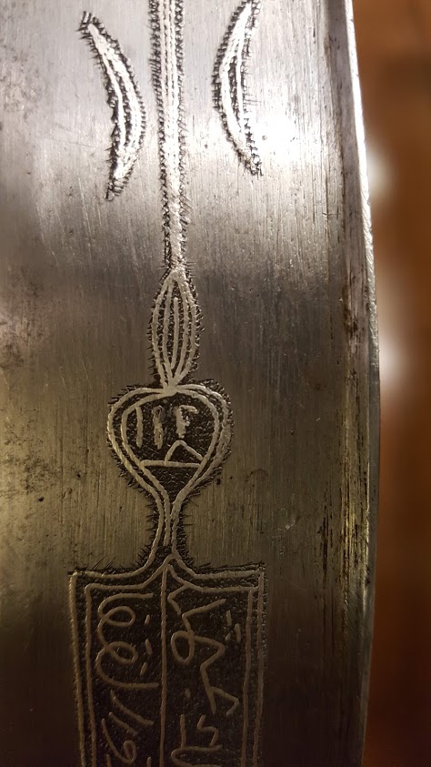

I was able to receive some partial translation:
لافتی الا علی لا سیف الا ذوالفقار
There is no brave young man like Ali, and no sword like Zulfiqar

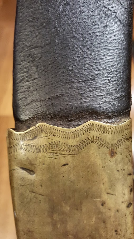

The zig-zag decoration on the brass scabbard parts also looks like a typical Balkan decorative element to me.
A lot of arms made in the Balkans at one point traveled to Syria and Egypt - seeing a pala in a Syrian context means it was used there, but does not automatically mean it was made there.

Doesn't the inscription indicate that it, at least, is more likely to be Syrian than Balkan?

I've found the date on the blade and tried to match it with islamic digits.
For me it looks like 1248 which gives 1832

Similarly, the zigzag decoration was/is not typical Balkan element. It is very common Ottoman (and many other locales) technique.

The “ Ali/Zulfiqar” saying is attributed directly to Mohammed. As such, it was and is widely used by Shia and Sunni alike. There is no religious divide here.
Implying that this Pala is Balkan and designating it as Shia is a contradiction in terms: Balkan Muslims were and are overwhelmingly Sunni.
Bektashism was rooted among the Janissaries, but those were forcibly disbanded and their remnants were hunted and killed in and after 1826, well before this Pala was created. Bektashi order was banned throughout the entire Ottoman Empire. It gradually got revived somewhat with the advent of Tanzimat era (1839-1876) but their numbers within the Balkan Muslims was negligible. With total abolition of Bektashism by Ataturk in 1925 they moved to Albania and established their headquarters there.
Are we to believe that this Pala was created after that?
We seem to have a lot of questionable arguments here.......

Ariel is right, the Ali/Zulfiqar inscription was quite popular and used throughout the Ottoman Empire, and cannot really be used to point to a specific area of origin.

There are two points on which we all agree:
1. This is an Ottoman Pala
2. It is genuinely old, likely 19 century.
But the problem is that in the absence of place of manufacture indicated within the inscription we cannot pinpoint its origin. Ottoman Empire was an early model of small scale “globalization”: there were several foci of mass production of blades of uniform design and distribution across the land: Anatolia proper, adjacent Syria, Bosnia, Bulgaria. We can in some cases pinpoint the origin of the entire weapons: Zeibek yataghans or Bulgarian karakulaks. More often, we can attribute them by the handle: yataghans with Karabela-like handles hint at North Africa, with thinnish rounded ears suggest Greece, with smooth round coral indicate Foca etc.
Palas are significantly more homogeneous: same blade contour, same handle and scabbard, same inscriptions with “ master/owner” having uniformly Muslim names, “Ali/Zulfiqar”, “seven sleepers”, same symbols. Perhaps, only contoured grips ( finger stalls) can swing the likelihood to Balkan origin. Bektashism and Shia/Sunni divide play no role.
Manner of blade inscription had always been very confusing and here we have to utilize our individual “gut feeling”. Alex and myself tilt toward Syria, you tilt toward the Balkans. I just do not see a way for any of us to be certain about the origin of this Pala, and that was the gist of my comments. We can only cast doubt on the validity of our opponent’s arguments but cannot bring up the decisive one in favor of our position. Either of our attributions can be correct, but we just cannot prove it.
Perhaps, we can leave it at that?

In the cartouche over two lines is the Arabic …(which I cannot get the second line of... but the top line says in transliterated English)
Ahmed iliyas farhar sahib al malak al ahad
which means: This is my sword made for me by Ahmad Illyas.
Thank you Ibrahiim for translation
