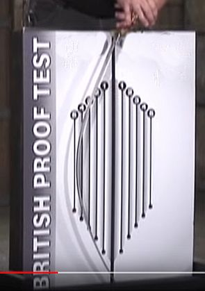

The answer to your question is 'probably', depends on how good the maker was. Some were likely very well tempered, some not so well. Depends on the maker and the acceptance standards and test of the purchaser. A good blade will pass the british proof tests, bending rather than snapping in two, but springing back in line. You probably should not try that at home.

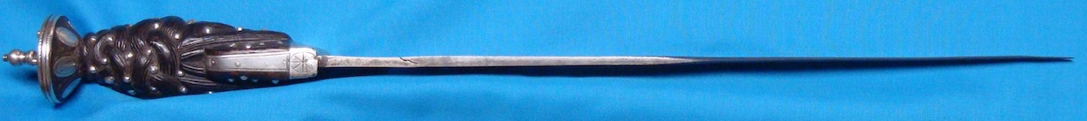

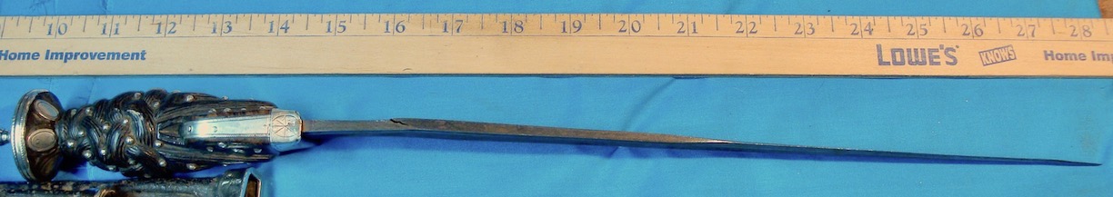

The blade seemed to be moderately hard but not brittle. After I did some more research and read your comments here, I slowly and carefully bent the steel blade back into straight form without snapping it.
So I did not need to reheat but will keep this as a second option should I get into a similar situation.
Again many thanks to all of you for your input.
The first picture is how I got the blade which was roughly 20 degrees off center.
The second picture is after I worked on it, which is now roughly straight.

I was debating on brazing the crack with silver, but have decided to leave it as is for now. The blade is from a cut down Scottish or English sword.
