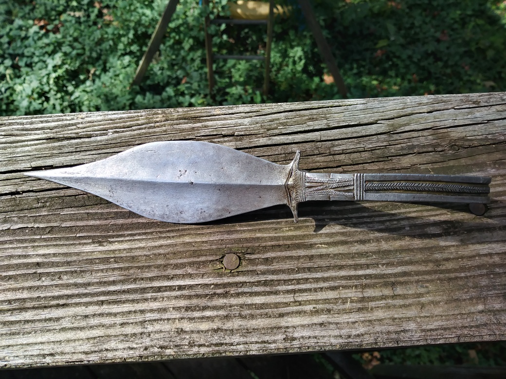

I just rec'd a loop dagger, ex-Waldman collection. I already owned one, which seemed free of any surface patina. The new one seems to have a black coating which tends to obscure some of the detail work. I'm tempted to clean it up a bit, but torn because I don't know whether the coating originates with the maker, or was added later. It does not look like any sort of oxidation.
Normally I prefer not to mess with the finish of an object, unless it is actively rusting.[IMG]
Comments welcomed, thank you.[IMG]

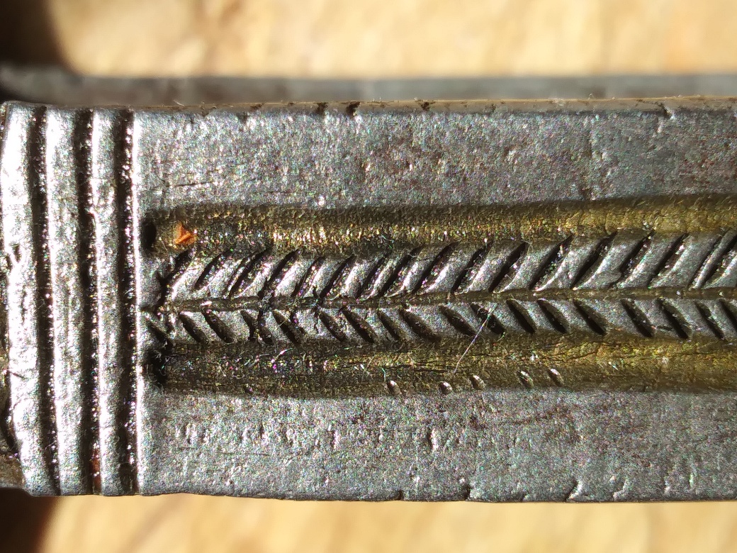

A few hours in a vinegar soak, with scrubbing and baking soda slurry, followed by Eezox and stainless steel scrubber and 0000- steel wool, and this is the result. The brass or gilt in the handle grooves was a nice surprise.
Old 19th October 2018, 11:50 PM   #11
Posts: 4,736
Thumbs up Looks good
Hi Bob:
Nice job. Shows again an unexpected detail after cleaning. Sometimes it's a nice surprise.
