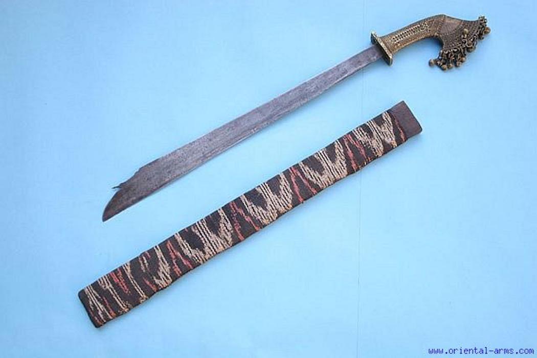

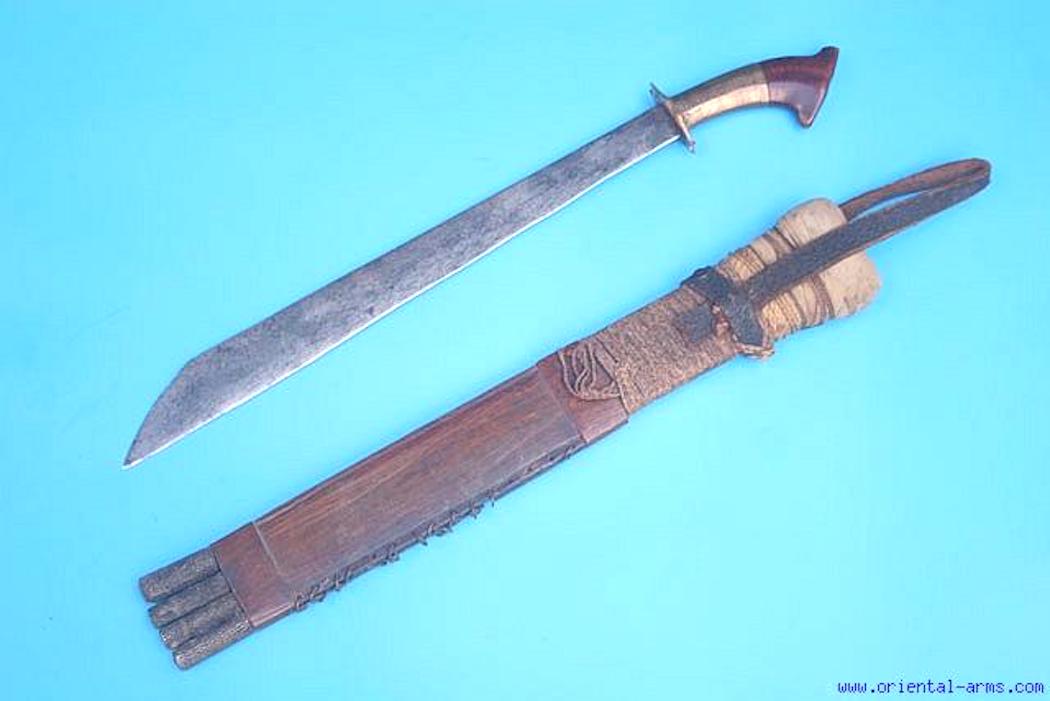

Here are a couple of pictures of a T'boli and a Bagobo small kampilan. They are each shorter than the Moro kampilan and are more in the nature of large knives rather than swords. The tribal distinctions are in the hilts and the ikat wrappings of the scabbards, otherwise it can be hard to distinguish between the tribal origins because the blades are often similar. The top one is T'boli.
Ian.
Old 4th October 2018, 01:44 AM   #4
Posts: 7,371
I agree with Ian. Mostly kampilan like blades seem to be used on Lumad tribes like the T'boli and the Bagobo.

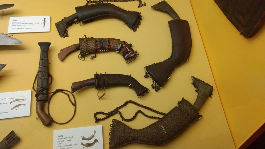

Hi everyone. I'm not well-versed in Lumad weapons, but this is all I can do to help- been to the National Museum of Anthropology here in the Phils lately, this is what I saw. Apologies if I wasn't able to get all the labels.
Old 13th October 2018, 05:34 PM   #10
xasterix
xasterix's Avatar
Join Date: Oct 2018
Posts: 708

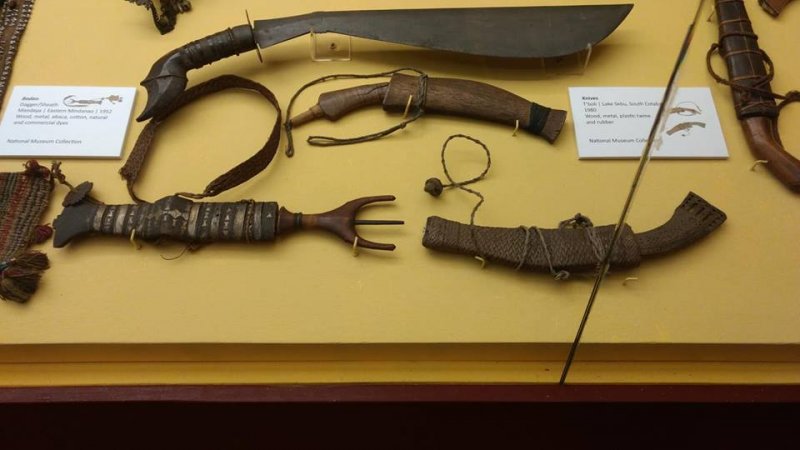

Hi everyone, I'm not well-versed in Lumad weapons, but this is what I can do to help- here are some pics from our National Museum of Anthropology.

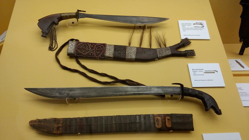

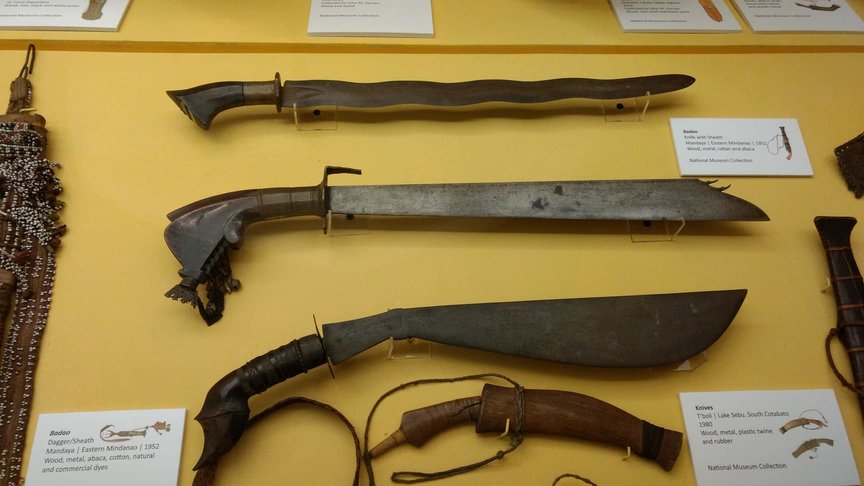

Greetings. While I'm not knowledgeable on Lumad weaponry, here are some pieces from the National Museum of Anthropology. Enjoy!
