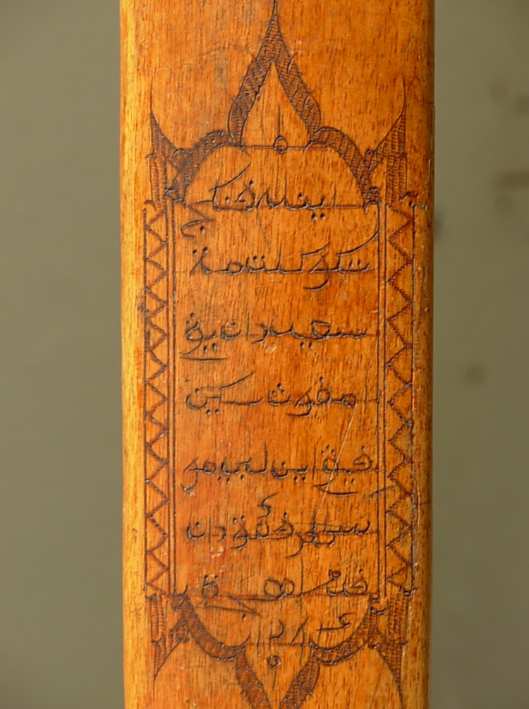

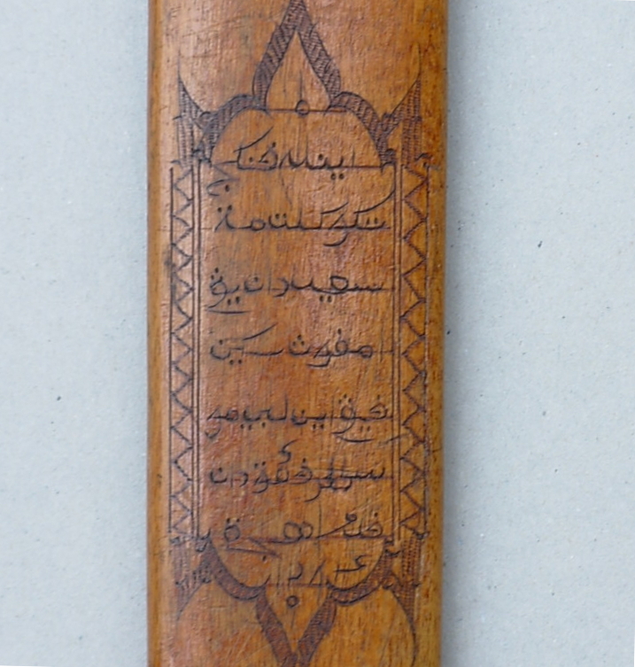

Dear All,
if possible I would like to ask some knowledgeable person to translate the cartouche on this one, please.
And a question - the blade of this specimen is becoming slightly broader towards the tip, for about 3,5 mm. I suppose, it isn't much reshaped or resharpened. Have somebody of you noticed something similar on your Sikin?
Many Pamor layers on this one.

Ariel, thank you very much!
The cartouche once more, in correct orientation.

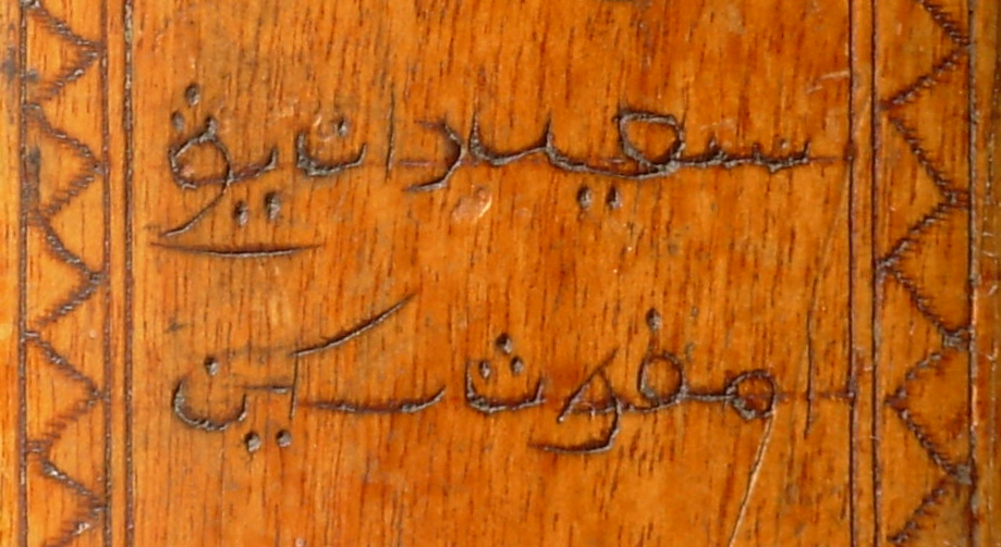

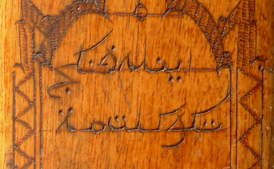

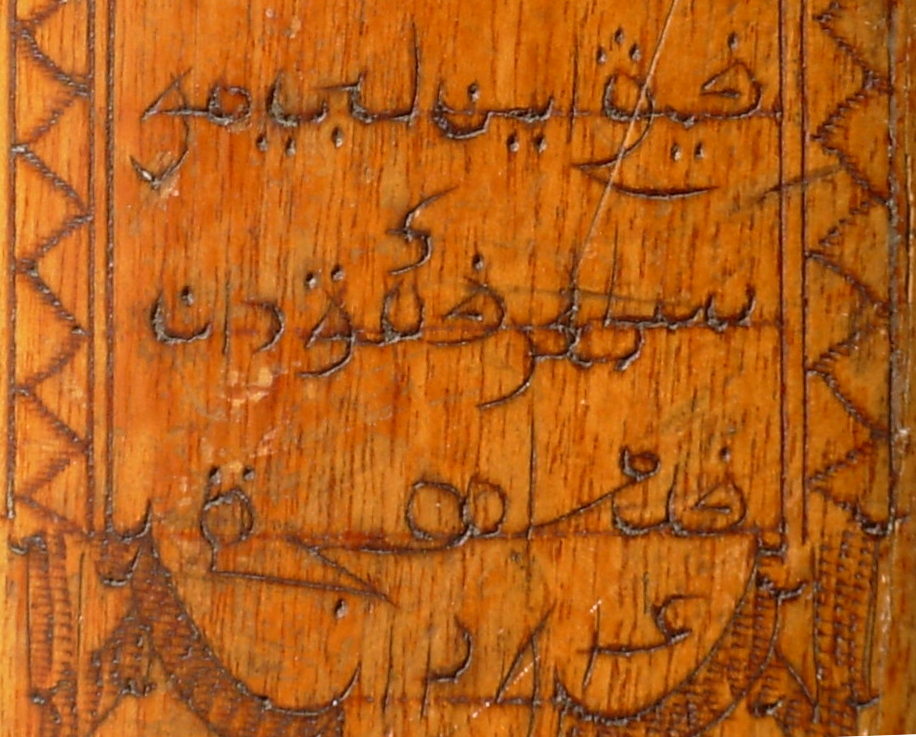

Better pictures of the inscription:
Old 5th August 2018, 03:29 PM   #16
Jentayu
Join Date: Dec 2008
Posts: 63
Hi Guztav,
While some of the words are quite clear to read, others are hard to decipher. Nevertheless, below are the translation of what was written on your sikin sheath. Hope this helps.
"Ini lah peninggalan (?) Teuku Kalit Mat Said dan yang empunya sikin panjang ini ....dan pada..."
"This is heirloom? of Teuku Kalit (or probably kaluet a province in Aceh?) Mat Said and whom this sikin panjang belongs to ....and on ...(the rest I cant decipher)"
