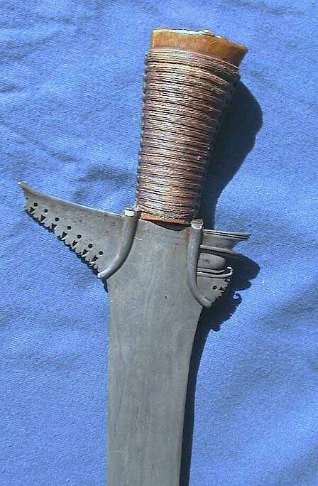

Mabuhay Y'all! I find my self once again in the Philippines after a long absence this time with an agenda in mind. To acquire some pieces that I should have got the last time I was here.
Let me pause right here and mention that I FINALLY got the opportunity to meet with Ian. Thrilled and awed are the first two words that come to mind followed closely by appreciate and gratitude. He was kind enough to spend the majority of a day walking me around to all his known "contacts" and more than that he generously shared his in-depth knowledge of Philippine culture and weapons. I will be eternally grateful. Might I add that he's "A DAMN fine looking young man" With his introductions (and the Philippines is nothing if not a nation based on personal relationships) I was able to pick up this kris which I daily am forced to pull from its tagub and slice the air with.
Nothing tells you more about a blade than cleaning it. While if Cato's book holds true, this is a Maranao kris blade (elephant mouth shape and position)and probably a fighting version of a datu kris (straight blade and hilt shape), I feel the blade is quite a bit older than the dress.
I didn't think that originally. The metal was quite tarnished and required hours to clean, the wood has a deep patina that is quite gorgeous in person and the ivory pommel had some kind of lacquer like bulid up that I was not entirely able to remove (and truthfully did not want to entirely erase). The blade itself was black, with active rust around the asang-asang.
After cleaning however I noted two things, the dress although extremely tarnished shows none of the bangs and dings of use and the blade has been reset using what looks like Blue gasket seal. However contrary to that the silver chasing has been worn almost off on the underside of the hilt which you would expect of an older piece and some of the copper wire bands have loosened with age so I am of two minds. None the less the artistry of form and the symetry of design continue to draw my eye every time I enter the room. WHOOO!
Thanks again Ian this piece is definately second only to my Bangkok era darb. Enough said, enjoy the pictures a first shot of the blade before cleaning and the rest speak for themselves.
AND after conservation
As a neophyte in Moro arms all comments are welcome.

Welcome to the Kris fraternity Dan !
Now get back to collecting those Daab Dha Darb thingies .
If you can ... muahahahaha .
Seriously though , it looks like a pretty old Maranao blade that may have been re-hilted some 50 years ago . The dress is quite nice , very nice engraving but the baca baca would be too light for a Maranao battle sword IMHO .

Great catch! I am most fascinated by the greneng -- the 'Y' shaped incisions which I thought was rather unusual.

I agree with Rick. This keris has been re-hilted with a rather nice looking piece at that and the sheath is also fairly new. My guess is that this was not a datu blade at all, but something more common place. It is obviously a pre-1930s style and likely 19thC, but IMO the workmanship is not up to datu class blades. It is not unusal for old blades like this to be spiced up with fancy dress to make them more appealing for sale. Still a nice looking kris that i would be happy to own.

Welcome to the insane and confusing world of PI/Moro collecting. Nice piece. Yes it is a later dress than the blade. I agree more recent. Did you check to see if the fittings are silver or aluminum? The patination indicates silver to me, but a jeweler could test and tell you with certainty.

As others have noted the dressing is modern. It has become common practice in many Manila antique shops to dress-up older blades in modern fittings, and then try to "antique" the fittings. In some even trickier shops, they are now re-using old salvaged woods and other materials to give it an older look and color. Particularly in Maranao country, such as Tugaya, one can see a plethora of re-fitted old blades mixed in with newly made ones. I would be interested in what the shop owner had to say about the kris, whether or not he mentioned it as being a re-fit.

Federico, what you have said may explain what I have been seeing on eBay for the past 2 years: old blades with new fittings with varying degrees of craftsmenship, but not in the old styles.

Refitting an old Moro blade is not uncommon since the blade is the heart of any sword. If the blade is really well made, it should outlast several dress changes. The dress on Dan's kris is well executed and not grossly overdone. I've seen some of those overdone krises (usually made for the tourist market) that are too gaudy to be considered serious weapons. I tend to agree with Rick that the redress of this sword was probably done around 50 years ago. More recent work tends to be gaudier and lower craftsmanship. It's still a nicely done sword. Good catch, Dan!

While traditional in use re-fitting is not un-heard of, I am suspicious of this piece being done older (50 years ago). Particularly due to the heavy attempt to age the fittings, blue glue (I just dont think blue glue would stay blue for fifty years, I would see it getting darker from ), and the blackened blade with live rust (generally the blades that get this treatment are in rough shape to highlight the age) and that Ive have seen this plainer fitting motif on newer pieces that I have been told were new. I also have my doubts about this blade being a good candidate for the owner to put such fittings. If it were traditional fittings, he is upgrading a battle blade with datu-esque fittings. Particularly after WWII, I am suspicious. If he is jumping up in rank, during the fifties I can think of other vestiges that would be more common.
I hate to say it, but while over-done pieces are easier to detect, those who try to pass of old as new are getting smarter and are realizing subtler construction is easier to pass off. There have been a number of pieces that Ive seen, and known were modern composites and was surprised at the sophistication they are starting to attain.

I am sure the redress was done quite some time ago and here's why. I've polished many a sword and this one took three applications to bring out the brilliance. While I agree that the actual setting of the blade may have been earlier than fifty years ago the dress shows definative age and undoubtably usage wear at exactly the points it should, index finger placement (the chasing is almost worn off there) and at heel of the hand. Many bands are seperated and lower ones remain tighly woven. The grime, especially that imbedded in the copper wire wrap, was especially difficult to remove and was not just dirt but oily grime that had set in over time. The ivory was particularrly hard to clean and is still embedded in the three cracks that show (I only showed the best side).

Of course, I would not be surprised if the dress was 10 or 20 years old, when I implied newer than 50 years old, I did not mean it was made yesterday, or even the year before.. But I am suspicious when it comes to Manila Antique shops. While I would like to tell myself, oh it is a traditional upgrade of hilts. Ive seen and been told too many stories from "Manila Antique" shops telling me that they have a "Maranao Datu's piece" that "displays all the fine acruitriments of a wealthy persons sword such as ivory or silver or gold", etc... and above all it is all original. In this case the upgrade of hilts was not to repair a good ol piece that was missing a hilt, but an intentional upgrade to turn a common persons kris that would sell for a lower price, into a "Datu's" kris at a much higher price. Which is why I am interested in what the seller had to say. If he is open about it being a composite, then I am more inclined to believe I am being overly paranoid, but if instead he gives a lovely story about an original piece then I become much more skeptical about the "traditional" repair. Also, pusaka pieces are not lightly given in Moroland today. If indeed it was a traditional re-do, and the owner hit hard times, the owner would do his best to keep the blade. Moro royalty, the only ones for whom such a re-build would be proper (the jump in stature for a commoner, even a rich commoner would be a very bad slip in social etiquite) are very much aware of how their ancestors were robbed of fine pieces on the field of battle, and many if not all are very protective of what few cultural heirlooms they have left. Which leads to then, why get rid of such a fine piece, after taking so much time and money to get it re-done so well, when there would at least be a few options around it? Now of course we can get into the role of the MNLF fighting in the 70s, a time when many fighters did sell pieces in dire straights, but stuff sold in this period, since the MNLF was largely a common persons movement, and not overly filled with royalty (many of whom were entrenched in official government) were plainer less guady swords. Now, current groups have other means of raising capital, and straights arent so dire. Which leads us back to why sell the pusaka?

Sorry to come in a little late on this one. Traveling again. Dan and I had a lot of fun doing the rounds in Manila a few weeks ago.
As Dan has said, this sword came from one of Manila's best edged weapon dealers with whom I have dealt for many years. Mr Ven had obtained it only a few days before we went to his shop, and this one came from the back room where he puts away expensive pieces for his local and international clients who can afford the better class items he finds.
Having handled this one, I am sure that the blade is 100+ years old. It has a separate gangya and a dark patina with no pitting, although a little active rust on the gangya (probably related to recent storage). The edge was straight and showed no dings or evidence of extensive wear/sharpening. Balance was good, and the blade felt lively despite being of quite heavy construction.
The pommel is old ivory, with prominent linear age cracks and a nice golden patina, and the silver appears to be older work also with wear from handling (as Dan stated).
The scabbard is probably a replacement, but a nicely made one none the less. Simple, well carved, nice dark patina to the wood, and silver fittings (or at least silver-plated). This is better than the recent work coming out of Mindanao, and looks circa WWII to me based on other examples I have that were well provenanced.
So I think Dan has acquired a nice Maranao kris with blade and hilt c. 1900 and scabbard perhaps somewhat later. Whether datu quality is hard to say. Certainly, much better than average in terms of the quality of fittings on the hilt.
The dealer also felt the blade was around 100 years old, but the scabbard was not as old.
Ian.
