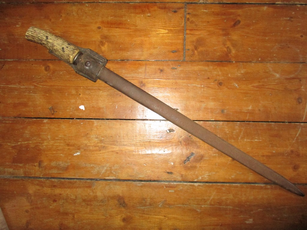

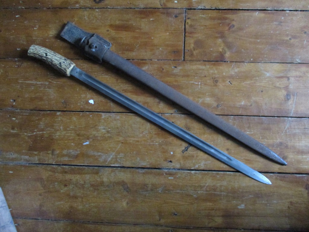

Hi All,
Because of the reptile skin and basket weave on the hilt and sheath, I assumed the civilian mounts were made in Africa. Given the the design of the sheath throat, I assumed that the piece came from a Spanish colony. Internet research revealed that the blade was from a German model 1871 bayonet made by W. R. Kirschbaum in Solingen. The internet also showed that the stamp on the other side of the blade (an "RA" inside a circle) meant that the blade was property of the Argentinean military. This appears to make the possibility of any African involvement unlikely. I have read that the Gauchos commonly carried a long knife/short sword on their saddles. Could this be an example? If it is, the condition of the sheath and the hilt is miraculous. The blade is also in superb condition.
Sincerely,
RobT

Hello
This is a "facon" (although it does not have "hawk") built from a bayonet blade. The RA by Argentine Republic. I can not see the work of the handle and the sheath, but I think it has a job of "touch" and applications of an iguana leather or live.
Affectionately. Fernando K

Hello
This is the bayonet for the Remington Argentine Model 1879 rifle, caliber 11.15 by 58 Rmm. The length of the blade is 471 mm. These bayonets were manufactured before 1883, the year in which they merged with Weyersberg. Anyway, I estimate that the facon is manufactured in the first half of the 20th century
Affectionately, fernando K

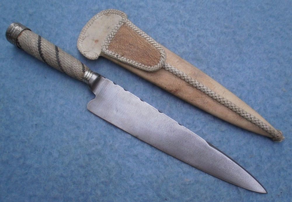

Old 12th March 2018, 06:29 PM   #7
Here for comparison a more recent Argentinian gaucho knife, the same scabbard style!

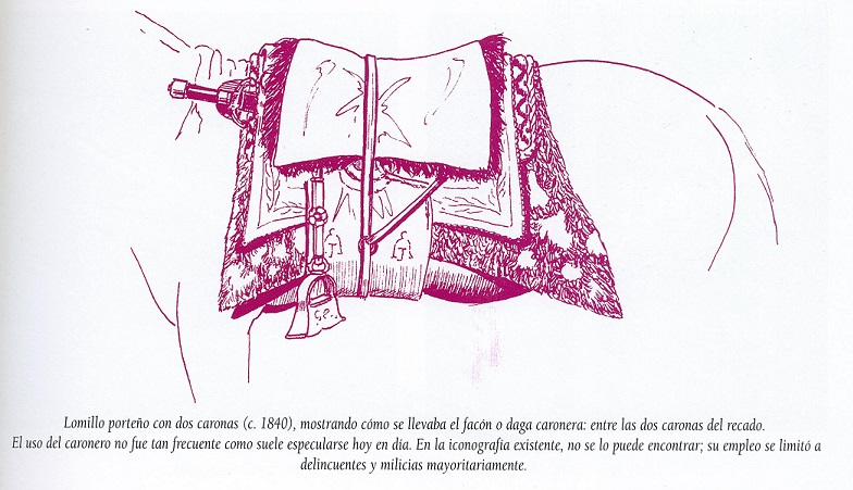

For clarifications
First: the "CARONEROS FACONES" were carried in the chair, with the handle outside, which allowed to be easily taken, assembled or disassembled. This facon lacks the GAVILAN (protector of the hand) because it is of elementary manufacture.
Second: the "CARONA" is not the saddle, but a part of it. It is like a folder or carpet, usually with a sole, which prevents the sweat of the horse from passing to the chair and for padding.
Third: The facon was not used to knock down cattle cimarron, for that the "DESJARRETADORA" was used. The main use of the facon is for the attack. To slaughter, hunt and slaughter cattle, a common knife was used

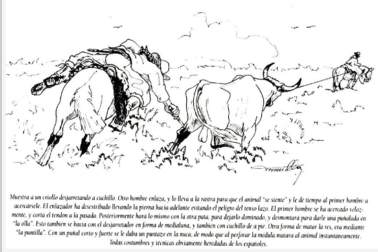

A picture is worth a thousand words.
Fernando is quite right that the word "carona" ought to be translated more accurately as saddle cloth, but I still think that my original translation was near enough.
From Abel Domenech's "Del Facon Al Bowie" pg 112-113:
Writing about the facon:
.....aunquee el gaucho tambien la haya utilizado eventualmente para otros menesteres: terminar of afenar una rez, cazar o cuerear...
Loose translation: ...although the gaucho used it also for finishing off or carve up a beast (cattle), to hunt or to flay....
Edit: I think that we can argue about whether these facons were primarily wepaons or tools to hunt with, but I opt for the later simply because gauchos ate more often than fought <lol>. As well their roving lifestyle prevented them from carrying around an arsenal of various knives, each suited for specific task, so they had to do it all with one or perhaps two.

As Domemech himself says (in the epigraph of his illustration)
...... its use is limited to the use by criminals or militias, mostly
An illustration is worth a thousand words, but you also have to see what the words say ...

I did not miss that caption at the bottom of the illustration which loosely translated reads “….its use was largely restricted to delinquents and militias”.
Now, I am more than happy to agree with the above, but only within the historical time frame, commencing well into the 19th century when the roving gauchos were outlawed and facons, especially caroneros, were no longer approved of, these knives being replaced by smaller and more broad bladed working knives. Actually gauchos were outlawed after the war of independence, but the enforcement of this was only gradual. And facons were considered unsuited for hacienda work, so their possession was severely curtailed, being restricted to senior retainers, hacienda owners and military men.
Be this as it may, the above statement in no way does it mean or imply that a gaucho in possession of a caronero used it only as a weapon and not for other tasks, and as I said in my previous post he ate every day and fought only on the odd occasion. It would be ludicrous to suggest or suppose that if he had such a weapon that he would reach for a shorter knife to carry out the very dangerous task of cutting the rear tendons of a steer. Not so say that it could not be done, but that it would be that much more uncertain. And then also there was the matter of dispatching the crippled animal, which sometimes was done by thrusting with a long knife into the animal from under the throat.
And this consideration applies even more to the halcyon days of the gauchos, before the war of independence, when they could roam the pampas at will, answering to no one and did as they wanted. A gaucho could bring down a steer with a shorter facon, if assisted by a companion, as depicted in the illustration shown. However, if alone, he would have had to disable the steer from horseback first. Sure, he had his “boleadoras” to entangle the legs of the fleeing animal, his first choice, but he could not always rely on those and if he missed, he had to try something else, or else go hungry.
It is worth remembering that the term “gaucho” constantly changed, from a pejorative in the late 18th century to a hacienda hand that rode a horse in the course of the 19th and finally it became conceptually the embodiment of all masculine virtues and more by the 20th. The same changes also applied to the “facon”, the early variants of which we know little about, except that they were large knives. These knives were worn, if possible in the small of the back, in the Spanish fashion, and if too big , pinned under the saddle. Domenech tells that much and is common sense.

The illustration that accompanies your post says just "Shows a Creole hamstring knife" and in the right hand seems to have a knife or a short facon (not a CARONERO), whose pod is seen in the waist, on the back

Mr Domenech has responded. With his permission (given in a subsequent email), I have posted his response. In the email I sent to him asking for his permission to share his information, I also sent the length of the blade (46.5cm). When writing back to me, Mr Domenech concluded that, "Considering the length of your blade, I tend to think this comes from the Remington Modelo Argentino de 1879 single shot rifle". Below is the information contained in the first email Mr Domenech sent to me.
Regarding your knife.
It is not a tipical "gaucho knife" or a facon or caronero, though I feel it was certainly made here in my Country. Except for the blade the handle is not the usual shape of these knives.
The blade is taken most probably from a bayonet for the Argentine Model Mauser of 1891 or 1909. These bayonets were imported from Germany and made by the famous firm Kirschbaum. The RA in circle is the military inspection mark.
There is also the possibility of this blade coming from a bayonet for the Remington Model 1879, depending the length. It was also made by same German maker.
You don´t mention the lenght but the Mauser bayonets blades are about 39 cms while the Remington ones are a bit longer around 45/46 cms.
The handle and part of the sheath (crude color) is made of raw hide woven in an interesting pattern which is a very popular technique which is very nice to view and handle but not practical as it is not very durable if it receives a very hard use, so it is usually reserved to knives made for collection or less use than a daily tool.
This technique was popularized during the 1930/40`s up to the present, and the thinner the threads used (which are made by cutting hides by the same artisan) more fine is the final work considered but also more fragile.
The technique is also used for handles of other objects like quarts or riding crops.
I would say this piece is very old but from the XX Century (may be from the 1940´s through 1960`s) and ordered by some country man to a local artisan and using the blade from a bayonet which was a type of blade often used in making facones and dagas here.
The use of a reptile skin in contrast adds a touch of interest to this piece.
I hope this little info is of your interest.
Best cordial regards, Abel Domenech
