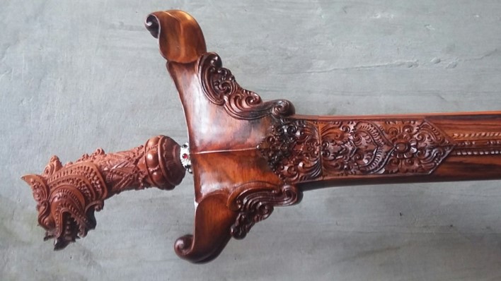

I hereby enclose a Kemardikan Madurese keris with 4 kembang kacang for comments.

Not meant to offend, but for me:
The wilah reminds me of a Pizza with too many toppings; there's no harmony expressed in the wilah; it's like keris science fiction.
The carving of the dress is better than the last example of Madura style carving you submitted.
I find the keris jarring; but maybe it is purely an art piece.

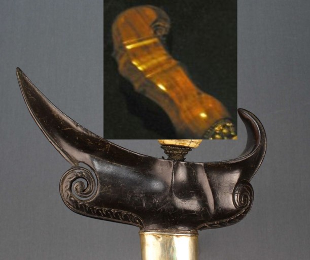

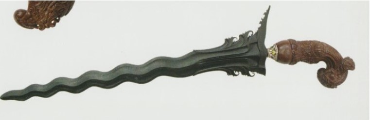

alexish
Join Date: Jun 2017
Posts: 127
I appreciate your comments. I understand that this keris is based on another older kemardikan example. I enclose a picture. I am wondering whether another collector has encountered another example of this particular Keris Dhapur before?

These extreme Kemardikan blades are not really the sort of thing that I find attractive, but there is no denying that in Alexish's example,the metal carving is very skilled, as is the wood carving.
Present day Javanese society and culture accepts this type of blade as legitimate art, so I guess we just need to try to adopt the same sort of mind set that we might use when we view any modern art. My overall artistic tastes seem to have not progressed much beyond the mid-19th century, and for me, its the same with keris art:- I like traditional, I do not like modern. But that does not mean that I am unable to appreciate the thought and the work that has gone into a piece of modern art.

Using those art appraisal standards, I feel that Alexish's keris must be accepted as a very competent example of the Javanese plastic arts.

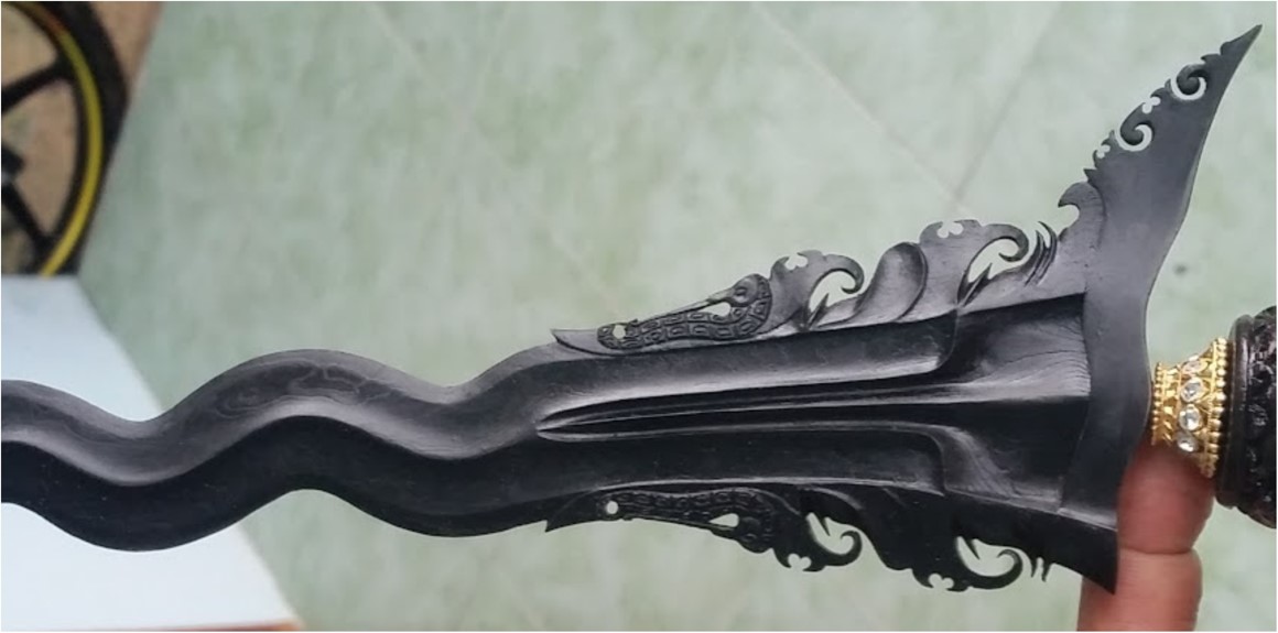

Default Forge lines on wilah

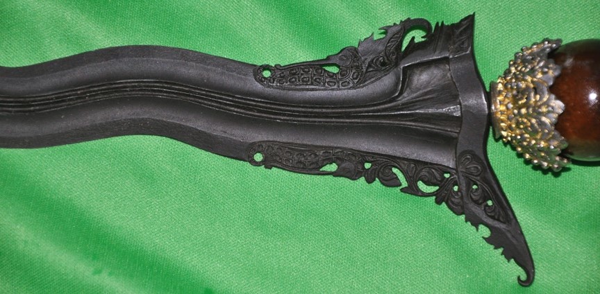

Dear fellow collectors,
All your comments are really appreciated.
Note that although the wilah is kelengan, forge lines are still visible, as shown in the attached picture.

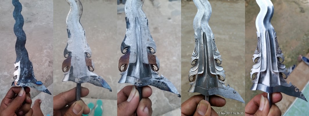

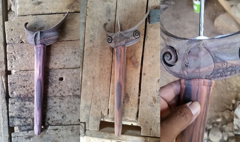

Dear Dr. David,

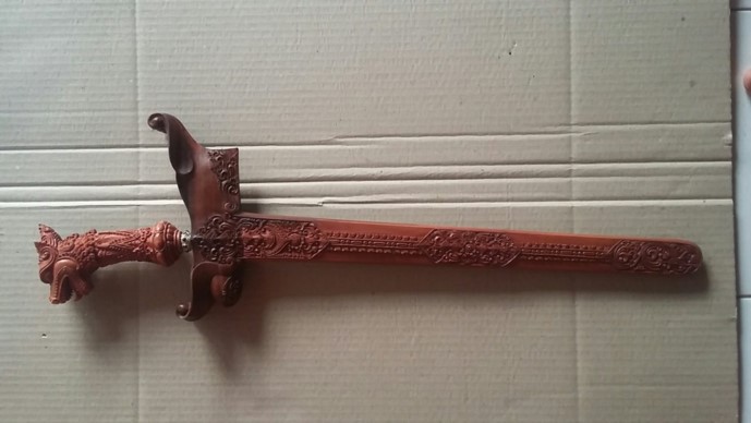

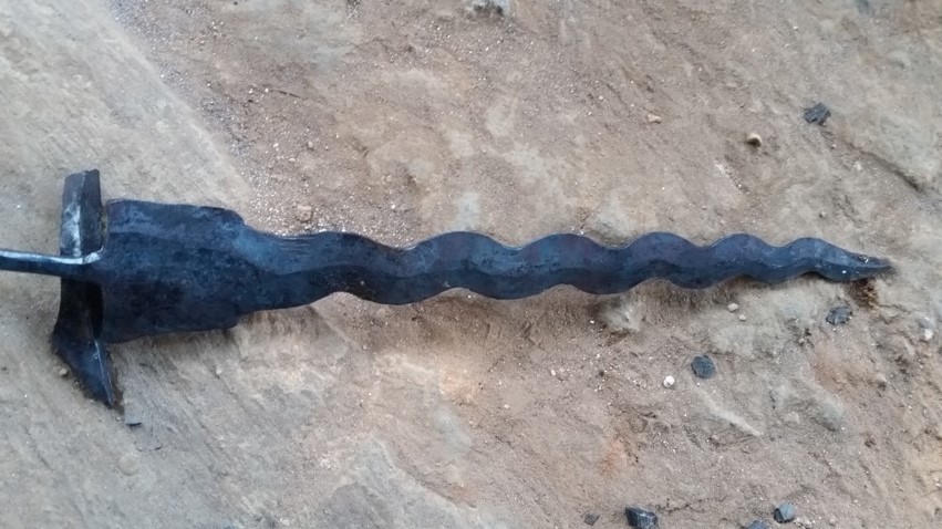

the keris was commissioned directly from the maker who resides in Aeng Tong Tong. I enclose some pictures of the different stages by which the keris was made. The same person made both the sheath and the blade, which is extraordinary.

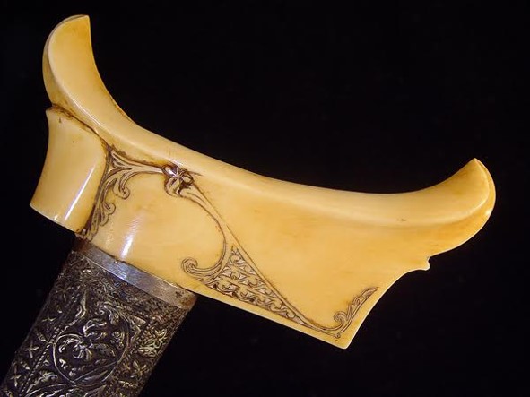

The keris wilah and sarung are entirely my design, inspired by the following attached images.
alexish is offline   Reply With Quote

So your influences seem to come from all over the archipelago, encompassing multiple and differing keris cultures from across the entire area. Do you image that the keris should be presented as some kind of generic mishmash of styles, mixing various elements of regional forms and designs from completely different tribal communities of people together into some kind of syncretic representation of the ultimate everything keris? Interesting.
