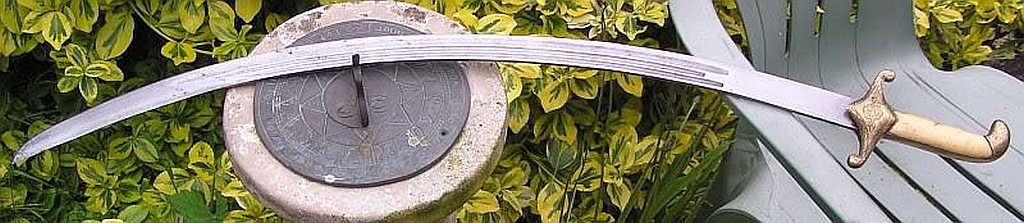

G'day Guys,
I have recently acquired my first shamshir. It has a large heavy blade of kirk narduban wootz which is 36mm wide at the hilt and 840mm long and weighs 1050g. It has engraved "Shah Abbas" and "Lion" cartouches.
Can anyone tell me what the "face" peering over the lion's back represents? Is it something to do with the sun?
Cheers,
Bryce

Congratulations for the wonderful shamshir.The second cartouches contains an image of a Lion and Sun and and is typically a Persian sealing mark placed by the master in the middle of the 19th century.

To me it does look like the sun, which is a Persian motif.
The blade looks like a ladder pattern wootz. Very nice.

OMG I had to look if I have still mine, yours is so similar!
It's what they call a Syrian/Badawi sayf with a very nice Persian blade.

That really does seem like an outstanding blade, and most unusually so for these type of Persian trade blades. I personally know little of metallurgy in these wootz patterns, but the examples of these 'Assad Adullah' blades I have seen are usually with channels or fullers, wider blade and typically of lesser quality wootz patterns.
According to the brilliant article by Oliver Pinchot, "The Persian Shamshir and the Signature of Assad Allah", ("Arms Collecting", The Journal of the Canadian Arms Collecting Society, Vol. 40, #4, Feb. 2002), these kinds of blades bearing a cartouche and a pictogram representing 'Assad Allah' (=Lion of God), began appearing late 18th and into 19th century.
This represented a marketing shift for Persian blades into varied markets, particularly to those in Arabia, where they were highly favored over others.
It is noted that among possible reasons for the continued use of the name of this famed sword smith of centuries earlier, one potentially feasible is a tradition recognizing Assad Allah and his contributions to Persian sword guild.
An exemption from taxes for 300 years said to have been granted by Shah Abbas (1567-1628) for the swordsmiths guild, may have prompted this commemorative use of the Assad Allah name.
Aside from this tradition, the imbuement of quality certainly was present as well.
It is noted also that the Kirk Narduban term was a transliteration from Turkish 'kirk' (= forty) and 'merdeven' (=steps/stairs) , while more commonly termed ' The Forty Steps of Mohammed'.
A very, very nice example of sayf Badawi!

Thank you for your replies. This large, heavy, plain blade fits the description of earlier made shamshir blades. If the Lion pictogram began appearing in the mid to Late 18th century, does this mean this sword was made then in the style of earlier blades, or was the Lion pictogram in use earlier than mid to late 18th century? Does anyone know of the earliest dated example with the lion pictogram?

I agree with you regarding the the blade being earlier form, 18th century is appropriate estimate. The lion cartouche is original to the blade. Absolutely magnificent shamshir with top quality beautiful wootz blade.

With regard to your original question,
The lion pictogram is a stylized version of the Sun and Lion (Shir O Khorshid)which is an early symbol of Iran from about 12th century. It derives from old Babylonian astrology, the sun in the house of Leo, and became representative of Shia Islam. I am not theologically versed to explain the further dynamics, however, the Sun and Lion became the national emblem of the Qajar Dynasty (1794-1925). The attached image is the Pahlavi version of the symbol.
As I previously mentioned, Oliver Pinchot describes the use of this stylized lion pictograph well in his most important article, " ON THE PERSIAN SHAMSHIR AND THE SIGNATURE OF ASSAD ALLAH", ("Arms Collecting", Vol. 40, #1, Feb, 2002):
"....the remarkable popularity of Assad Allah blades during the Qajar era, throughout Persia, the Near East and Central Asia, then was the result of careful exploitation of an established name.
Despite the reduced quality of the product, clear marketing in a form which was readily recognizable ( i.e. THROUGH THE USE OF THE LION PICTOGRAM) proved especially effective, particularly among the illiterate.
The quality of Assad Allah blades produced during the Qajar era also reflected the supplanting of edged weapons by repeating firearms, and the dissipation of the quasi-mystical reverence in which swords had been formerly held.
In regions where the sword remained an important spiritual device and primary weapon, as among the Bedouin Arab discussed above, the demand for Persian blades remained consistently high".
The fact that this blade is heavier, and the apparent high quality of the Kirk Narduban steel, seems to suggest an earlier example using this well known pictogram, if what I am considering is correct. This does not mean that the blade has to correspond to the beginning of the Qajar dynasty (1794) as this was simply the era in which the use of this device became popular. The pictogram itself was a stylized version of the symbol long used in Iran, and may well have predated the Qajar adoption of the sun and lion.
The examples of blades I have seen with this pictogram usually have multiple channels , and though heavy, do not have the sweeping radius of the shamshir form as seen here. I have considered them probably first quarter of 19th century+.
Again, very nice example which may reflect earlier use of the Qajar pictogram with the Assad Allah signature, which in effect, seems to have become a kind of brand which paralleled the running wolf and name of Andrea Ferara in the European parlance.

Well-observed, Jim and Ibrahiim. It is a handsome blade, congrats Bryce.
In this case, the likeliest explanation is that a blade dating from the late 17th-early 18th century was embellished with the cartouches containing the name and titles of Shah Abbas and the shir ve khorshid or Persian Lion and Sun during the late 18th or early 19th century. This would have been done to increase the value of the blade (and prestige of the owner.)
Period writers, notably British diplomat Sir William Ouseley, mention the considerable increase in value the Assad Allah signature could confer in Qajar-era Persia. See footnote 43 in the paper Ibrahiim kindly linked for the complete citation.

The spine of the blade at the hilt is about 7mm wide and appears to have a forging flaw that has been filled with another metal. From what I have read on other posts, this seems common with these blades. If the smith was skilled enough to ensure there were no flaws in the face of the blade, why did they leave open forge lines on the spine? Was it because it doesn't effect the structural integrity of the blade, so wasn't considered a problem?

I just had another thought regarding the open forging line on the blade spine. The smith obviously wasn't happy with it and that is why he filled it in. If most/all? nicely patterned shamshirs of this period have this feature, then the only reasonable explanation is that it is an unavoidable result of the low temperature forging technique used to make blades with this wootz pattern?
Can anyone answer this for me?

I am still trying to decipher the lion pictogram. I understand that the "face-like" object over the lion's back most likely represents the sun, but does it also contain a stylized and partially inverted rendering of "Assad allah"?

Hello Ariel,
I doubt that the crack in Bryce's blade is a manufacturing flaw. If it were, it would have been repaired with some bronze filling. I still believe it is a crack that appeared much later in the blade's life as a result of delamination. However, which of us is right would be rather impossible to check without a careful metallographic examination.
Moreover, even if it were a forging flaw, the precise forging process that involves fusing the edges of an ingot that was bent over itself is "lamination." So even of the defect appeared during the process itself, it would still be "delamination." Well at least that's how we called them during our metallurgy classes at the university.
Cheers!

You might be correct.
