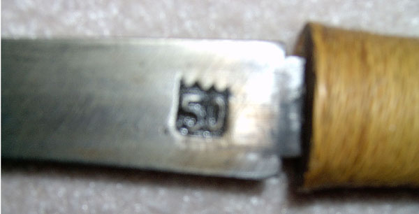

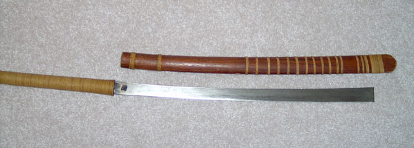

I have only seen two military dha, one Andrew's and another someone sent my for comment. Coincidently I just came across photos of the latter again last night while organizing files (photos are at home, but I'll post them tonight). Unlike Andrew's, this other one is a Kachin-style sword dao, with a very straight blade and a square tip, and the number "50" inside a box or crown stamped on the forte. It has a wooden scabbard, too, not a leather one.

Here are the pictures of the Kachin-style dao I was sent. The owner wrote the following about the sword and where it came from:
This is what I know about the sword, my dad brought it back from Burma at the end of World War II. He at one time said it was from a tribe of Native Headhunters, I am not sure if there is any truth to that or if it just made a good story line. He was with the 236th Engineers Combat Battalion in June of 1945 and that is about all I know of Him, His name was Edgar F. Moore. The Handle of the sword is 11 inches and the blade is 21 inches, and the blade has the marking of a 50 inside a symbol like maybe a shield. The blade and scabbard are in very good condition and the blade is still very sharp.
I replied with my thoughts about the Kachin Rangers, and it being likely that his father worked on the Burma Road, and he wrote back:
I did see the Kachin Rangers on your web site and meant to tell you that one of those individuals is carrying a sword that looks something like mine, well, at least the outside does. Yes, you would be right, in that he was working on the Burma Road in support of a water unit. I have a letter written by him to his father and he says that he is writing from somewhere in Burma!
Yours looks very similar to this one, and it may just be a case where a Kachin Ranger used his own dha in an army-issue scabbard. You also could try gently pulling off the handle, as I can see that it has gotten compressed onto the blade a bit, and see if there are marks covered by the wood.
