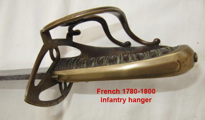

Here is a dead ringer for the pommel and guard. Having different blades is not unusual since no set patterns were at this time.
http://www.michaeldlong.com/Catalogu...0-ML12269.aspx
Old 30th August 2017, 06:41 PM   #8
that hilt, side branches removed looks exactly like mine, even down to the minor details, including the wire wrap impressions on mine matching the wire on the french one. i noted some indistinct roughness at the blade/guard junction i thought may have been some small markings on mine too. i won't remove the stable black gunk covering the area tho.
the french sent a large number of troops to aid the american continentals, and were present in large numbers at yorktown in 1781. possible it was damaged and repaired and reissued to the continentals who couldn't afford to waste it. my blade is 5 in. longer and fullered of course, but could be a dragoon/light cavalry variant.
ah, if only they could talk....
you may have cracked the enigma open. or at least part of it. thanks.

Nice piece, Wayne! Don't know how I missed this one! I support the others that believe the original brass slot hilt to be French. This pattern was used on the French naval officer's pattern slotted sword with the 'swinging' knuckle bow as well as the French cavalry piece. It had the same circular decoration to the slot openings and same stark angle to where the guard and knuckle bow meet. American Rev War swords were predominantly parts-swords, made from European blades and often salvaged parts. As already pointed out, it is evident that this brass guard once had branches cut away (if it were the French naval officer's sword guard I mentioned, that would make sense.) I feel this is absolutely of the period and a weapon assembled by the Colonists in the desperate times of war.
Here's an old thread featuring one I used to own-
http://www.vikingsword.com/vb/showthread.php?t=18540
