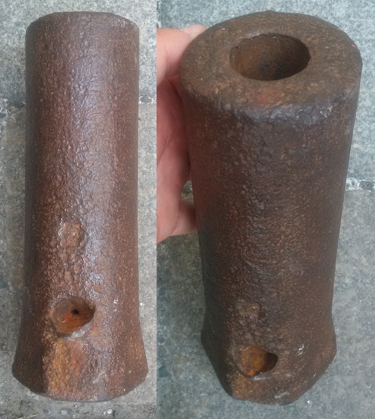

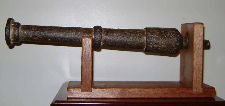

Certainly not a hand cannon. It stands upright, with a base slightly wider than its top; and a 'caliber' too large for a gonne. Let's call it mortar; some call it böller.
I bought this one more due to its attitude (read shape). I never realized the walls of these things are so much thicker down by the 'chamber' ... as cannons often are.
Very heavy; 5,3 Kgs.
It would be Portuguese ... in principle. Its age, i don't know; these devices are hard to date. From the XVI to the XVIII century all is possible. Anyone able to narrow this date range ?

Trying to narrow down the chronology is indeed tough on something like this. This is a type of böller, I would think, because its shape calls for it standing upright. Even if the barrel was provided with a socket, or shaped to fit a stock, its conical bore would make it impractical as a projectile weapon. The problem with such a bore is that a ball of any given size would only go down to a certain point, and deciding what point is optimum in relation to the volume of powder is critical from a safety standpoint because if there is any air space in between, excessive pressure can be generated by the explosion, turning the barrel into a little bomb.
As a noisemaker or signal device, the design of such a device can stay unchanged for a very long time. There are three- (or more) barrel versions of these, forged of iron, found in different Far Eastern countries and the ones from 17th cent. Korea can hardly be distinguished from those from 19th cent. Indochina. So the generous range of dates that you suggest is perhaps the most realistic assessment.

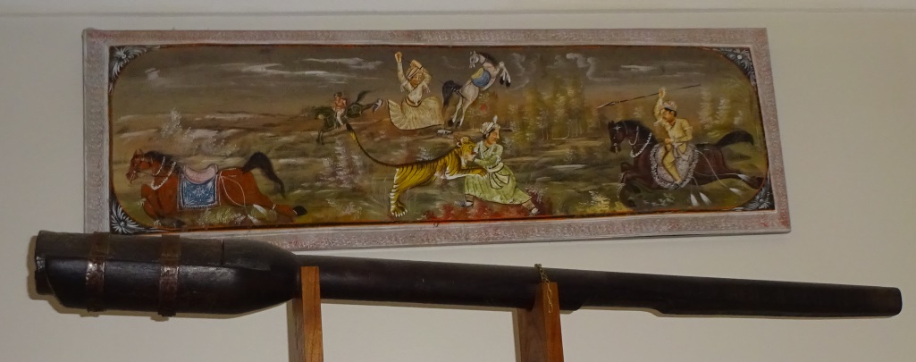

Dear Fernando,

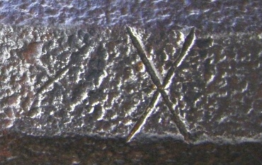

You're certainly right, this is not a cannon. it is a noise maker indeed. Here is another similar one, with even thicker walls and heavier, over 10 kgs. You're right they're hard to date. one option is to compare them with marked and dated ones. This one has several marks on the body and based on them and other features someone knowledgeable (not me) put it to early/mid 1700's. I think yours is not far from that.

I have some examples with marks, but none explicit, apart from the little 'dots' that apparently date from a determined period.
My heavier one weighs 15 Kgs, but such one is in principle a 'portable' cannon.
For some of them i have built a base, or a stock, trying to simulate period devices, as i observe in the web; notwidstanding the usual dilemma to distinguish noise makers from actual cannons.

You have wonderful displays. Seeing both noisemakers and short cannons side by sides I can see why would one have difficulties distinguishing them with certainty. Apart from size, any other characteristics that define each?

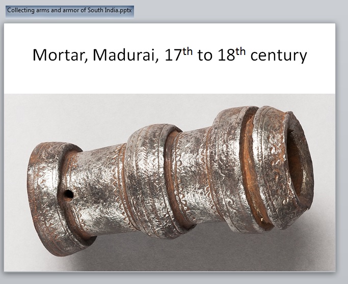

Also, just saw Mr. Elvis' PowerPoint presentation "COLLECTING ARMS AND ARMOR OF THE SOUTH INDIAN WARRIOR", and noticed this... just saying
Old 6th June 2017, 06:02 PM   #11
Nice (so called) mortar from Madurai. Let's add the support text that comes with the picture:
" This mortar has a 1.3/4” bore and was probably mounted on a wooden stock which was inserted into the ground ".

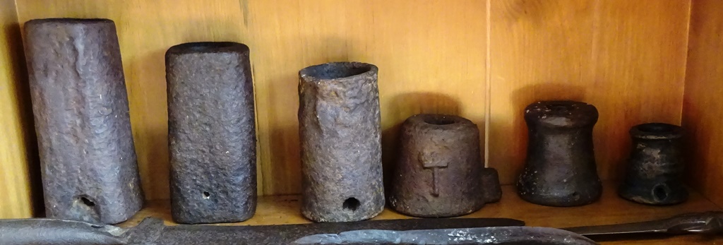

This brings us to the question you are posing about distinguishing noise makers from cannons. I would start by reiterating that 'noise maker' is a rather vague classification, as those things have had multi purposes, other than just noise making. Let us call them 'non cannons' only for this conversation sake.
I take it for me that the basic ways to classify them are:
- The shape; if it has a design compatible with being standing up, often (but not forcingly) with a base (breech) wider than the mouth. Also if their profile is irregular, in away to make it unfeasible to insert them in a cannon stock cradle.
- A 'lip' on the (ignition) touch hole; again this is not an obliging detail, but only when the ignition is obtained by priming the touch hole with some powder grains, so that the powder doesn't spill. However this doesn't take place when the ignition is done with a piece of match cord. A further note to be considered is that, some (not frequent) times this lip is not a lip, but a protrusion to protect, in hand cannons, the gunners face/eye.
- The bore width, when is 'too large' to make it reasonable to lodge a projectile; 'non cannons' were filled with gunpowder and plugged with whatever material ... but no bullet.
On the other hand, this example from Madurai is called mortar. This is a tricky term in typology, depending on period and context. According to the author, this mortar might (might) have been mounted on a stock; still he doesn't call it cannon, but apparently this was made to shoot some kind of projectiles, judging by the stock attitude and a 'caliber' that would be within a range plausible to fit cannon balls or other damaging stuff.
Other than the above, only knowledgeable people may discern further distinctions. I am only a novice and, most probably, what i said above is not 100% reliable.

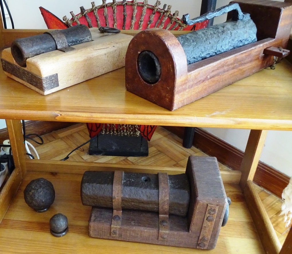

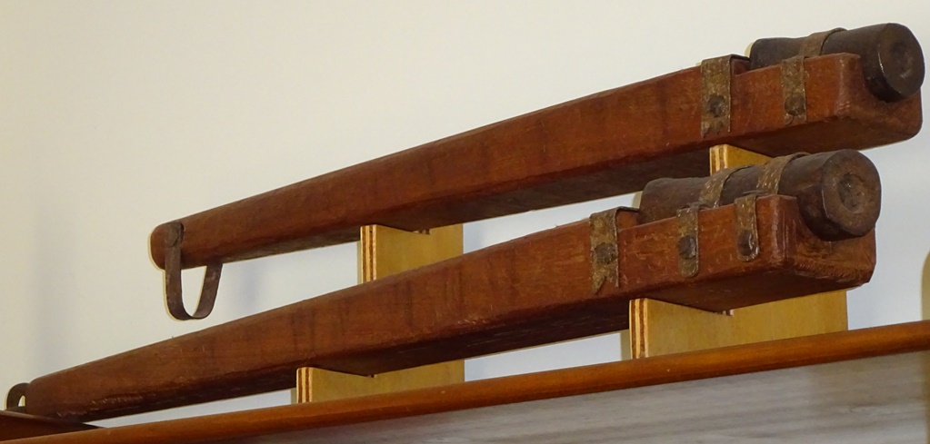

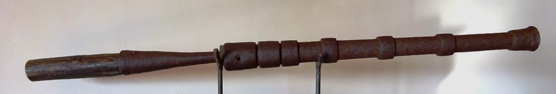

Attached are a 'Schopettieri' type and a 'Montjuic' type early cannons from my little collection; these are rather easy to distinguish.

Fernando, muito obridago! Your presentation and display are worthy of a museum. (but a very unique museum where cats have the run of the place!)
The one with the "rat tail" handle sticking up on top, isn't that the chamber piece of a breech-loader?
Old 10th June 2017, 11:16 AM   #13
Eu é que agradeço, Philip
In fact, there are two breech loading chambers in the pictures. They were within focus, i let them stay.

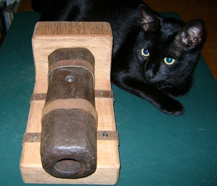

You are right about who runs things around here ... and they make a point in so showing .
Here is Adriano (not with us any more), supervising works on a cannon stand.
