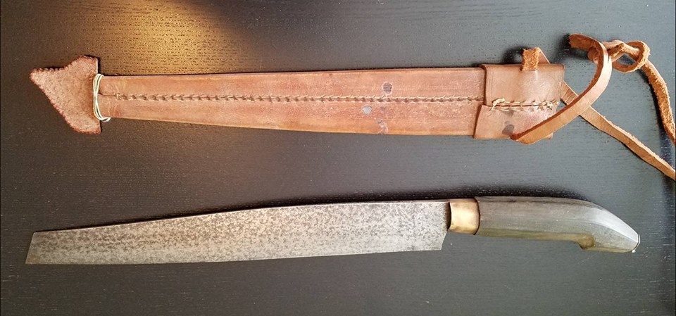

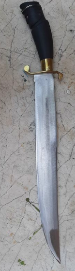

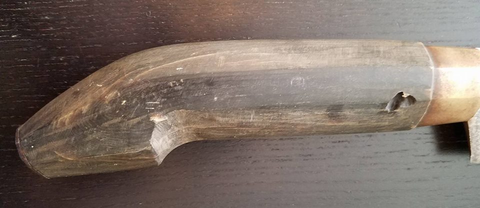

Hello All,
I don't have this one in hand yet, and thus the pics are from the seller. I usually wait to post new pieces until I have them in hand, but I realized tonight that the tooled design on the scabbard of this tabak matches, nearly exactly, the design on a matulis I have from Apalit. The hilt shape also looks distinctly like others I know from Apalit. I suspect this then is also from Apalit Perhaps even the same maker.
The matulis in question is the first (and longest) one here.
http://www.vikingsword.com/vb/showthread.php?t=22118
I'll post more pics when I have it in hand.
If I had to guess, I might place this at early 20th century?
What do people think?
Have fun,
Leif

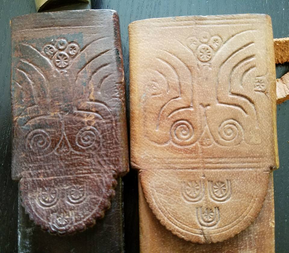

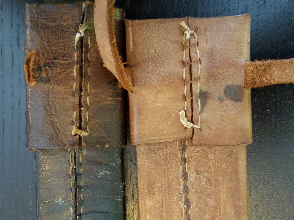

And for comparison, the design on the previously posted Matulis

Hi Leif,
agree with nearly all your observations but I think that the scabbard is much younger as the tabak.
The knife byself I would place between the 1920s until 1940s but the scabbard looks much younger. Courious to see your pictures.

Do you think the scabbard is significantly younger in both cases?

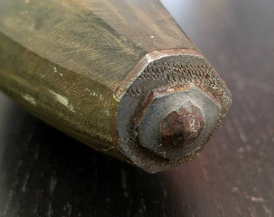

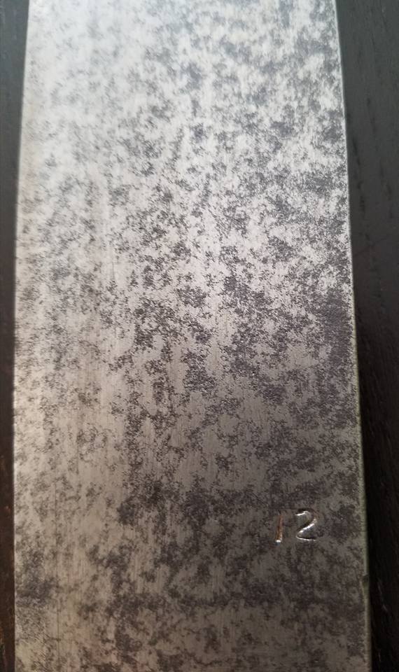

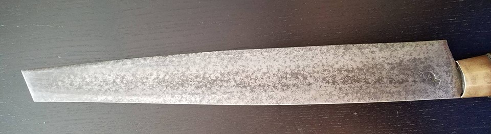

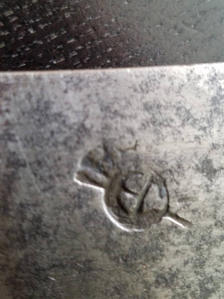

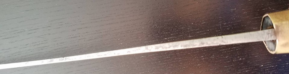

So it arrived today! Quick shipping. These are after a bit of light cleaning with soap, water, and for the brass ferrule, lemon juice and salt.
Both the Blade and the scabbard are marked with the number "12." One side of the blade as what might have been intended to say "Apalit EB," but the stamp is unclear. I'm including side by side comparison of the tooled patterns on the tooled leather scabbard. They're nearly identical. The rear side of the scabbard shows similar construction.
Also, does anyone have any thoughts on caring for the leather? It's rather "dry" at present.
Thanks,
Leif

No, you are correct, I think the tabak is complete (sword & scabbard) younger as the other sword.
I use shoe polish for leather scabbards, it works great for me.

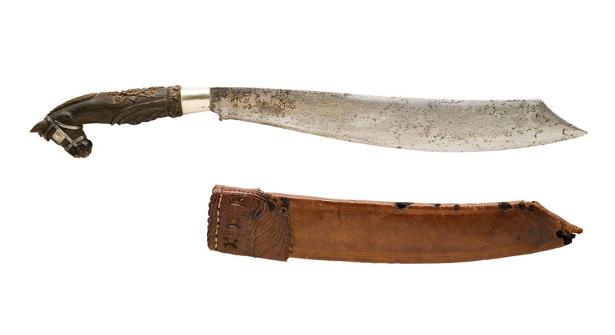

211. Luzon Tabak
Period : Post 1900, Katipunan Era.
Hilt : Detailed and intricately carved carabao horn hilt in the shape of a horse head detailed silver reigns and eye cover. Round silver ferrule. Intricately carved floral motif. Peened tang.
Blade : Chisel ground blade with the clipped tip. Blade is inlaid with silver in floral motif.
Scabbard : Tooled leather scabbard with leather throat.
Origin : Northern Luzon
Overall Length : 49.2 cm [19.4"]
Blade Length : 33.2 cm [13.1"]
Handle Length : 16 cm [6.3"]
Scabbard Length : 32.5 cm [12.8"]

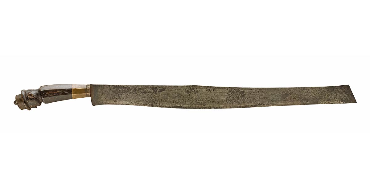

212.
Luzon Tabak
Period :
Hilt :
Carved carabao horn in the shape of a human figural head with hat/cap. Hilt with octagonal brass ferrule and cap with peened tang construction.
Blade :
Long clipped tipped blade. Typical blade shape used by Katipuneros.
Scabbard :
Not available
Origin :
Southern Luzon, Batangas
Overall Length : 65.2 cm
Blade Length : 50.2 cm
Handle Length : 15 cm
Scabbard Length : No Scabbard
* On further consideration, I would say this one is also Northern Luzon. The hilt is typical of Tinguian knives and the blade shows the small cut-out feature adjacent to the hilt that is seen commonly on Tinguian knives.
The figural hilt on the last one is definitely Ilocano in origin, probably from Ilocos Sur, and is termed sinan-kapitan or Antonio Luna according to migueldiaz. Antonio Luna was an Ilocano hero of the Philippine Revolution.

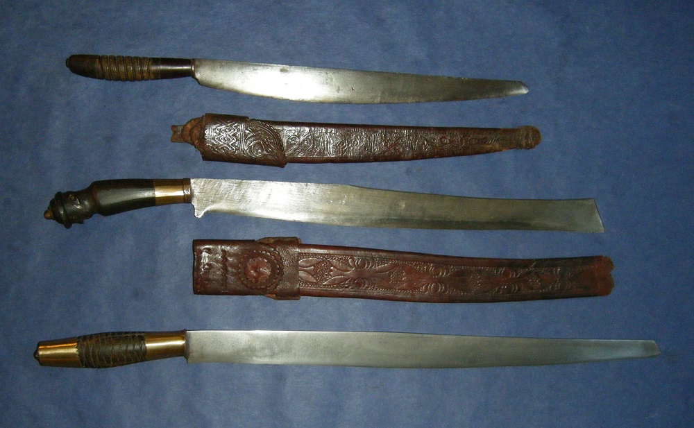

Interesting discussion, thank's for that.
To learn more I would like to add my examples to the discussuion.
The upper one I would call tabak, I've described it as from Luzon/Pampanga, end of 19th century. 47 cm out from scabbard.
Second example is a katana, handle sinan kapitan, Luzon/Ilocos Sur, first quarter 20th century. 56,4 cm. Similar to the third example from the Macao exhibition.
Third one I am unsure about, I would say that it's a tabak, can't say something about the exact origin but think Central Luzon, end 19th century(?), handle has had once wire binding. 62 cm.
Any additional informations or remarks are very welcome.

Your labeling of 'tabak' is correct in a general sense, as I've stated earlier- in Tagalog, 'tabak' means combat blade. So technically even minasbads, matulis, dahongpalay, bulongpagay- all Luzon fighting blades- fall under the umbrella term 'tabak.'
Would just like to clarify, is your first sample chisel-grind or convex?
Regarding your second sample, it's wholly endemic from Ilocos, and it's not a katana. It's different from the sample in the Macau exhibition.
The third one is a katana, and quite a long one. May I know the blade measurement in inches?

The first blade has a convex edge. How you would call it? And would you agree by the estimated origin?
So the second piece is like guessed Ilocos (Sur?) and not a katana, how you would call it?
Third one a katana, any guess about the exact origin? It's 24.4 inch long overall, blade 18.5 inch and 0,31 inch thick at the base/handle. A very heavy sword.

Dear Detlef:
For the first- oh so it's convex, I'd guess it to be of Apalit origin then. I'm not familiar with the blade profile, so calling it as a generic tabak is fine =)
For the second, it's confirmed to exist (and is still being produced) in Ilocos Sur, but am still determining if it's also present in Norte (although not likely). It's termed as 'panggaw-at,' which is the Ilokano term 'for reaching.' For reference, I'm including a picture of my 2019-made sinan-Gabriela panggaw-at (along with a sinan-kapitan bulong pagay).
For the third, as I understand it, all katana-type blades originated from Apalit. I don't think any other area produced that specific type.

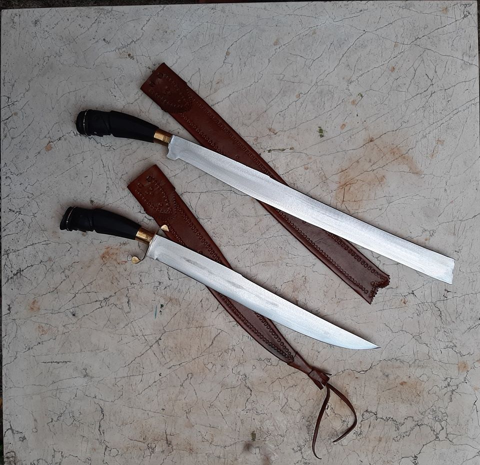

Regarding your question about delineations, on my mother's side- my grandmother is from Pangasinan, and my grandfather is from Ilocos Norte. Each area in the North- Pangasinan, Pampanga, La Union, Ilocos Sur, Ilocos Norte- have different versions of Ilokano as a language. There is clear delineation and pride on what is Ilokano (Ilocos-specific), Pangasinense (Pangasinan) and Kapampangan (Pampanga). In fact the non-Ilocos residents prefer not to be known as simply 'Ilokano.' It's not far-fetched to think that there's clear distinction between the blades they produced as well. The Indigenous People (IP) tribes' blades differ from the others. This was verified by an Ilokano who talked with the tribes' elders. The IP traditional blades are another matter altogether (another complication).
With regard to the 'katana' being made in Ilocos Sur, I acknowledge that I may be mistaken, but I still hold on to my assertion. I only came to that conclusion because Ilocos Sur has its own version of blunt bolo which has a different build and label than 'katana,' the 'panggaw-at.' In terms of blade profile, the features of 'panggaw-at' are absent from that piece; but it adequately fulfills the features of a katana's. Lastly, I did mention that my source was featured by migueldiaz long ago- his name is Antonio Pader, and he's regarded as one of the Living Treasures of Ilocos. He's a 4th generation panday and artisan; his family has been forging and crafting blades well before the 1900s, and he is the heir of the accumulated knowledge of the pandays before him. There's no better source of information than him with regard to Ilocos Sur traditional blades.
I've yet to conclude my research on Northern Luzon blunt bolos, but the way that it's going, there are more nuances than previously thought, and the current number of unique types may increase, once I've scoured Ilocos Norte as well.
Old 19th February 2020, 08:58 AM   #17
Posts: 4,473
Dear Xas:
Again thank you for your patient reply. I am grateful for your sharing of what you have already. I do appreciate that you are in a difficult position.
Old 19th February 2020, 08:23 PM   #18
Posts: 9,347
Originally Posted by xasterix
Dear Detlef:
Thank you very much Xas!
