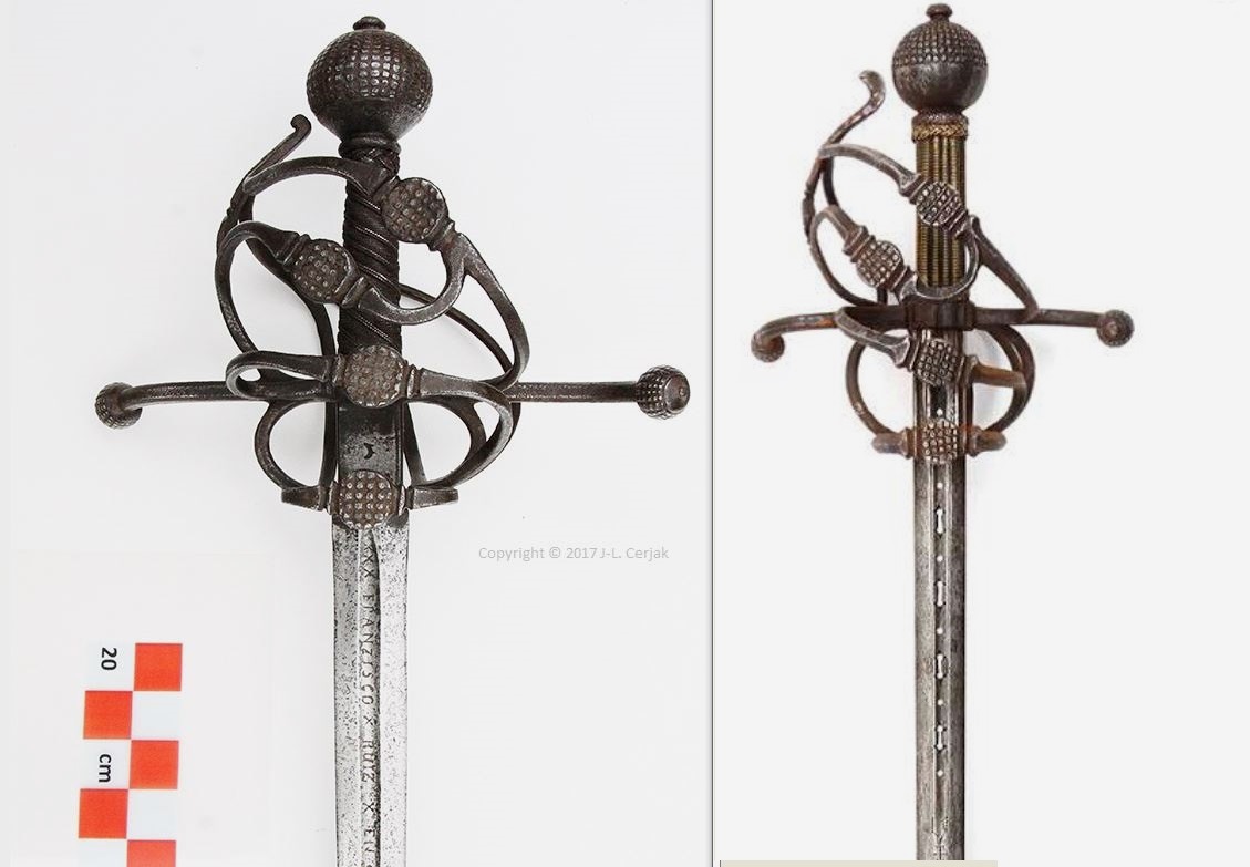

A Spanish rapier Early 17TH century
O.L. 115.8 cm ; blade L. 101 cm.
Blade marks: Francisco Ruiz Toledo
Any comment on it would be welcome.

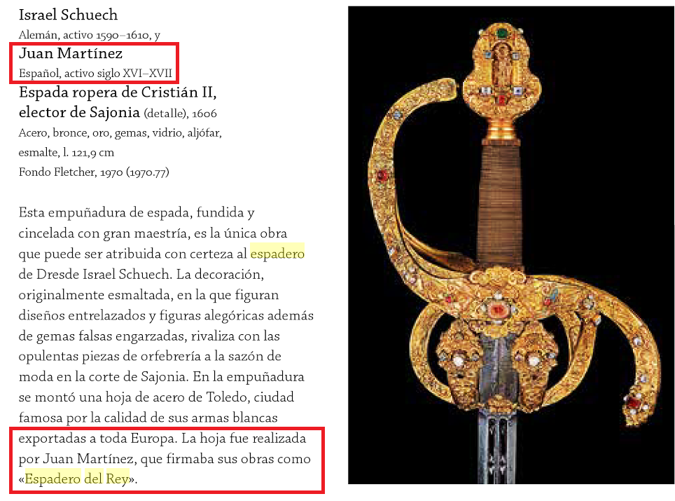

In one example shown at the Ministery of Culture, we can read:
En el primer cuarto de la hoja, Grabado
´DE FRANCISCO´
´RVIS EN TOLEDO´
Datación 1601=1700

I am intrigued by the unusual motif in this rapier hilt, and tried to find something comparable but my resources seem disturbingly limited and nothing close.
I am curious on the inscription in the blade, and it seems the Francisco Ruiz name was not only well established, but so much so that like Tomas Ayala, it was often used spuriously on German blades. Perhaps that has also lent to the use of this renowned name on a number of more modern productions.
What seems notable is the uneven character of the letters in the inscription and the curious use of the letter Z in Francisco, which seems atypical.
As Fernando notes, it would seem that in an early blade, by either Francisco Ruiz the elder, or the younger for that matter, would have the appropriate punzone at the forte.
What is there instead, is a crescent, of a form more in character with such stamps in pommel or hilt elements, but I presume this is to allude to the use of the crescent by Spanish makers Del Rey.
It would not seem unusual to find a Spanish blade in the Netherlands and in a German style hilt as this was of course a Spanish province from the late 16th into 18th c. Going back to the inscription, I have been under the impression that in Solingen stamped lettering was 'racked', thus in groups so as to ensure more evenly and uniform lettering. That is why this one seems so unusual and unevenly applied. If this sword was a German product of 17th century, it seems the inscription and a punzone (even if not correct as was the case with the Stantlers in Munich in their use) .

The hilt is a combination of norman type 74 and 77.
The globular pommel characterizes Dutch rapiers.
The grid pattern was found on several arms and armour around 1570-1580, see for example the pommels and round finals of different dussages.

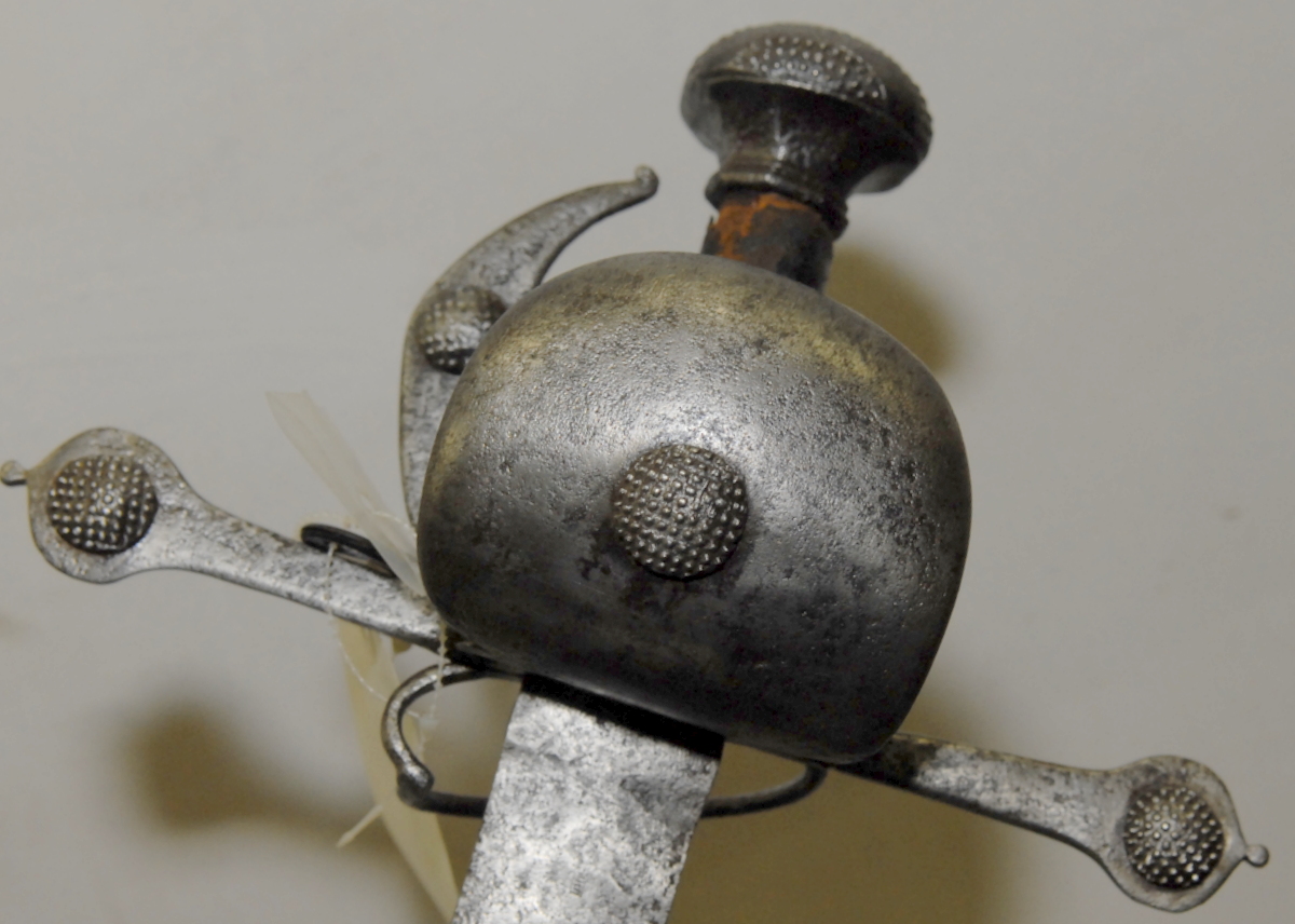

Globular or spherical pommels per se weren't restricted to the Netherlands. Note a north Italian example, inv. no. 1776, Museo Poldi Pezzoli (Milano), publ. Boccia/Coelho 1975, #485. The swept hilt is cataloged as 1580-90, from Belluno; earlier riding-swords and backswords from this area which are practically identical to Styrian counterparts also share this feature (Coll. Luigi Marzoli, Brescia, inv. no. G 21 and G 23). A faceted version of the sphere can be seen on a somewhat simpler swept hilt on a rapier identified by Capwell as possibly Italian, 1570-80, Wallace Collection inv. no. A576, publ. Norman 1986, p 134.
Grid filework is also seen on a few Italian rapier hilts, q.v. inv. no. 2575, Museo Poldi Pezzoli, with an example depicted in art, "Portrait of a Gentleman" by Bartolomeo Passarotti 1571, Museo Bardini (Firenze), both publ Boccia/Coelho 1975, # 465, 466-67. It must be said, however, that these Italian examples are a bit more elegantly proportioned than the hilt on the sword discussed here.

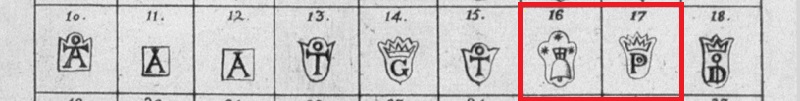

On the mark of the 'Espaderos del Rey', from Wallace Collection (Sir James Mann, 1962):
A545 (p.279), a rapier c.1620, "...the incongruous combination of a Toledo mark and the half moon of an Espadero del Rey with the name of the Italian bladesmith Andrea Ferara suggest this is a product of Solingen".
A652 (p.331), a cup hilt rapier Spanish c1635; blade German (?)
"...the ricasso, inside the cup stamped on each side with a makers mark and the half moon of an Espadero del Rey. "
Further noted the the mark ST is said to be for Tomas de Ayala and that the Stantlers of Munich also used the letters ST (a crowned ST) along with the name Sebastian Hernandez. The four sided blade on this example is noted to not be usually found on cup hilt rapiers.
It would appear that the half moons (which typically look like Tarot card characters with man in the moon face), were somehow often used along with makers punzon in Spain, for Espaderos del Rey (the Kings artisans).
However it is unclear whether this was a broadly used designation or strictly for select makers. The only maker noted as such by Palomares was of course Julian del Rey (with the perillo, or little dog, rampant) but no note I am aware of) with a half moon. If there is such instance you are aware of I would be grateful to know.
Clearly, the half moon mark became part of the Solingen repertoire of symbols and devices used by Solingen smiths along with other spurious Spanish names and punzones, and eventually became part of the astral groupings inscribed in Solingen blades.
This simple mark, looking in Rorschach test parlance, like a crescent (but facing the wrong direction) seems possibly an incongruent attempt to allude to the Spanish theme inscribed in the fuller with Ruiz' name.

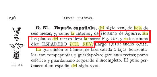

Whether Wallace material has a reliable significance, i can see no way that a symbol like a half moon is intrinsic to Toledan or other location smiths being appointed to the King. As for legitimate marks of such Masters, i would go as far as realize that the crown in some of them is a facultative procedure, one of his own choice, that not an imposition; this meaning that, the designing of each one's mark, be it one inherited from their family or made before such previlege was attributed, doesn't implicate in its mark composition including the crown.
Reading further in an article by Germán Dueñas Beraiz, a real expert in these things, he reminds us the Academy history records in that, what happened when a Master received the said privilege from the King, based on his known expertise or some service done to the Sovereign, was that he started signing the phrase Espadero del Rey in full words in the ricasso of the blade.
... algunos de ellos, por su sobresaliente habilidad o algun servicio a la Magestad, lograron el titulo de Espaderos del Rey, grabandolo en sus Espadas con todas letras en los cantos del recazo, como fueron Nicolas Hortuño, Juan Martinez, Antonio Ruiz,
Not only they had the right to engrave such phrase but also enjoyed the privilege of being exempted from a determined number of taxes.
But one must also bear in mind that, the engraving of the signature in the blades, was not per se a guaranty that the sword was actually a work of the respective master; neither some marks depicted by Palomares resist confrontation with examples of swords by some masters kept in the Real Armeria. Yes, Palomares made a work that, being deeply respected by critics, is not exempted from some discrepancies; besides having built his work a good couple centuries after the 'real thing', had a 'crush' for his Toledo base, to the point that, this or that Master was reported to be from Toledo and having 'also' worked in other cities, actually were from such cities and 'also' worked in Toledo; the more screaming case being famous Julian del Rey who, same as his father and brother, developed his work in Saragoça having 'also' laboured in Toledo, contrary to what he reported. Also noteworthy was Julian's mark, which real one was not the 'perillo' shown in the nomina but a cross inserted in copper
Some birth and activity dates ae also not precise, as is the case of Sebastián Hernández the elder, reported active in 1637 when in 1584 he was already dead, and 1625 for Tomás de Ayala, when he had his splendor in 1560, having died in 1583.
One other thing is that Palomares is thought to have only resourced the marks by observing them in the Toledo Municipality archives whereas evidence shows, as above narrated, that he also or mainly recorded them from the actual sword blades.
Just as an aside, the more than 90 mark punzones that were kept in the archives, and apparently were all present when Palomares has been around, have meanwhile mostly vanished (?), only some 14 currently existing.

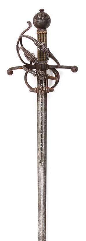

Sorry for barging in, as it is not my area of interest and expertise, but I think more of Italy or Styria rather than Spain.
https://www.pinterest.com/pin/366550857155039469/
That would explain the spelling.
No matter where from, it is a very good one.
I am not going to suggest "adopting" it, but for rapier lovers it is a nice catch.

Not at all Ariel, no matter on area of interest or expertise (I have no idea what mine really is! ) its good to have you enter in. I think the spelling conundrum may be as much with levels of literacy and language variation in Solingen along with workers skills. However the centers in Styria and Italy are a valid suggestion as they adopted these Toledo names spuriously as well .
While I have had my doubts on this one, must say it is growing on me! and it really is an attractive weapon. The grid patterns suggested earlier to me are compelling for Italian weapons as Philip has pointed out.
Thank you for joining in and the links!

The grid pattern was popular in the last quarter of the 16th century and probably originated from Styria. see dussages of post #7
for comparison, an Attachement of the same type of rapier.
best,
jasper

Whoa!
Jasper this picture is very important for me, Thank you for the gift!
How many peoples assist you in your research department?
What I could say is, that both hilts have been made by same hands.
Could you tell me from where you found this sword ?
Thank you very much!
Jean-Luc

I have been in contact with Germán Dueñas Beraiz, head curator of the arms section of the Army Museum of Toledo, author of several books on early weaponry.
Here is what he says about the smiths marks, the crowns and the half moon:
... La única marca para reconocer a un espadero del rey era la inscripción que colocaban en los cantos del recazo ESPADERO/ DELREY.
Las coronas en los punzones de espaderos toledanos son muy comunes, y en principio no hemos documentado que tengan ningún significado especial.
Por otra parte Palomares es una fuente muy interesante pero poco fiable a la hora de atribuir marcas, lugares de fabricación o nombres de espaderos, tal y como señalo en un artículo escrito por mi hace unos años dedicado a Palomares en la revista Gladius.
La media luna aparece en algunas hojas españolas, pero sin vinculación con marcas de espadero ni de ciudad.
De hecho Juan Martín no existió como espadero, refiriéndose Palomares a otro espadero cuya firma interpreta erróneamente, concrétamente a Juan Martínez, que por cierto si fue espadero del rey ...
And in case you won't bother translating, here is a lousy version:
The only mark to identify an espadero del rey was the inscription they applied in the edges of the ricasso ESPADERO/DEL REY.
The crowns in the marks of Toledan sword smiths are rather common and in principle we have no evidence of those having a special meaning.
On the other had, Palomares is a very interesting source but not so reliable, in what touches marks, production places or sord smiths names, as i point out in a article published a few years go in the Gladius review.
The haf moon appears in some Spanish blades, but with no direct relation with smiths marks or cities.
In fact Juan Martin has not existed as a sword smith, Palomares referring to another smith whose name he wrongly interpreter, in concrete to Juan Martinez, whom has indeed been an espadero del rey.

If you care for some examples ... the first at the Metropolitan, the second in the Real Armeria.
