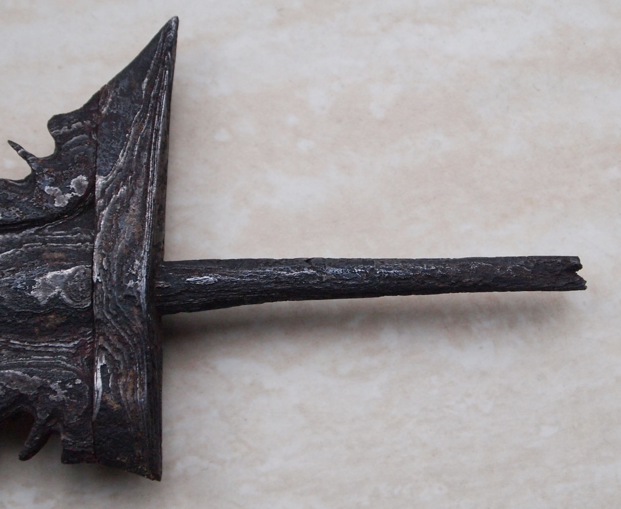

Could we see a photograph of the pesi of this blade E-Brain?

Old 14th January 2017, 10:51 AM   #11

Knowing some fellow keris-collectors will visite me later on today made me take the opportunity because at least one of them will be willing and able to put it back together again.
Old for me is at least 100 years.
