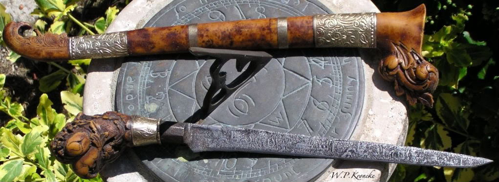

Jut got the sewar in the photos below and would like to know what kind of wood is the hilt made of?!
Any ideas are welcomed!
Marius
Old 1st December 2016, 11:22 AM   #2
Hi Marius,
could be kemuning wood, difficult to say because it's so dark patinated. BTW, it's a recent fake, so please send it to me, I will dispose it free for you! Nice piece!

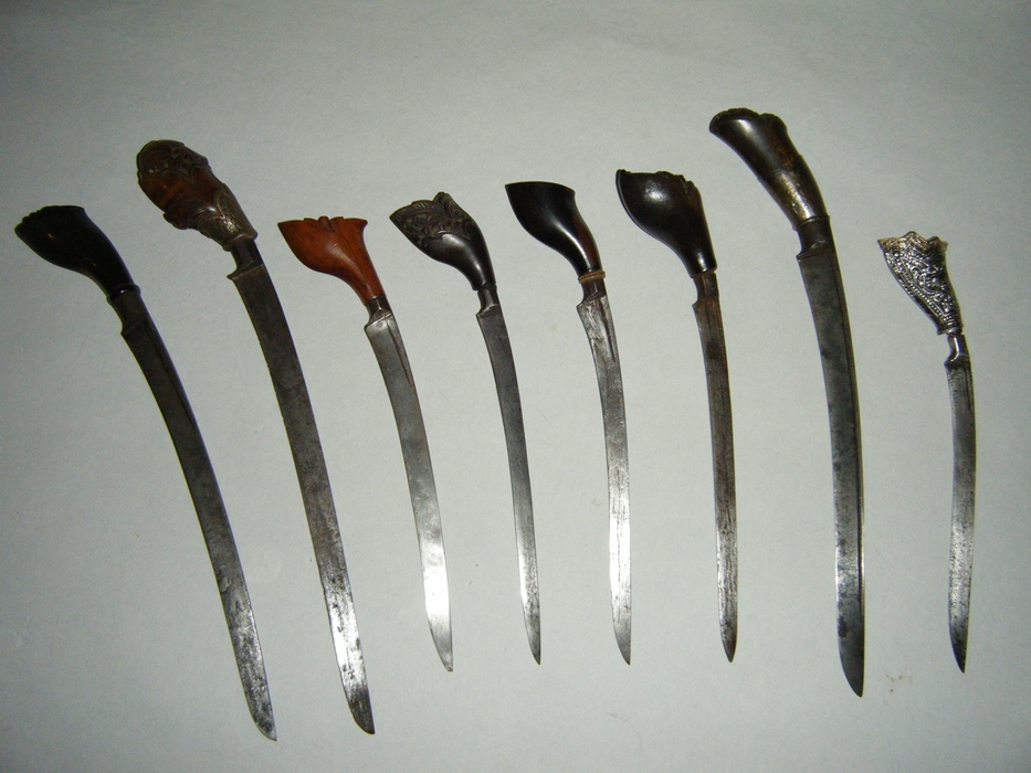

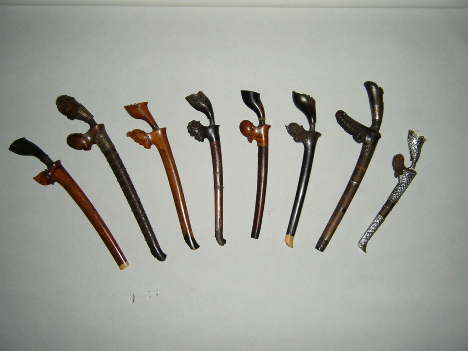

Old 1st December 2016, 11:58 AM   #4
Here my honest sewar collection for comparison!

Thank you for your comments!
I know the Parrot-head sewar quite well as I had one myself... and was quite fond of it... for a while... (I liked the writings on the blade)
So I think I will keep this one too... for a while... and when I will decide to dispose it off, I may ask for your most kind assitance (for the sake of environment of course).
PS: I have no idea about wood but in the photos of Kemuning wood that I saw, I couldn't discern the parallel stripes of lighter texture my hilt displays.

Old 1st December 2016, 02:48 PM   #7
Have a look here: http://www.vikingsword.com/vb/showth...light=kemuning or here for example: http://www.vikingsword.com/vb/showth...light=kemuning

Originally Posted by Sajen
Very interesting! Yes, it definitely could be Kemuning as it appears there are several varieties of Kemuning, some darker, some lighter, and some with stripes.
Thank you Detlef!
What do you think about Makassar Ebony?!

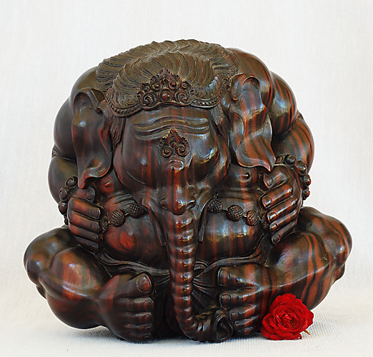

Posts: 7,255
Nice Marius.
I doubt that this wood is either kemuning or makassar ebony --- pic of makassar ebony below.
I do not know narra wood, in fact I've never heard of it, but I do not know names of S.E. Asian woods from outside of Jawa and Bali.
It could be sono kembang maybe, but it would need to have been quarter sawn to present that grain pattern.
If it is a root wood, or wood taken from a crotch or trunk burl it should have a high degree of chatoyancy, I cannot judge this from the photo. I doubt that it is from root, burl or crotch because the grain seems too regular. If quarter sawn it will probably have low chatoyancy or none at all, as opposed to the high chatoyancy we see in naturally distorted grain.
