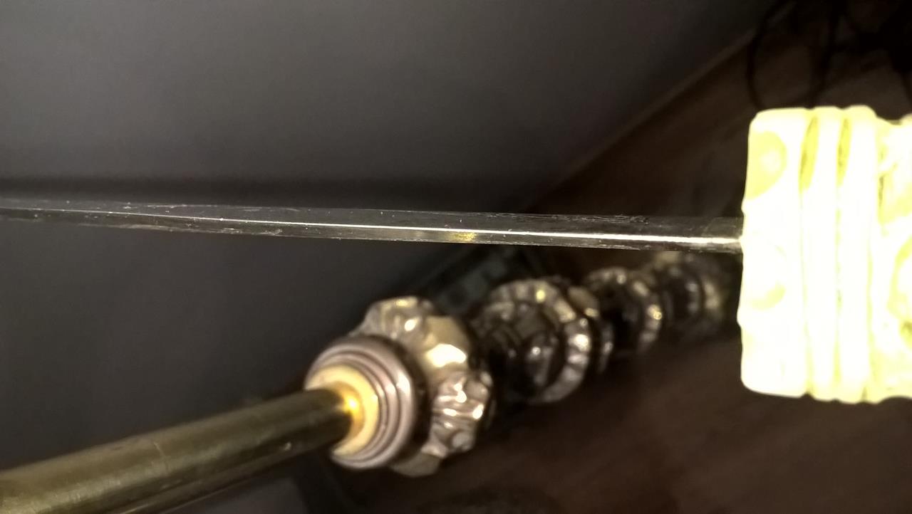

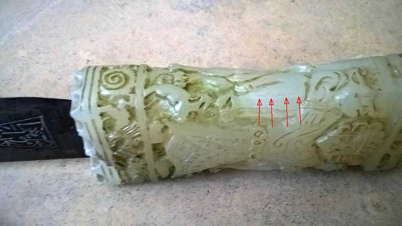

Hello
I`m writing to ask you for an identification of the dagger. Probably it comes from the period of the Mughal Empire`rule but I`m not sure, it`s a specific item. The hilt is made from jadeit and the carved motifs on it are specific too. I have never seen something like that before. Or maybe it was made as another turistic souvenir?It`s difficult to say and the blade looks as it had been used before. It is incrusted with silver and contains some symbols perhaps Islamic . Please for more information.
Alex.

Hello Alex,
Your suspicion is correct, it is a "touristic souvenir". It is not Mughal. The hilt is Asian (could be Chinese), the blade looks like cut from sheet metal, not forged. In my opinion this is more a fantasy item rather than anything particular or authentic.

A touristic souvenir with a jade hilt, are you sure? The hilt seems handmade without machine driven tools and the corrosion on the blade looks old.
But I'm just a collector, not an expert and for my eyes the pictures are not good enough for a proper statement.
Some macro-pictures would be useful.

The hilt material does not look jade at all (i.e. nephrite jade), and the work actually does look machine made and very crude. There are tons of jade/jadeite/quartz daggers currently being produced in India.
The blade could look old, but if it is cut of sheet metal - the look is irrelevant.
The form is actually of Turkish kard (very vainly), but nothing is right about this one. Here's the proper SAMPLE

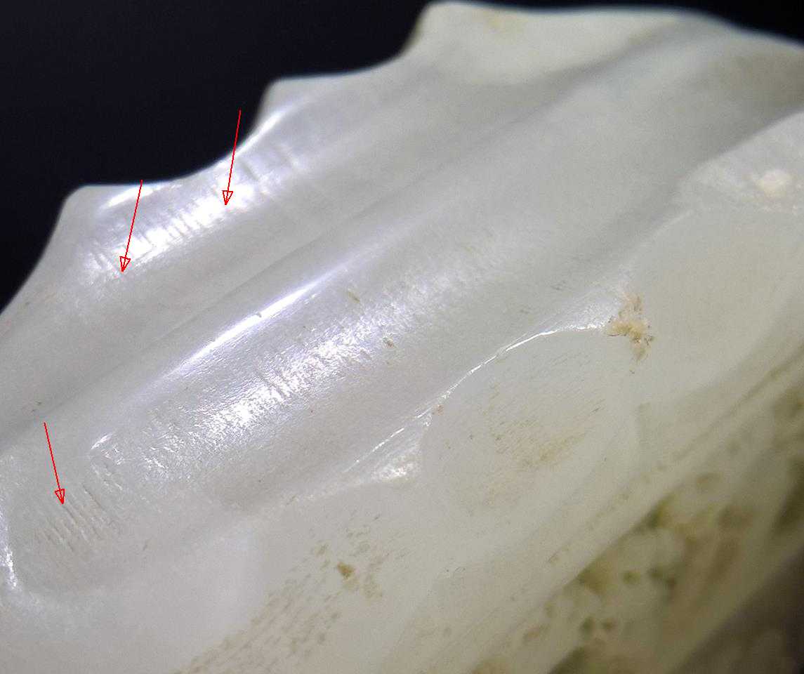

Originally Posted by donsamadhi
The carving on the hilt is not done mechanically, for sure! The specialist from minerals and rocks said that it was hand-made.
Alex.

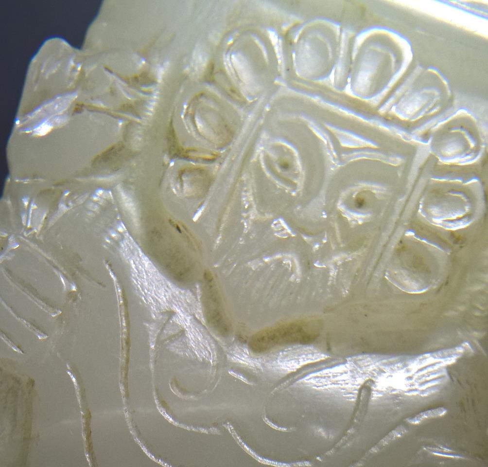

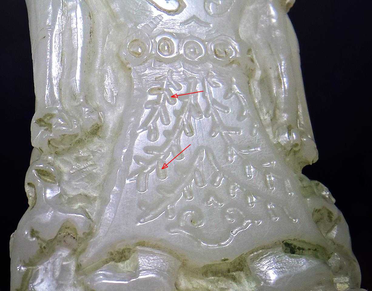

Hand-made... maybe in the sense that the electrical rotating tool that was used to make it was held in the hand.
Examine the grooves and engravings on the hilt under 10x magnification. If they have a circular cross-section, they are machined with a hand-held electric tool. If they have a crisp, triangular cross-section, they are carved/chiseled with a chisel.
But in the end we all believe what we want to believe.

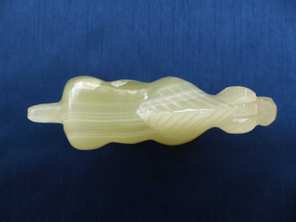

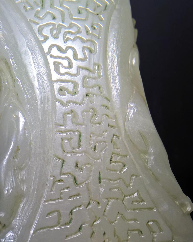

While, it is dificult to say from the photos, the material might be Onyx, which is found in abundance in Anatolia. The green or whitish varieties of Onyx not only look exactly like Jade, but also feel like jade to the touch and can be extremely misleading. I have seen also glass immitations of Jade that are extremely difficult to distinguish from real Jade (but those I have seen so far only in Chinese "jade" products).

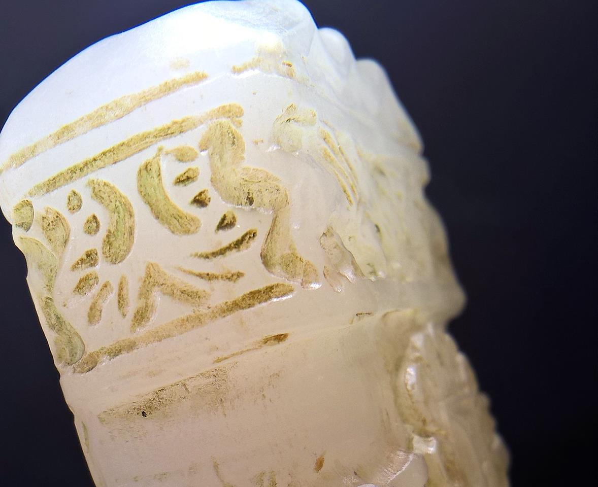

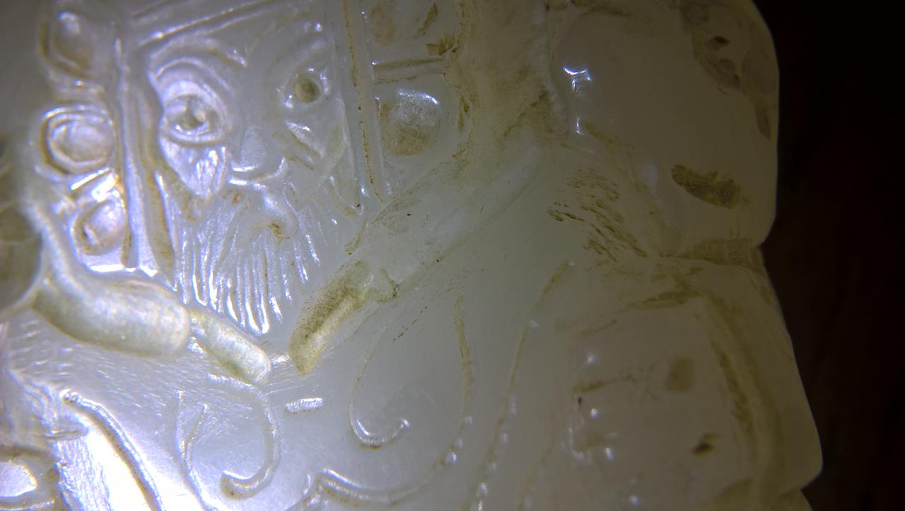

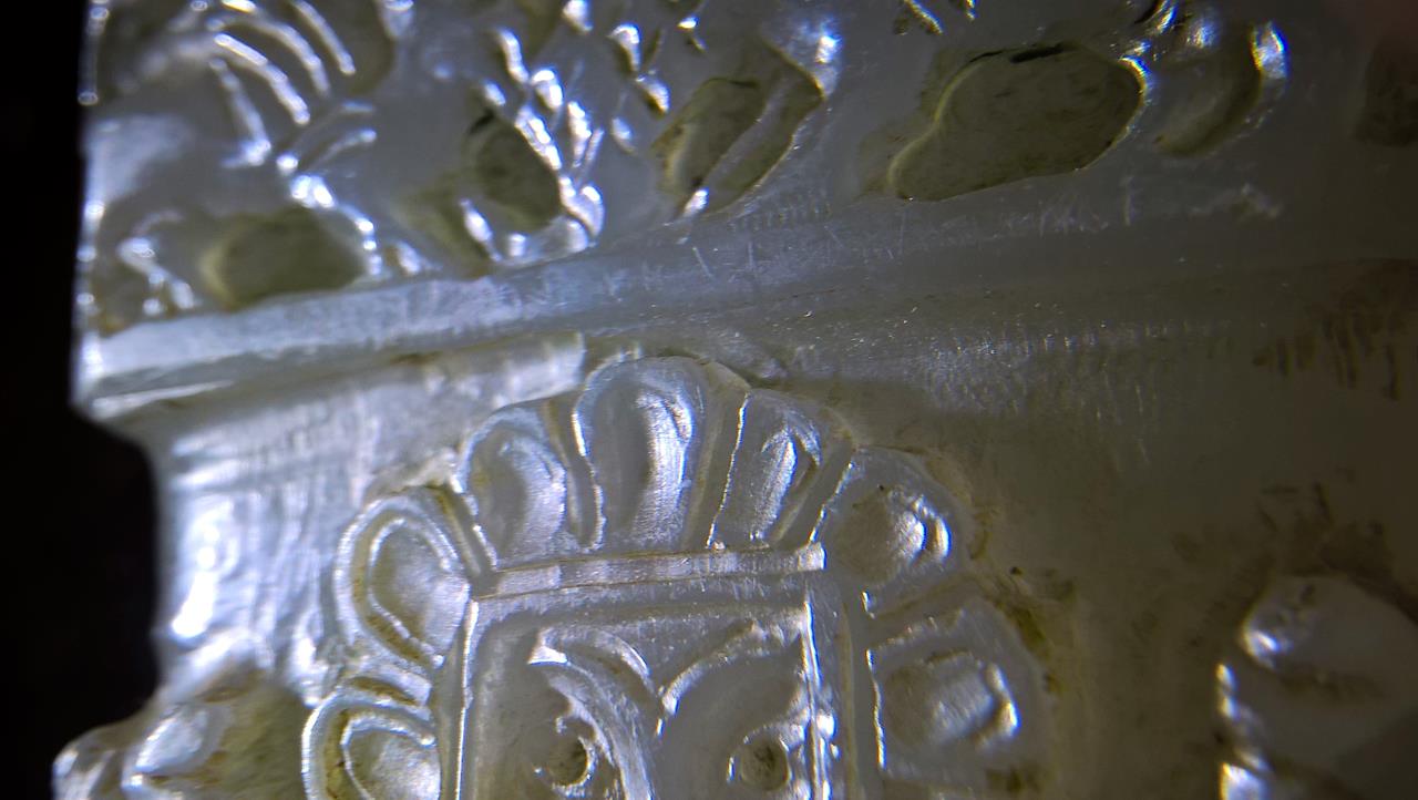

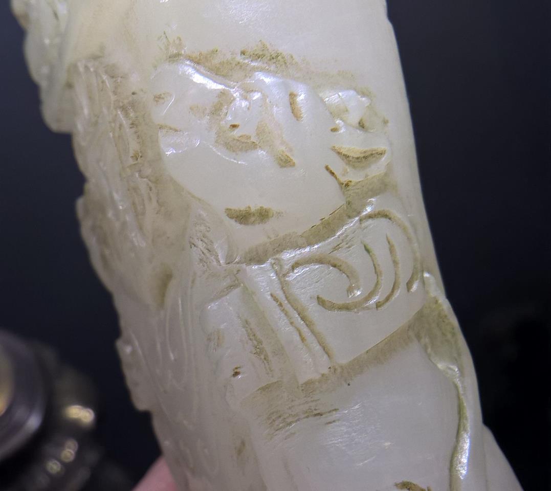

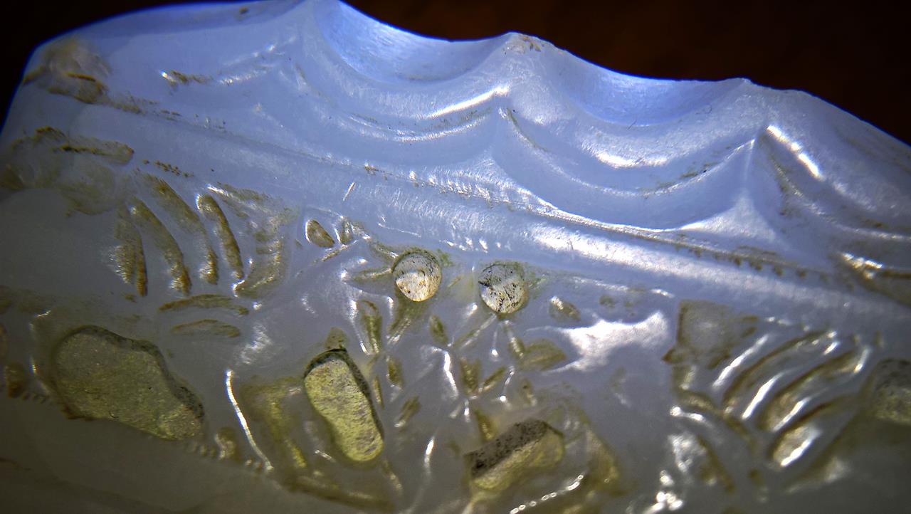

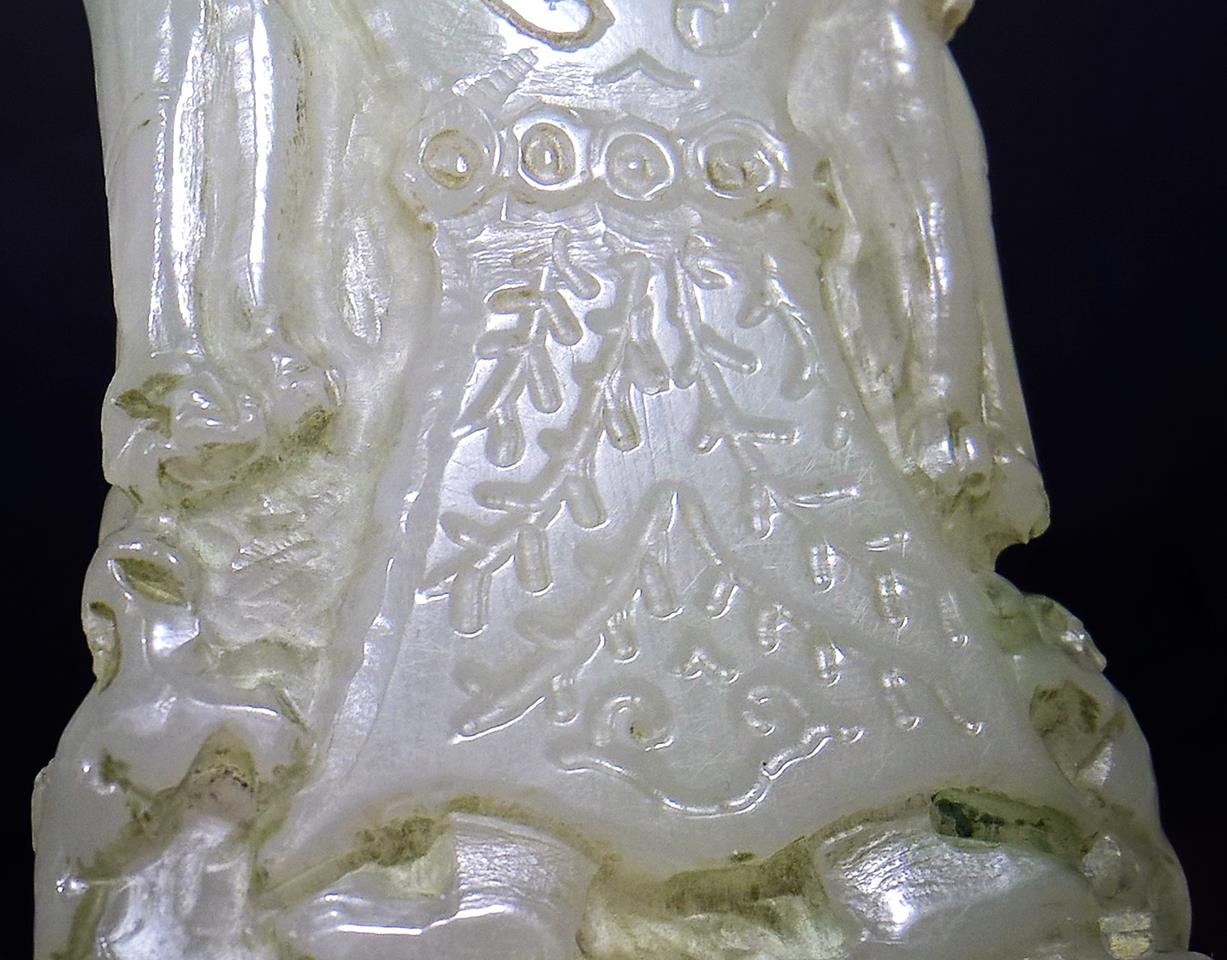

Lightbulb Extra photos.

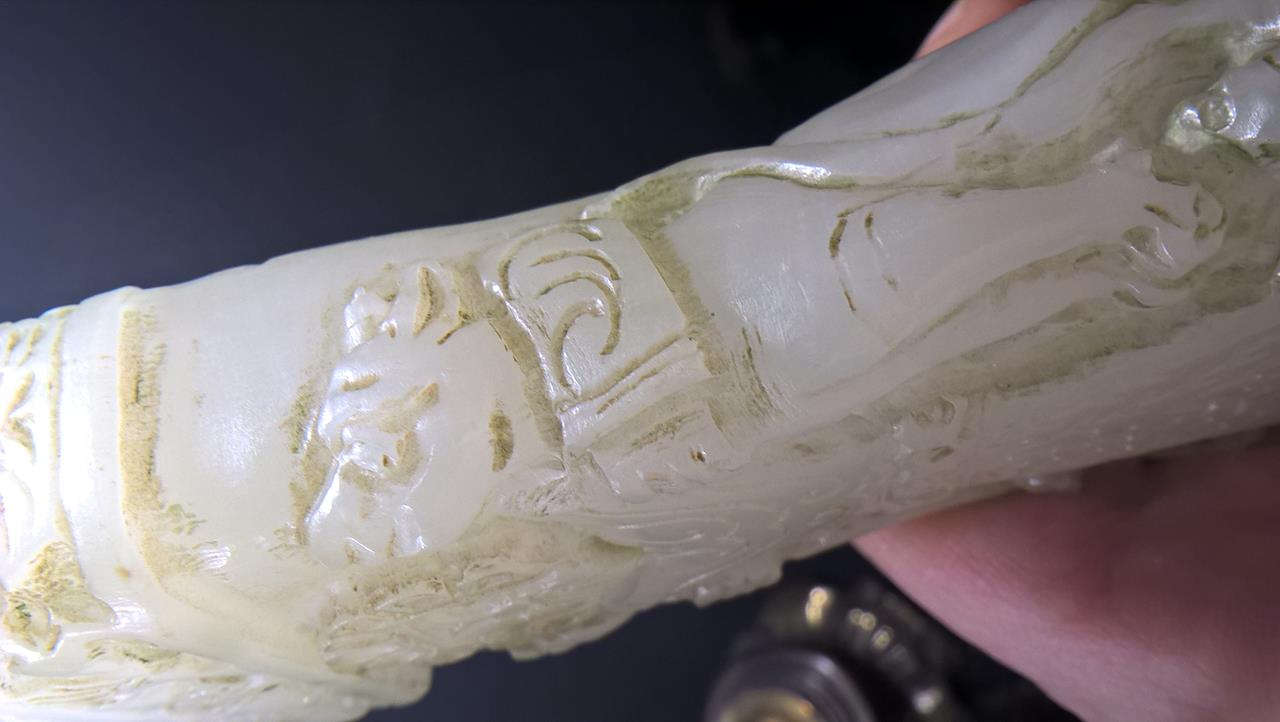

I attached better photos which shows that it wasn`t done mechanically
I think that Olivier`s opinion is the best, probably it was made as he said , from two different pieces of daggers. But is it a touristic souvenir??
Thank you all for your opinions, I`m waiting for more.
Alex

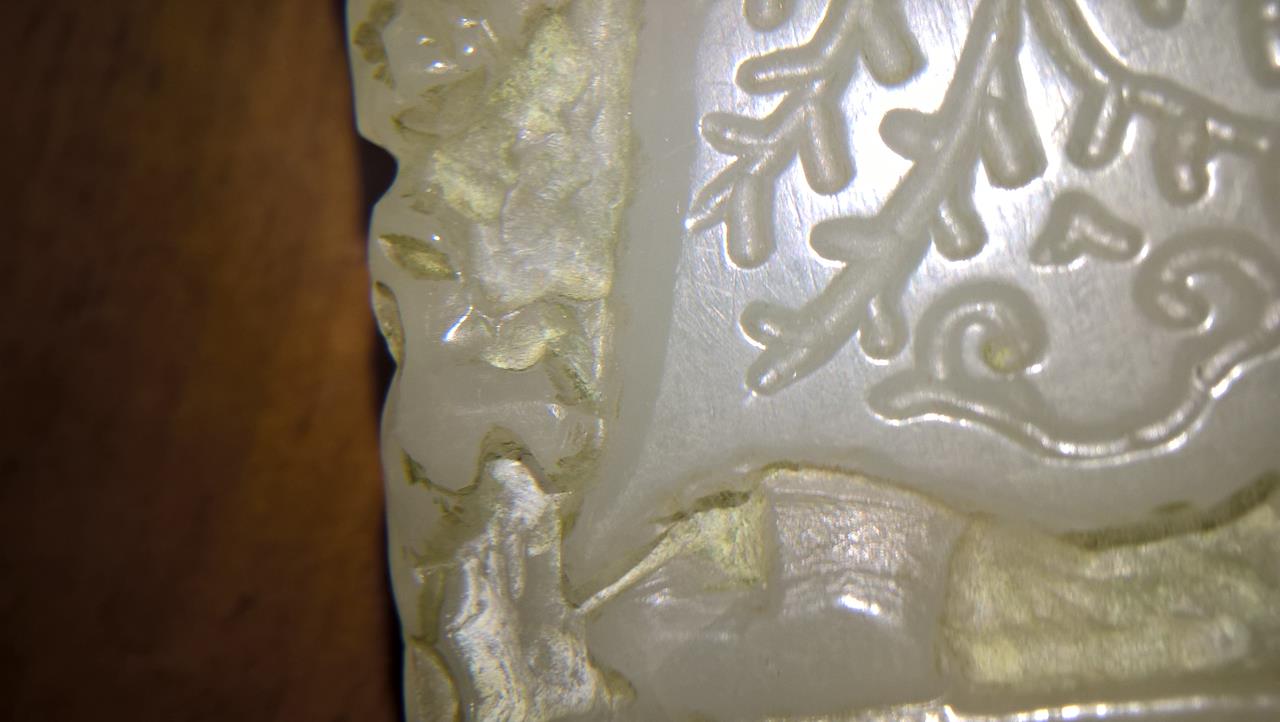

Thank you for the additional photos!
Certainly very poorly machine milled. No doubts about that.
Also pretty sure it is Onyx, very abundant in central Turkey.

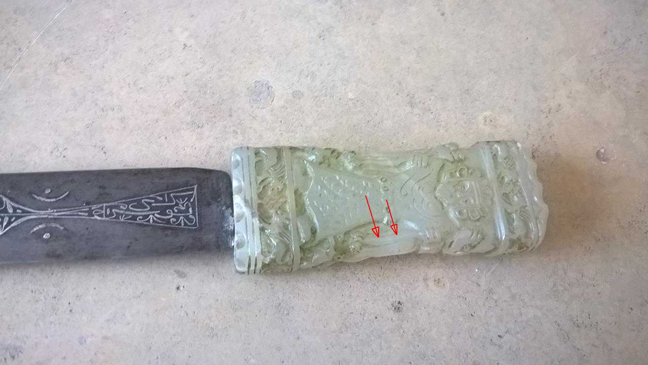

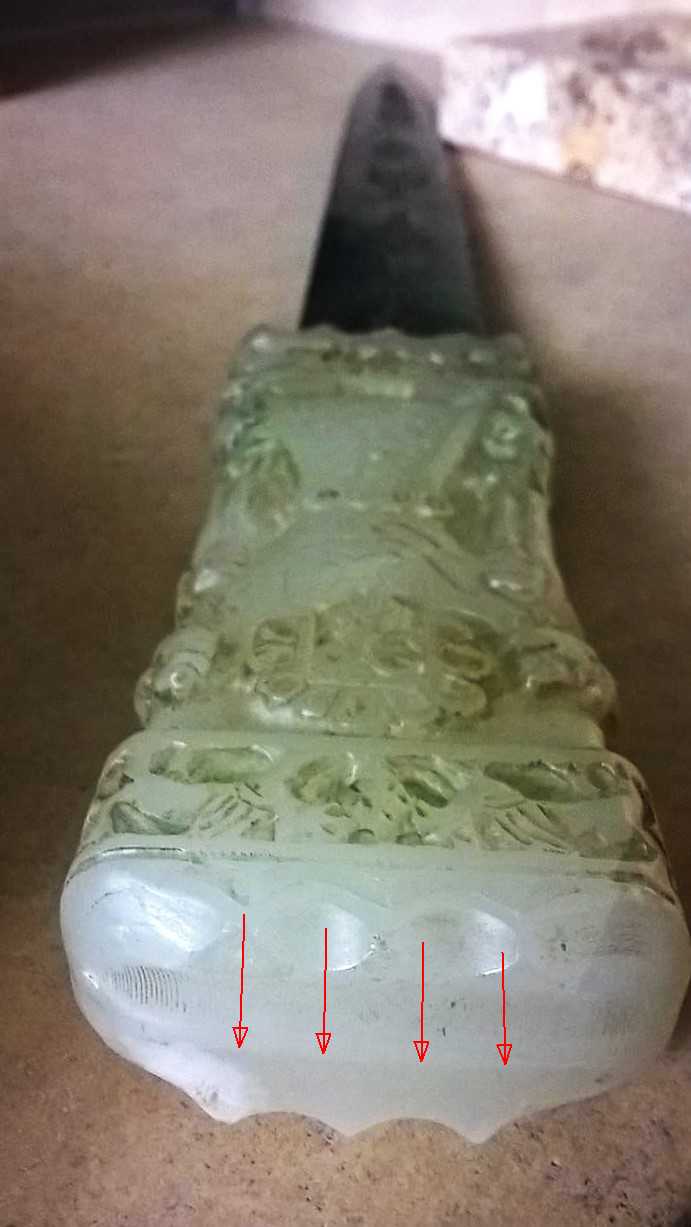

1. Why am I pretty sure it is not Jade (Nephrite or Jadeite)?!
1.1 Jade was and is in big demand and commands rather high prices. Therefore, it is used on valuable pieces of certain artistic value and not wasted on "tourist" items.
2. Why am I pretty sure it is Onyx?!
1.1 Onyx of precisely this coulour is found in abundance in central Anatolia and comes very cheap.
1.2 Onyx is charaterised in that it has a layered structure with parallel layers (see the photo of the horse) which can be easily identified also in the hilt (see the first three photos). Albeit I have seen pieces of up to 3 centimetres thick without any discernable layer.
3. Why am I pretty sure it was machined with a rotary tool?!
1.1 The grooves have circular cross-section and display transverse parallel traces of the rotating tool (see photos 5 and 6).
1.2 The entry/exit point of the tool is round (see last photo).
But I am definitely not an expert.

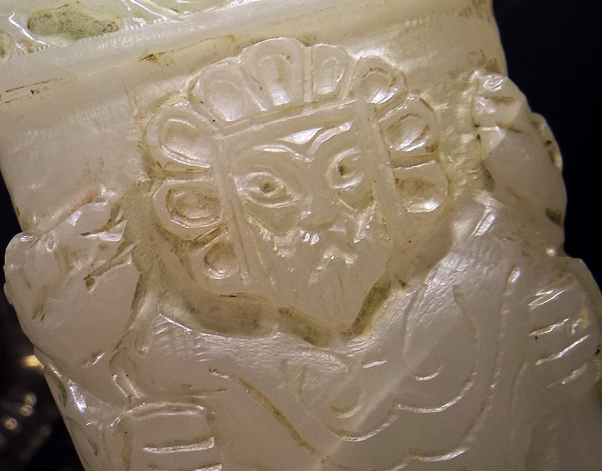

I must also add that the motifs and style of carvings on the hilt are not typically Mughal. Closest I have seen are more related to Persian, but the quality of the carving again is not like that found in Persian ivory hilts (albeit a softer material).
I must also agree with the possibility of dremel tool work looking at the micro-pictures.

I'm also with Marius et al. - clear signs of modern tools (and low quality work, sorry).

As Oliver pointed out, the blade looks rather typical Turkish made and the decorations on the hilt look Persian style, yet, they are quite different from the genuine Persian works.
The blade also looks rather thin and flat like cut from sheet/band stock steel and not forged.
So I would bet on Turkish origin, attempting to immitate Persian style.
