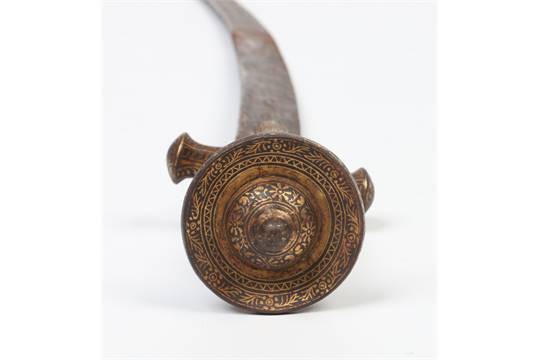

Default The floral decoration and hilt disc motif on tulwars
Could someone interested in researching, not help out a bit, and please start a research on the flowers on the tulwar hilts?
A lot of hilts/flowers are shown in my latest catalogue, so this could be a starter.
At the moment I cant do it myself, as I am wound up in researching some katar types, which I believe belong together, but I yet have to prove it.
What I know so far is, that they are from Rajasthan, ande the age seem to differ. They are shown in old catalogues, but the place of origin is avoided, and so is the age. So I will have to dig deeper to find an answer.
It would, however, help if someone will take the task to start looking into the flowers on the tulwar hilts - so we can move a bit farther than we are now.
Jens

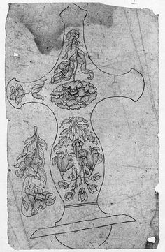

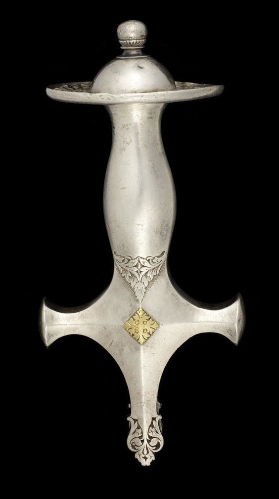

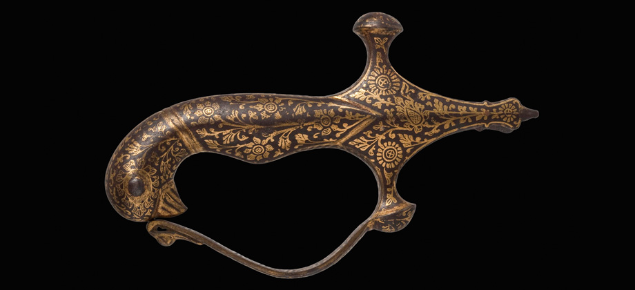

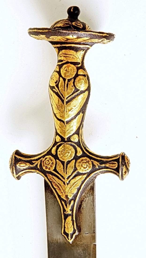

I have some sketches with flowers on...and pictures.
Old 29th October 2016, 08:57 AM   #4
Ibrahiim al Balooshi
Ibrahiim al Balooshi's Avatar
Posts: 4,408

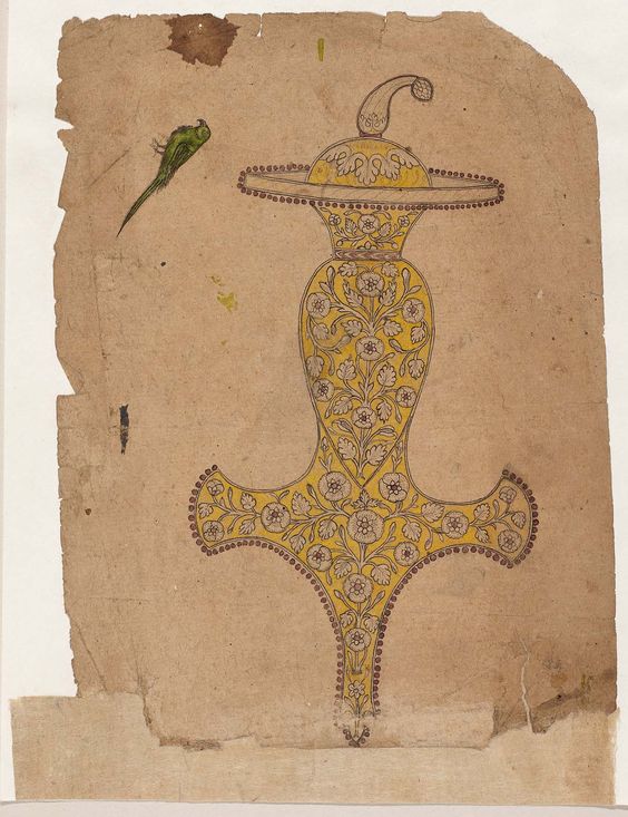

More...

Excellent images Ibrahiim! Thank you.
As I look at these, I can visualize the many incredible hilts of the swords in Jens' collection as shown in his magnificent new catalog.
As Jens has asked for us to join in his long standing research on the floral imagery on tulwar hilts, I wanted to add some material I had found on Mughal hilt decoration.

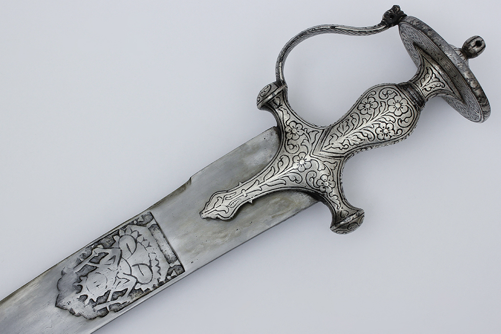

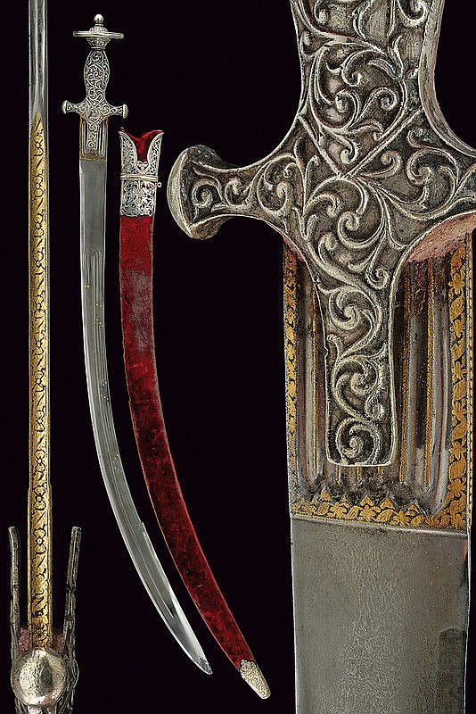

Ibrahiim,
The drawings/hilts you are showing are very interesting.
The dravings were often used by goldsmiths to show to customers, so they could choose a decoration for their hilt.
Illustration no 7, have a look at the middle hilt and compare it to the one I show in the catalogue pp. 303-306. These two hilts must have been made at the same workshop. Ibrahiim do you have a better picture of this hilt?
Jens

I dont have your catalogue reference so I dont know... I take it you mean the #4 sketch?... I am in the UK in a few days and will try to get your catalogue. ...

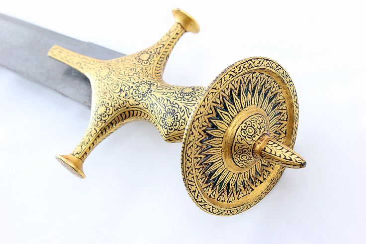

Ibrahiim,
I mean the hilt looking like the attached.

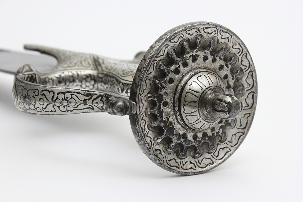

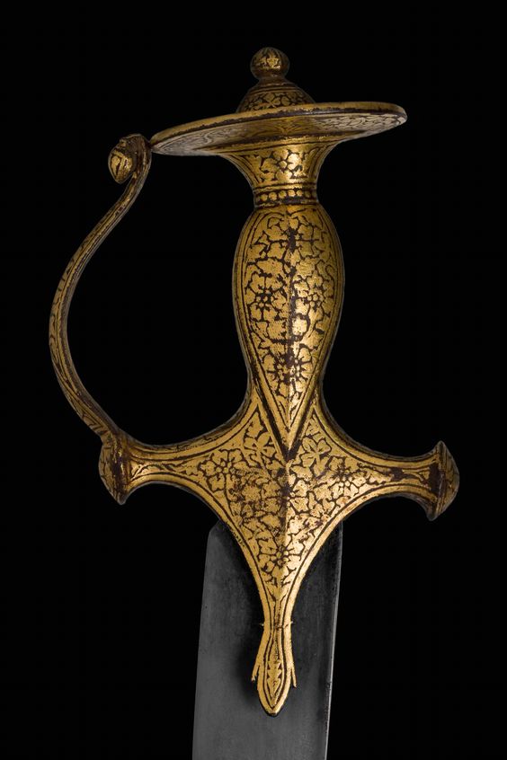

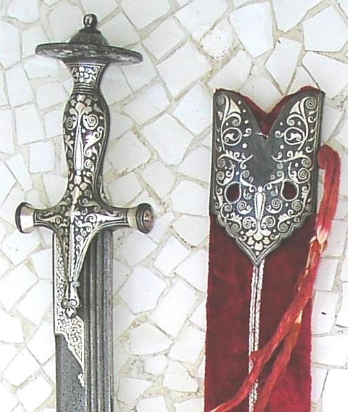

Salaams, It is amazing that I have posted one so like yours except mine has a Knuckleguard... I will search to see if there is a better picture meanwhile a few more ...This Tegha has a Tulvar hilt and interesting floral decor whilst on a black background; a Tulvar hilt covered in Script except for a single small flower between the Guard.
The name Tul(var) means flower...and the Afghanistan version is Pul(ouar) . Does this refer to the abundance of floral decoration or give rise to it? On the other hand may the design of the flower shaped pommel have any relation to the hilt/sword name?
Ibrahiim al Balooshi.

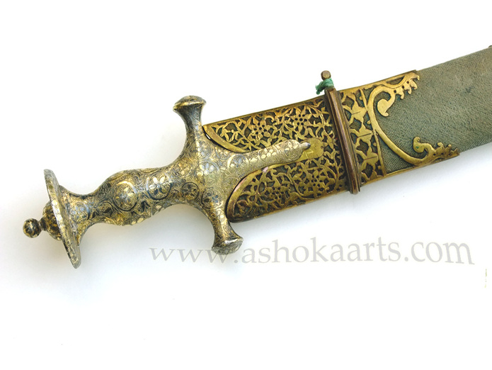

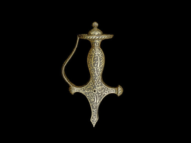

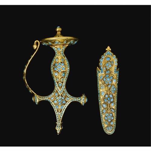

Some more...The black background from the Caravanna Collection:
Quote"17th Century
Western India - Gujarat, Mughal period (1526-1858)
Steel, gold
Height 18 cm
Tulwar hilt dated to the 17th century, shaped as a bird dated from the 17th century with a hand guard forming the profile of a swan. The entire surface is covered with floral motifs, engraved and inlayed in gold, in the koftgari technique.
Bibl.: Jawaant, 2005, p. 83; Nath Pant, 1978, vol. 3, est. CXX." Unquote.
I note that the swan neck finial of the knuckleguard is almost exactly that of the Afghanistan swan neck...

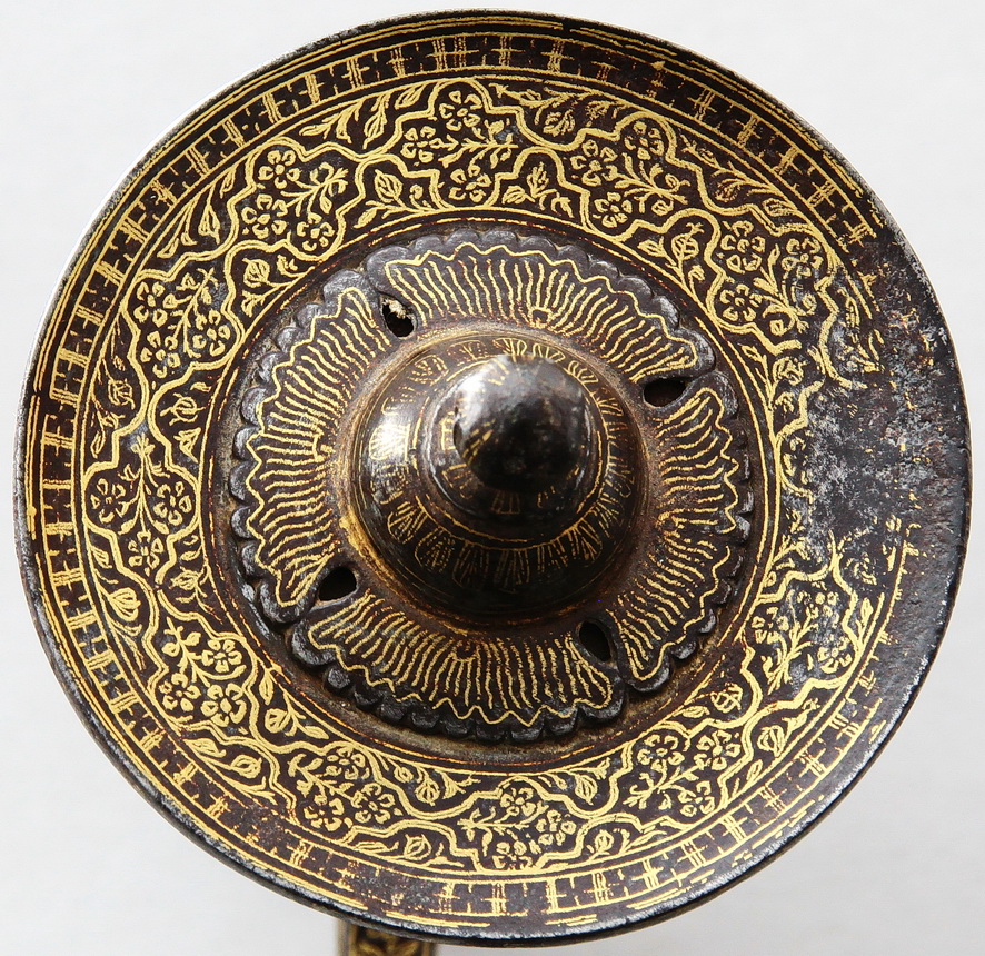

Yes the decoration of the hilts is interesting, and varies from place to place and from time to time according to fashion.
However, what I was thinking of was the flower on top of the disc. Either it is a flower or a sun, or missing all together. I think this is a better pointer than the floral decoration of the hilt.

Sorry Richard, I overlooked you mail at first.
Having the head filled with flowers - the right side with roses, and the left side with tulips - I am sure Ariel will understand my stress:-).
You you are right, we did discuss the flowers on top of the disc, but although I find this very interesting, and research should be done, someone else must do it, as I have only one head and two hands, and I have started to research some katar types, which I have wanted to research for a long time. The research is slow, as not much is found about them, and the informations to have, seems to differe quite a bit of for how long time this katar group was used.

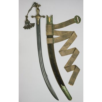

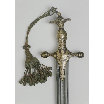

Here is an interesting sword! Of particular interest is the floral decoration which may be relevant to the thread..
Do these floral designs have a Talismanic/ secret meaning?
Please see http://collections.vam.ac.uk/item/O1...-shikoh-sword/
Quote"The very fine watered steel blade of this sword is inscribed on the back of the blade with a Persian inscription inlaid in gold stating that it belonged to the Mughal prince Dara Shokuh (1615-1659), the son and preferred successor of the emperor Shah Jahan (r. 1628-1658). The verses may be translated as: 'This sword (tigh) of the princed called Dara Shokuh/Takes care of a thousand enemies at one go'. When Shah Jahan fell ill in 1658, another son, Aurangzeb, usurped the throne, had Dara Shokuh killed during a fierce war of succession and declared himself emperor with the title 'Alamgir.
The blade is also inlaid on one side with a gold parasol signifying its royal ownership. The sword must have been made in a court workshop, perhaps in Lahore which was a traditional centre of weapons production. A date is stamped on one side of the blade near a forte. The third digit is indistinct, but is probably '5', making the date 1050 AH, or 1640-41".Unquote.

This is really an interesting topic, and as Jens has asked, to research more on the flowers on tulwar hilts. Naturally, the floral designs extend to daggers and sheaths as well.
As I noted in my earlier posts, an interesting article is by Stephan Markel, "Use of Flora and Fauna Imagery in Mughal Decorative Arts" ('Marg', Vol.50, #3, Mar. 1999, pp.25-35).
He notes; "...throughout the Mughal period there were several basic uses of flora and fauna imagery in the decorative arts. First and foremost was adornment for both solely decorative and/or dynastic identifying purposes.
Along with jewellery, dagger and sword hilts, sheath and scabbards were the most prolific court object to be accented with floral imagery". (p.27)
Also noted is that by the end of the Mughal period in the mid 19th c. the dynastic emblem of flowering plants had paled into a repetitive motif less aesthetic than the elegant flowers of the 17th c.
It seems there are considerable 'floral lore' assessments of the symbolism of certain flowers in various religions, which vary in degree but in religions such as Hinduism and Buddhism, the seems one of the most significant.
In Islam, there is a great deal of aesthetic attention to arrangement of floral and botanicals as the focus on replicating the Gardens of Paradise and their beauty is a key theme. Meanwhile, it does seem that the use of codified representations of certain flowers were dynastic representations.
It would be interesting to discover more on which flowers were indicative of which dynasty and how they were portrayed in various regions or periods.
There is mention of 'Mughalization' of Hindu forms of flower in some cases.
It seems less likely for talismanic application in most cases, as most of what is described seems to refer to aesthetic floral themes in favored arrangements and certain codification probably aligned with dynastic favor of those themes.
In the case of the interior of the pommel discs, it seems these motif may be themed after certain solar or celestial subjects, but can be floral as well.
I am curious if these follow the theme of the hilt or can differ.

Ibrahiim, thank you for the detailed information and excerpts on the possible talismanic aspects of the decoration on these weapons. It really gives us a lot to consider!
While much of what we are looking into involves the Mughal decoration of tulwar hilts, clearly the links to Hindu imagery play an important part in the development of many of these motifs.
I think the capture and execution of Dara Shikoh was more a result of the typical power struggle between the heirs for control from the standing emperor than differences in idealogy. The fact that Dara Shikoh was quite liberal compared to his younger brother Jahangir and as noted, was deeply involved in mysticism was however a notable circumstance. Elgood explains (p.135, "Hindu Arms & Ritual", 2004) that with the forces under these rulers, "...the ideological battle between Islam and Hinduism had limited relevance as mercenaries served either side".
In his book, Elgood explains also that flowers and plants indeed had both certain talismanic as well as dynastic significance in the early Hindu kingdoms and of course Faith. He states (p.129) that "...it follows that a plant depicted on a weapon is likely to represent more than its decorative value"
Further, that there were nine species of plant associated with the warrior goddess Durga, and the "...red flower is used for good and evil for charms and incantations on the one hand, and for witchcraft and spells on the other".
The exposure with European contact certainly rang true with respect to the various volumes of botanical lore and art known as herbals, as "...the Indians, like the Victorians (much later) had a very precise language of trees and plants and though there are regional differences, plants had a pan Indian value" (p.129).
Also noted is the sweet basil plant called tulsi (ocimum sanctum) associated with Vishnu, and referred to as 'bhutagni' (=killer of demons). Evil spirits including the god of death, Yama, are driven away by this plant, and its leaves often worn in the turban by Rajput and other warriors (p.144).
